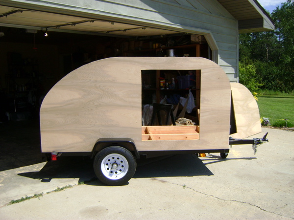

Well, I took your advice JohnnyD and took things real slow...so slow as a matter of fact that I've only been able to work on the trailer twice since my last post! Did a lot of thinking and puzzling tho. :) My business during the summer takes up a lot of energy and time. But I did manage to corrall No. 1 and No. 3 Sons' help at the end of July to get the second side cut and drill holes in the trailer. Gotta agree with No. 1 Son, the jig saw is not my friend. My next build :lol: I'm going to have to find a better way to cut curves. There'll also be a little work getting the doors to have nice straight edges.

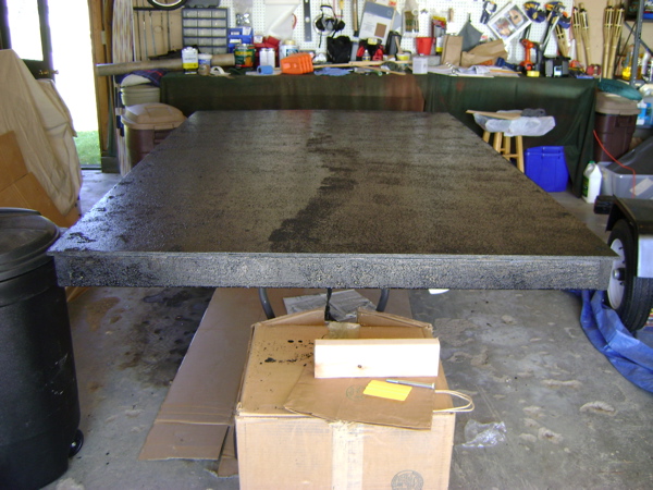

Floor has Herculiner on the bottom and front.
Cut most of the spars yesterday. Had to make a trip to Menard's as I cut a couple of them too short...getting used to the compound miter saw, you know. (BTW, saw some lovely green/blue/grey 6x6 porcelain tiles there on deep discount, so I'm rethinking the galley counter top. Somebody please talk me out of that).
Cut the 3/8" jog out of the back for the galley hatch. For sure, the jig saw and I aren't friends! :x The plans say to use that piece to make the hatch ribs. Well, mine came off in pieces. Belt sanded things smooth and will use kraft paper to trace the edge to use as a pattern.
I find that in order to do each next step, I need to think 5 steps ahead. (That's what I get for deviating from the plans.) For example, before I attach the walls to the floor/storage base, I need to not only CPES, but apply some coats of spar urethane. In order to determine the height and depth of the galley counter, I need to build the slide-out tray for the Camp Chef oven. But first I have to practice using the Kreg jig. Think I'll build a bird feeder.
Still pondering the gas line from tongue to galley...that's connected to the height/location of above oven. So...gotta build the slide out tray. Step at a time.
I'm hoping to get it so that I don't have both sides of the garage taken up with the build when the cold weather comes. Husband is a rural mail carrier and I know he's not down with parking his car outside here in Minnesota all winter long. :o
Step at a time. Just gonna keep plugging away.

Hi Lil: It looks like number 1 & 3 sons are both number ones. It is nice they helped you out. It looks like you are building a teardrop trailer, are you??? LOL Now you see what I mean by thinking several steps ahead before acting on it. I like the Benroy profile. I am still building my TD, and I plan something and before I know it, I change something and have to change something else. Just remember you will be sleeping in it and you are the only one that has to like it. That is all that matters. I am planning on building another one after this one. It will be a minimal cost one though. My first one will be one I will keep ahold of. I will be taking my time on #1 because I want it to be really nice. I hope you have a nice one too when you are finished.
Good luck at going sideways... :thumbsup:

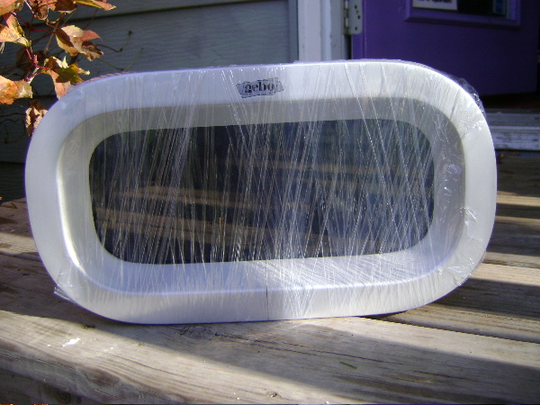

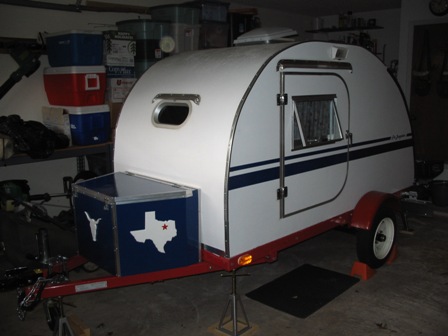

Got a package in the mail today. I'm excited that now I'll have a little window on the front of the teardrop. It's a marine grade window so, if I seal it properly to the vinyl roof, it should be watertight. I saw the same style/brand window on another build here (thought I saved it in my bookmarks, but alas not there, so I can't give credit), looked on ebay and this one seemed to be reasonably priced compared to others. It'll be nice to be able to look out the front of the teardrop...that is, when I'm done. 8)
Update: I found the build. It's loader's Bungalette.
Cute, huh?

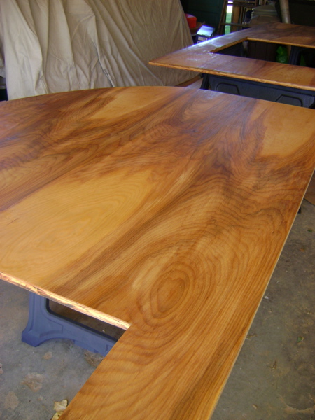

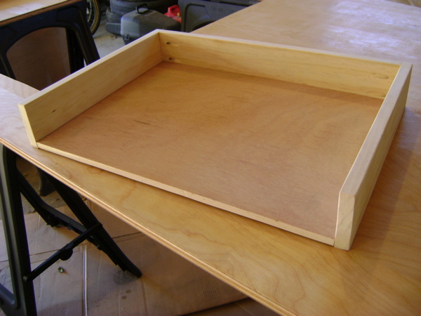

This morning's air was a little chilly as I headed out to the garage with my cuppa joe. I could hear shots in the distance. It's duck and goose season here in Minnesota. Plugged in and turned on the milk house heater in the garage to take the chill off. My plan...to put CPES on both sides of both walls. The instructions said it would take 16 hours at 50 deg. for the CPES to cure. Then I plan to start coating the walls with several coats of spar urethane.

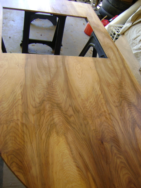

It turned into a beautiful, warm, sunny fall day. Got the walls coated with the epoxy sealer. And I lu-u-u-uv how it enhanced the grain on the natural birch plywood!
The second pic is a little more yellow than in real life, but you can get an idea of how pretty the patterning of the grain is.

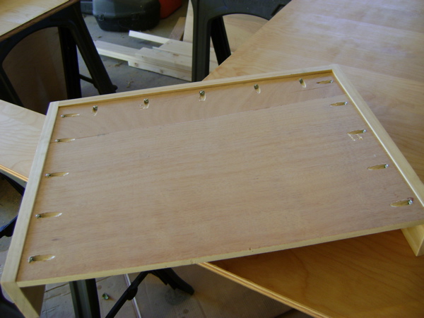

Then I decided to acquaint myself with my little Kreg jig since that's how I'd like to join the spars to the walls. Decided to use the jig to build a shelf for the Camp Chef Oven. It will eventually have drawer slides on the sides and be installed on the left side of the galley. Turned out pretty good for a first attempt I think.
Scanned through the instructions, but couldn't see any guidelines for spacing the screws, so I went all out on the bottom. Did I overdo it? Found I had to make sure the jig was FIRMLY clamped otherwise it would skitter. Put one of those rubbery mesh placemats between the wood and the table when I clamped to keep things from slipping around.

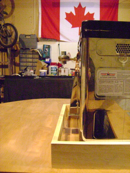

Here's the stove in place. Thought I allowed 1/4" side clearance total. It ended up pretty snug but not sticking. Looks OK. Gotta figure a way to stain the pine to match the birch. Might consider painting it, we'll see.
The Camp Chef's regulator screws into the back of the oven and sticks out quite a ways. I'm hoping there'll be a enough depth in the galley to leave it attached as it's a bit of a bother to screw it in each time. But, if I have to disconnect it after each camping trip, oh well. Not a big deal.
