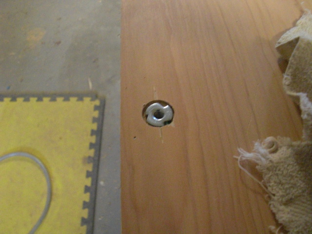

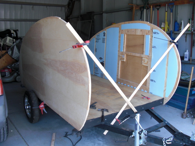

The build is going fast. I set the walls on the trailer to mark where the 1/4-20 T-nuts will go into the frame and then into the walls.
I put the T-nuts on the outside of the walls about 8 inches on center. Then when I put up the walls after putting on the aluminum skin I will put in bolts through the frame and into the wall, then cinch them in tight to the frame. And no bolts showing :twisted:
This photo was taken before I laminated the inner walls to the outer wall/frame panels this morning. I weighed one of the finished panels and it weighed 44 lbs. So about 1.49 lbs. per square foot. A little bit higher than expected(I was hoping for 1.00 to 1.25) but better than 3 lbs. per square foot if I used 1/4 inch ply.

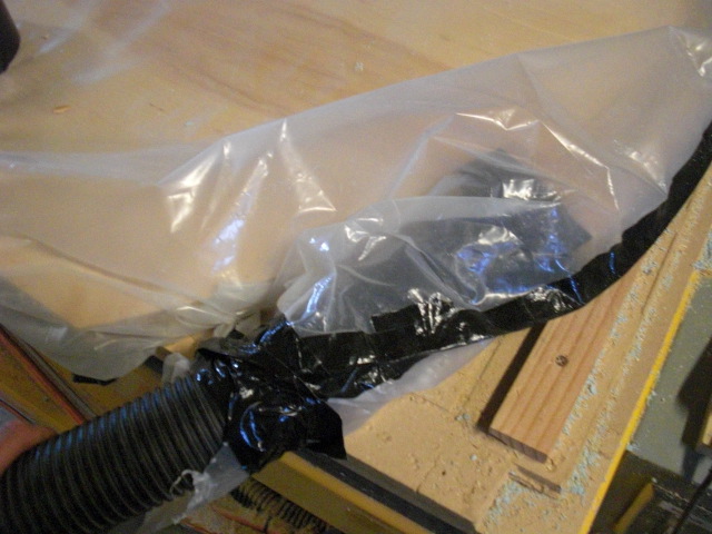

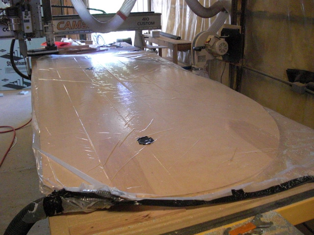

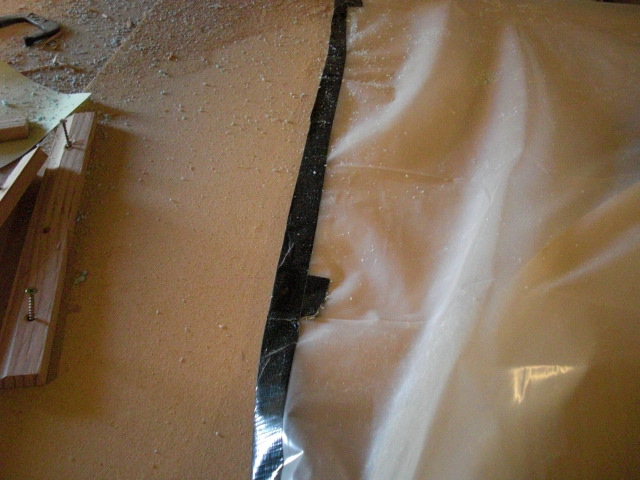

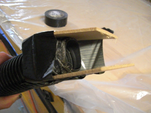

Guy I felt bad that I did not do any photo documentation for you and everyone here at the Teardrop forum on my vacuum bagging process. I have learned a lot from everyone else. So I put one of my walls back into the vacuum bag and took some photos. Also I got this idea from someone else here at the Teardrop forum.
I was going to use my vacuum compressor that I built to hold down parts on my CNC, but the compressor could not pull enough air out fast enough to make a good seal with the cheap plastic bag that I was using. So I got out my "el cheapo" shop vac, and every thing worked fine at that point.
This is what I used to pull the air out.
I got a piece of 4 mill plastic 10ft wide by 25ft and some black duct tape from my local B.O.R.G.(that's Big Orange Retail Giant) I cut a piece 10 ft by 10ft, then folded it over in half and put some duct tape on both ends of the now 5 ft sections. So basically I made a big 5 ft by 10ft plastic sandwich bag, with one open end along the 10 ft side.
Then I took the end of the shop vac hose and took 2 small pieces of plywood and duct taped them (No modern civilization can exist without duct tape) to the top and bottom of the shop vac hose. This prevented the plastic from plugging up the intake hose.
I put this duct tape marvel of cheap engineering into the corner of the plastic bag after I slipped in the wall panel and taped only around the shop vac hose.
I then tucked under the wall panel the open section of plastic. And turned on the shop vac.
I used some epoxy from Aero marine products http://www.jgreer.com/ because it gave me lots of time(1 hour plus) to get things in place, so I was not rushed in getting thing done before the glue set.
This set up will not pull the walls down so tight that it will squeeze out all the glue and have a glue starved panel, But I will give you a nice flat panel.

Postby GuyllFyre » Mon Jul 12, 2010 4:28 pm
Thanks for showing that! I was having difficulty finding on the forums. It looks simple enough.

Postby TD Beej » Mon Jul 12, 2010 10:58 pm
How long did you need to keep the shop vac running for the setting to occur and not have the wall come apart.

Postby R. W. Alexander » Tue Jul 13, 2010 8:32 am
TD Beej wrote:How long did you need to keep the shop vac running for the setting to occur and not have the wall come apart.
Thanks,
Beej
2 hours. But I will not move the panel for 24 hours.I have a interesting way of telling when the epoxy is firm enough to turn off the clamping pressure. When I mixed the epoxy for this glue up I did not throw away the mixing cup or stick. I left the mixing stick in the cup and checked on it periodically. When the epoxy had hardened to the stick I knew the epoxy glue had set in the wall section.

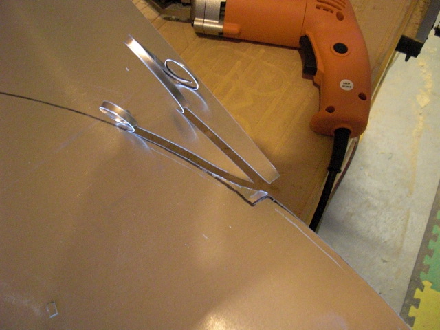

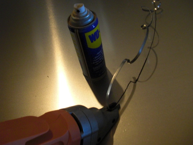

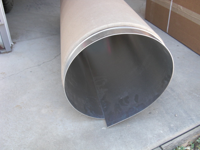

My Aluminum showed up this morning. I got 4 pcs. of .032 x 4 ft. x 10 ft. From a place called Metal by the Inch. I like the way they shipped it. It came in 2 boxes rolled up.
I set one of the plywood wall sections on top of the aluminum, and drew a outline with a fine point magic marker. I let the ink dry and put on a coat of W-D 40, which helps to make the metal cut easier.And keeps the cutting blades sharper longer.
[img]
This photo shows the way I made my notch cuts.
[img]
And the finished skin. It took me about 30 minutes to cut both pieces out.

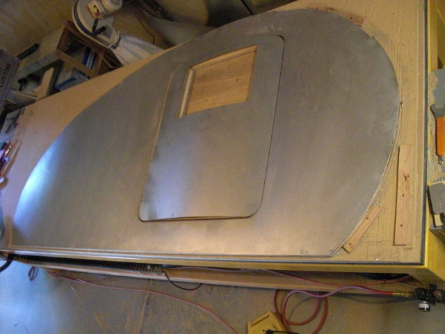

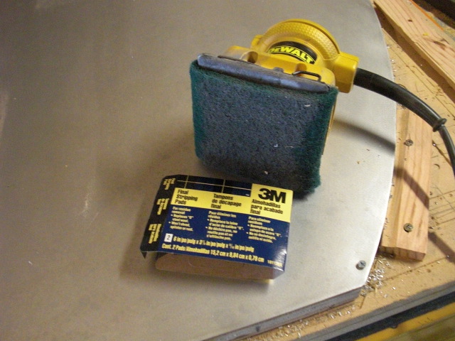

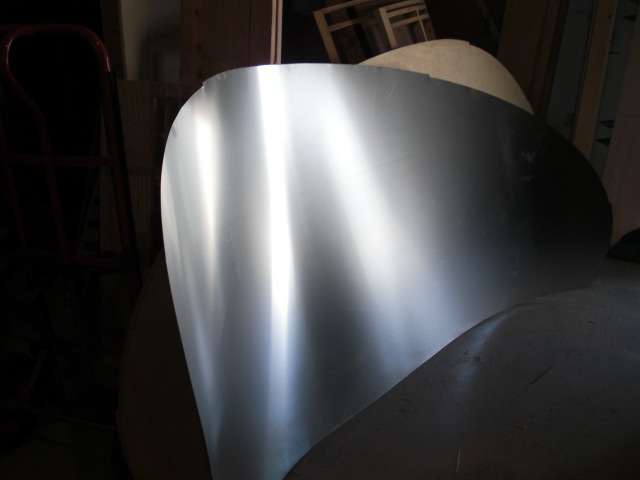

This part of the build was not fun. Aluminum being what it is scratches easily. I tried to be careful but I got a big dent in one panel and assorted long scratches in another. :x
So I tried graining the aluminum in the direction of the major scratchs, but that made it worse. So I flipped over both wall panels so I had new sides to work on l. And this morning I had time to think of a solution that would make the aluminum look better.
I know that eventually there will be lots of scratch marks on this Tear Drop...I can't do anything about that unless I put it in a glass display case.
So if you can't beat them join them.
I took my small palm sander and put on some 240 grit sandpaper and did a small circular pattern in the Aluminum. Then I put on a piece of 3-M green scotch brite pad, and went over the aluminum panel again doing a small circular pattern. My thinking is, when I get more scratches I can then blend them into the aluminum. I will put on some sort of clear metal protector after sanding all of the trailer. Time wise it was less than hour to do both panels.
This is a photo of the finished panel after getting the sanding done, and cutting out the door on the C.N.C.
This is a photo of my solution to my scratch problem.
