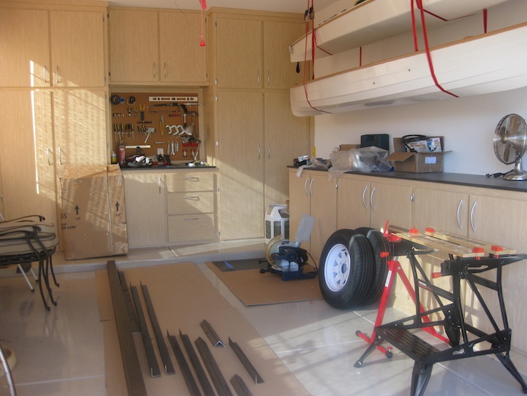

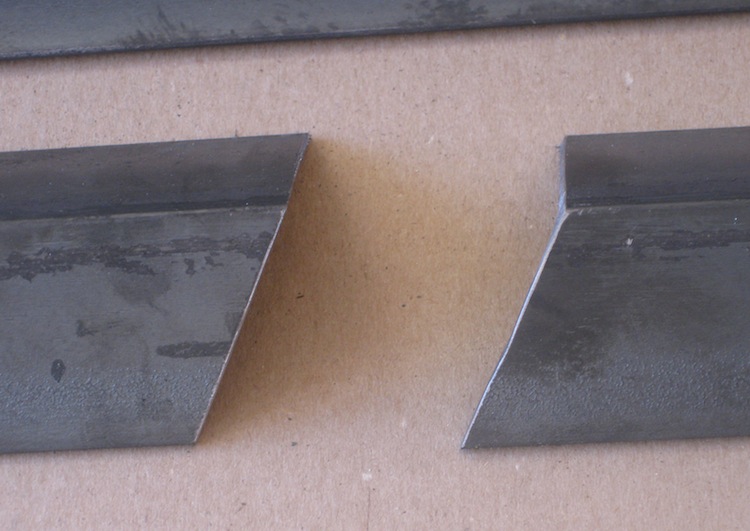

As I assemble a collection of tools and equipment and materials, our already small garage is getting even smaller. Due to our HOA rules, almost all the construction will have to take place inside this one-car garage.

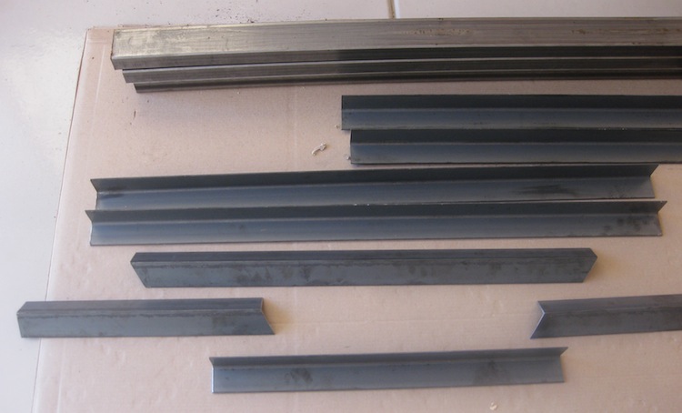

Although the chassis won't be assembled before December, I decided to cut the angle and box sections to length with square and bevel cuts where needed. I am doing this the old fashioned way manually with a hacksaw. All the angle section steel has now been cut.
By going slowly and carefully, I've been able to hold the tolerances to about 1/32-inch. Not bad for manual cutting, I'd say. Being retired, I have plenty of time to cut slowly. Being retired also means that my eyesight isn't too good, so squinting with my glasses off helped keep me on track.
These cuts are 25 degrees to allow attachment to the 50-degree tongue.

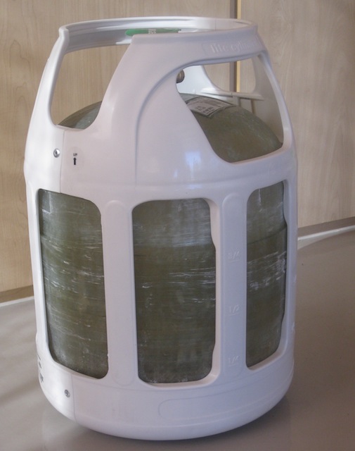

This last picture is the 20-lb fiberglass propane bottle that just arrived. It has a rubbery plastic framework around it and the whole thing is quite light. The best part is the ability to see the propane level thru the translucent fiberglass. Way cool.

I'm curious about that propane tank. Have you weighed it to see what the thing weighs empty? I think the 20 lbs is the weight of the propane that it will hold. I'd like to know what the combination of tank and propane would weigh. Thanks.

The propane tank can be seen at http://www.rvupgradestore.com/detail_66-4962__175.html. It weighs 12.8 pounds empty and can hold 19.2 according to the specs. Thus, the combination is 32 pounds.

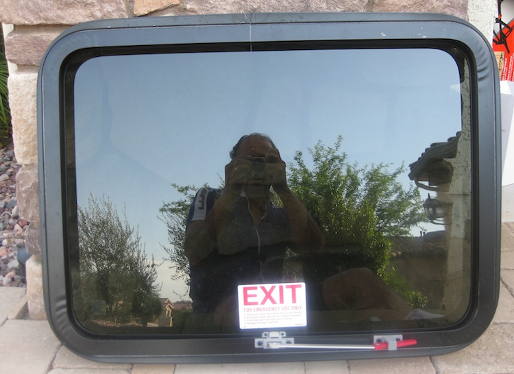

Postby myoung » Fri Oct 15, 2010 2:28 pm
Okay, I've resolved the windows issues with a set of 3 exit/escape windows to replace the crank-out models that didn't close properly. Must have be a manufacturing flaw.
Now I have 5 windows all from Callen Campers a.k.a. CustomRVWindows in El Cajon, CA. I drove over on Wednesday to return the old windows and get the replacement windows and get a new window that will be the skylight in the popup top.

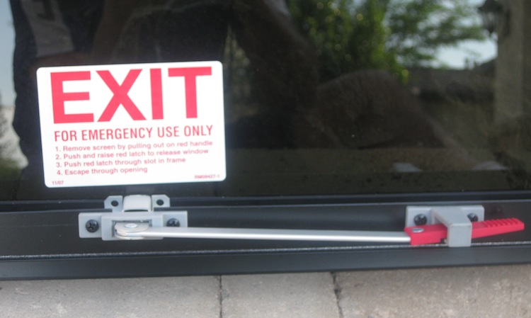

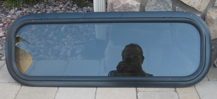

Here's the fixed-pane front window that will go above the galley on the slanted upper section. It is 30x10-inches nominal.

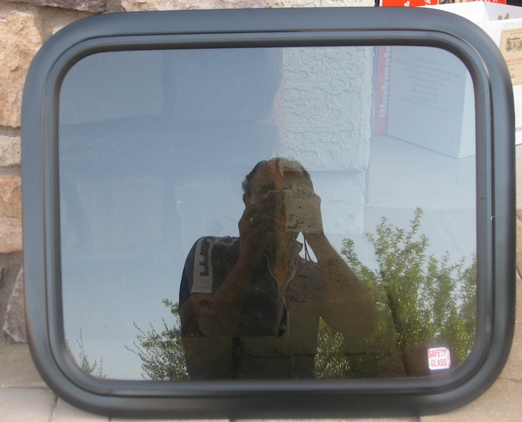

This is the 22x18-inch fixed-pane skylight for the popup top.

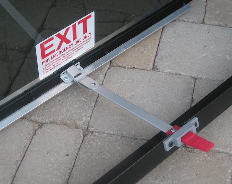

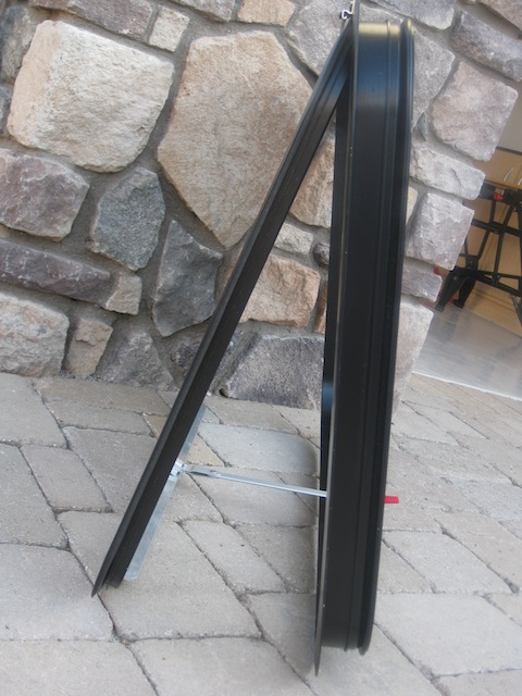

The three exit/escape windows at 30x22-inches will be installed on both sides and the rear.

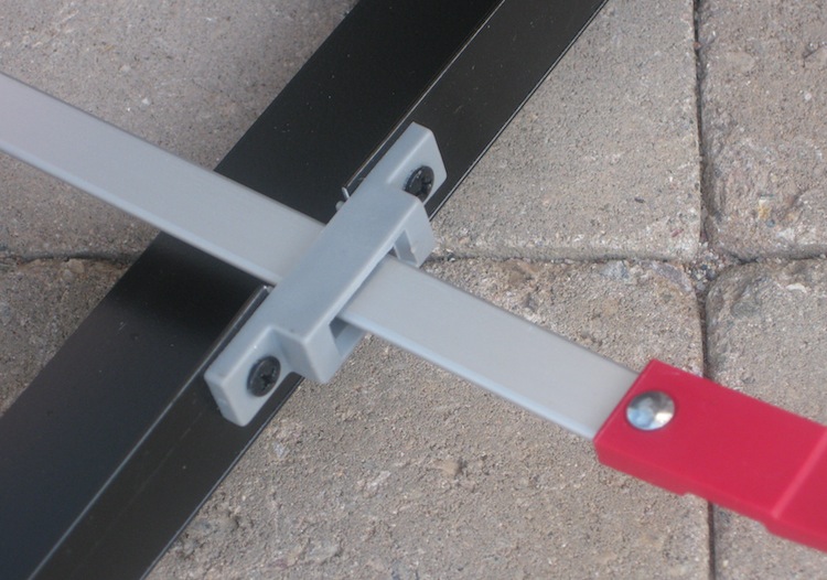

The opening mechanism is a simple pin-hinged bar that rotates into the locked position without protruding too much into the interior. There is a screen not shown in this photo.
In the fully open position, the bottom extends out about 8 inches, which should allow for more ventilation than the crank-out windows that only opened on the lower one-third. The trade-off, I suppose, is that the screen on the crank-out was that much smaller so visibility would be somewhat better on the crank-out than on the exit/escape windows with the screens installed. Perhaps, I'll leave the screens off when the flying creatures are not around.
As you can see, the opening is quite large.
To allow a range of openings, I'll add some means of adjusting the opening bar extended length. I can think of several ways of doing this. The simplest way might be to insert a small wooden wedge between the bar and the edge of the slot thru which a moves.
Mike what's going on in the left edge of this window? It looks broken, but I can see reflection in it?

Re: Windows issues resolved...
Postby myoung » Fri Oct 15, 2010 3:06 pm
Cliffmeister2000 wrote:Mike what's going on in the left edge of this window? It looks broken, but I can see reflection in it?
Yeah, that's funny. What you see is a reflection of a succulent and its wok-pot-shaped planter.

Postby Cliffmeister2000 » Fri Oct 15, 2010 3:14 pm
Oh, I see it now! :lol:
