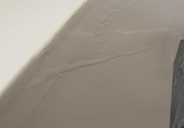

LesterS wrote:Just to demonstrate that "Ten Foot Rule" will really need to apply. Even one of the best looking seams still looks like this:
The flat seams really are the worst offenders.
