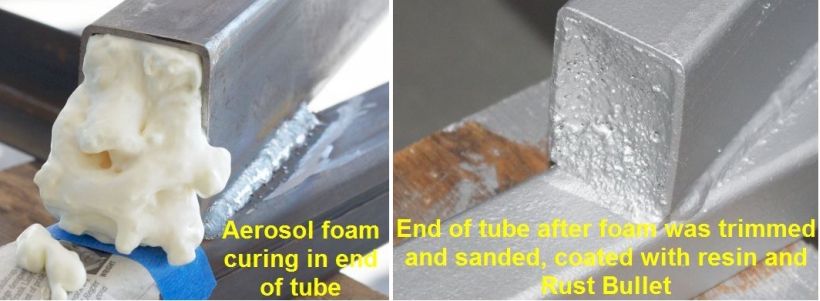

With only the tongue and coupler left to add, the gas appears to be holding out OK, so I went ahead and welded my spare tire mount together. I'll plug the bolt holes later or just spray aerosol foam inside the tube to seal it

In the past few days, I’ve made good progress on the chassis. The build WEB site has been updated with new detail and a few photos. The chassis is almost finished, lacking the installation of the axle, coupler, chains and jack stand. I tried the foam end caps with some success. After trying two ends, I tried a new approach, pushing a piece of solid foam inside the end of each tube, leaving less than an inch of depth. That used less foam and it all expanded outward. After curing and trimming, I coated the foam with epoxy, which caused the foam to cave inward only slightly. After the resin, the foam was unaffected by the Rust Bullet or spray paint. Results on a tongue tube end is below.

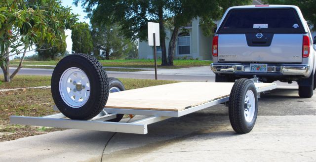

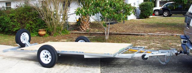

Postby cracker39 » Sat Jan 22, 2011 2:36 pm
I still have some caulking to do on the foam insulation beneath the floor and the hold down bolt holes to fill, but I rolled it out for a couple of photos. These below will also go on my build WEB pages.

Postby Steve_Cox » Sat Jan 22, 2011 3:37 pm
Hi Dale,
Really like that bumper/spare set up. Nice work. I welded flat stock on my teardrop frame open box ends that were on the tongue and rear bumper. You made easy work of that with your foam and epoxy technique, very nice.
Steve

Postby cracker39 » Sat Jan 22, 2011 4:00 pm
Steve_Cox wrote:Hi Dale,
Thanks Steve. I just decided to experiment with the foam after someone suggested it. You have to be patient and wait for the foam to cure all the way through before trimming it off flat. After I did the bumper ends, I cut pieces of solid foam to instert about an inch inside the other tube ends so that it took less foam to fill the openings. Once cut off with a hacksaw blade and sanded, there were a few bubbles in the foam and not all were perfectly flat, but the epoxy sealed them before painting them. All of the foam "caps" feel pretty solid now.
The spare mount comes off to work on the cabin. Four bolts hold it in place on the two pieces of angle iron welded between the bumper and the rear rail. I may order a vinyl cover for it later on.

Postby bdosborn » Sun Jan 23, 2011 7:53 pm
Dale,
Boy that's a good idea, I wish I'd know about it when I was making my floor.
