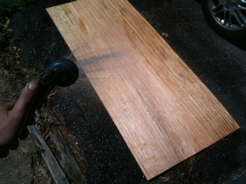

I had a hard time installing my interior ceiling too. I used 1/4" oak ply and I had to soak it with hot water to help bend it plus use my jack to help bend it in place. I then used wood glue and 1 1/4" wood screws with fender washers and screwed through it and into the spars. It worked pretty good that way.

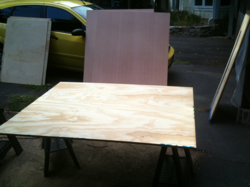

Postby kinto » Thu Aug 25, 2011 12:11 pm

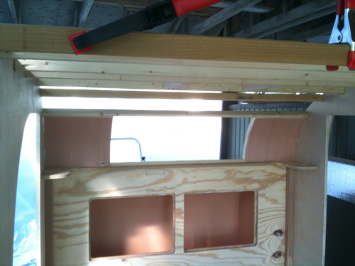

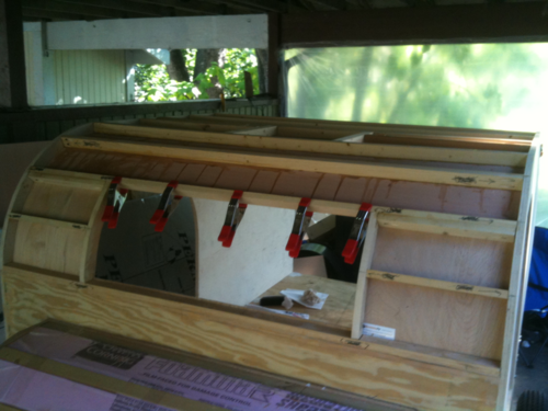

skinning, ack! those 2 little side window panels are the only ply i finished last nite... in the front box you can also see the interior paint color my girlfriend picked out... it looks a little salmon in this pic but it's really more of a sandy/ peach...
this is the thinnest (5mm) ply that the blue box store had (& what i've been struggling with...) sharon suggested kerfing with a box cutter & ruler so i'm gonna try that tonite & i also like larry's idea of using a jack to coax the ply into place... thanks to all for your advice & encouragement though :worship: :applause:

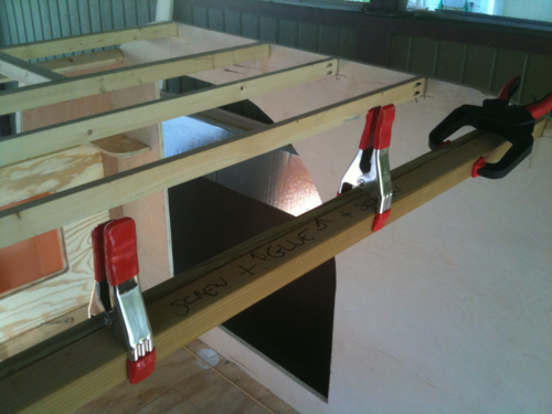

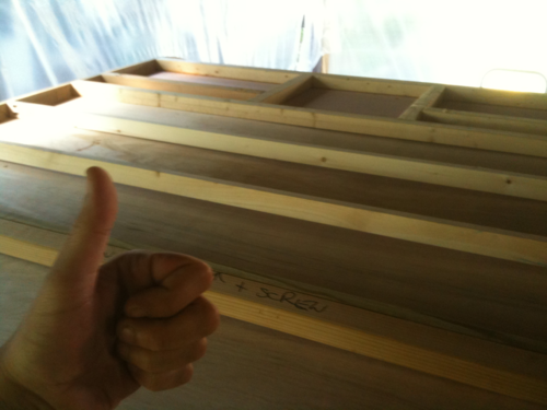

also got the last of the ceiling spars installed last nite & doubled up the rear one where the galley hinge will go...

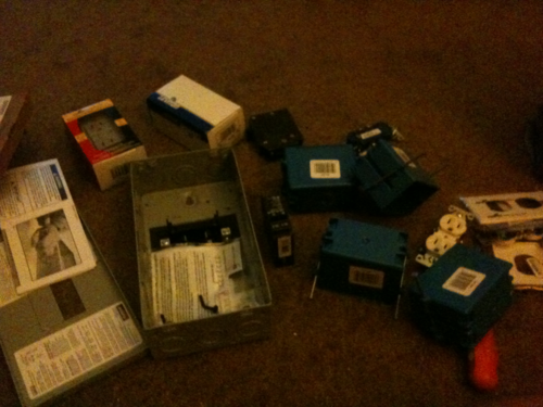

didn't get much done last nite. bought some electrical stuff thanks to standupguy's thread & advice. i'm not putting a big battery in the camper... just wiring it for regular old 110v ac... i figure if we're camping without an outlet we can always just use flashlights etc like we have been for years.

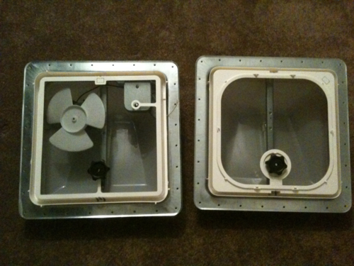

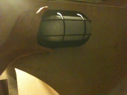

got 2 of these for about $20 to (potentially/ maybe?) use as outside/ "porch" lights. the only thing is i'm not sure where i'd put the switches since my walls are only 3/4" ply and i'd rather not have giant honking switch boxes stuck to the wall. any ideas for non-obstrusive, yet handy placement would be greatly appreciated.

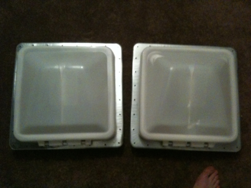

i bought the non-fan vent locally before i changed my strategery to electricalifization. the 110v fan one was ordered from rvplus.com, but they did a pretty awful job packing thus the plastic lid was mangled upon delivery so i swapped covers. it's not real evident in the pic as i tried to get it back in shape, but the one on the right is smushed up pretty good.

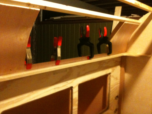

and the only other thing i got done was a little bit of trim...
the plywood skin is still being a huge hurdle so i'm probably gonna buy some cargo straps, more clamps(!) and a circular saw on the way home tonite to *hopefully* get a lot accomplished this weekend. what better excuse to acquire more tools, right? :twisted:

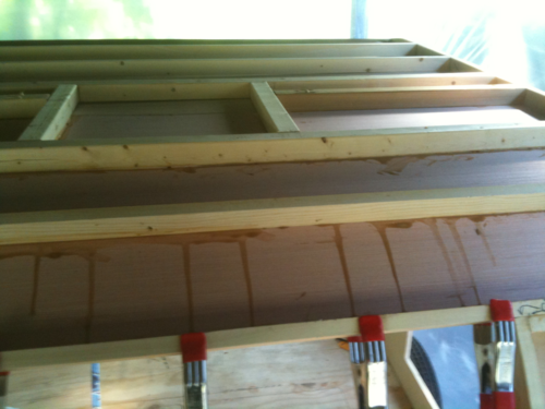

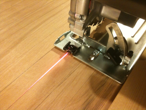

Postby kinto » Sat Aug 27, 2011 3:30 am
per budget and logic...
i'm gonna shoot lasers 1984 style!

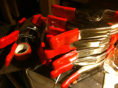

clean the local blue box of 2" clamps...
make this of that...
(i know!!! my kerfing is horrible!!!)

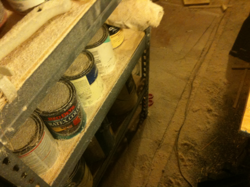

and not sweep my basement until it looks like black rock city!
happy weekend all!

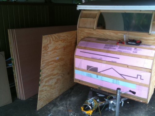

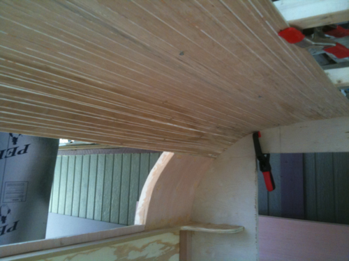

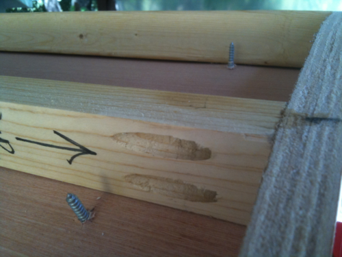

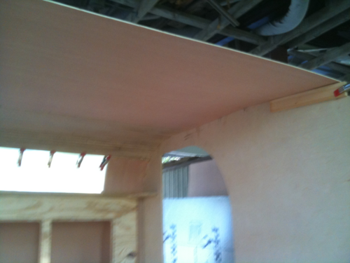

Postby kinto » Sun Aug 28, 2011 1:52 am
hose + kerf = great success!
tightest curve dry fitted...

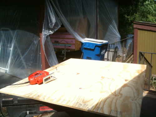

misfires! i'm an idiot! use a pencil!
other than that got much done today! woot!
i know the last few are boring/wtf but i got all the loud/ power tool/ major need-to-be-done-outside cuts fin today that the neighborhood might frown upon if i did loud/ power tool/ wtf/ major need-to-be-done-outside cuts on weeknights when i sometimes get home after dark.

Postby S. Heisley » Sun Aug 28, 2011 8:51 am
WOW! :o You got a bit carried away with the kerfing; but, if it worked and you're happy with it, that's all that matters. It's amazing that you were able to do that with just a jigsaw.
You're moving along quickly. It'll be fun to see what's next! :thumbsup: :applause:
Posts: 8775
Postby kinto » Sun Aug 28, 2011 11:45 pm
@sharon... thanks! yeah, as we discussed i'm new to kerfing... i may've gone a little crazy but did get the tight inner curve glued & screwed tonite so i'm definitely happy with it. plus the end result will be painted so all the kerfs will be filled/ siliconed etc. oh also, it wasn't done with a jigsaw... i ended up buying a circular saw & did the cuts with that. more tools. woohoo!
also got the inner back ceiling piece dry fitted tonite & shot a few pics but they're too dark/ fuzzy to post. will try in the morning before work if i get a chance.

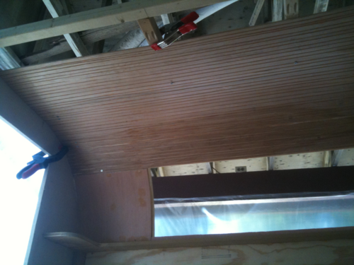

Postby kinto » Mon Aug 29, 2011 10:25 am
happy monday, happy campers!

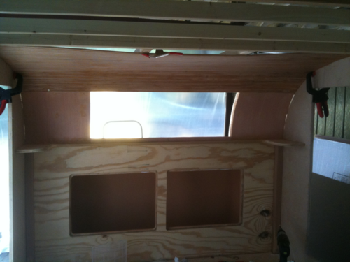

inside ceiling... front part glued, back part dry fitted...
