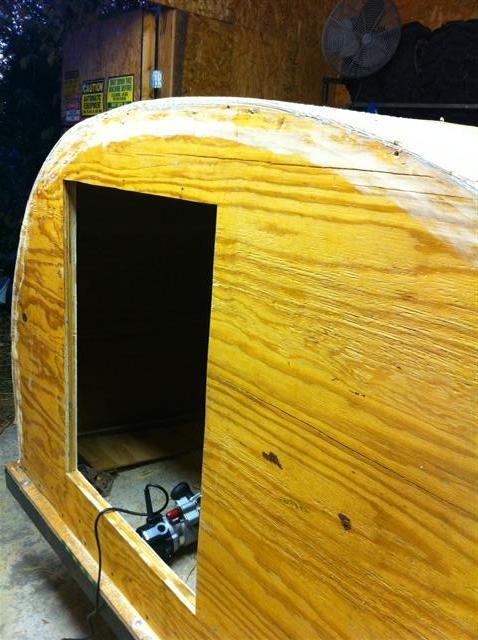

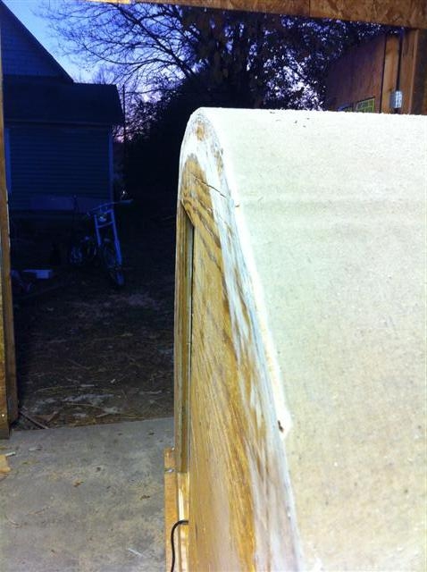

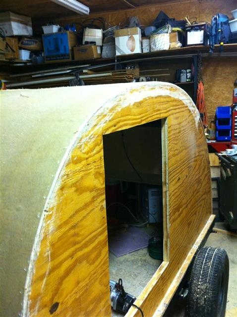

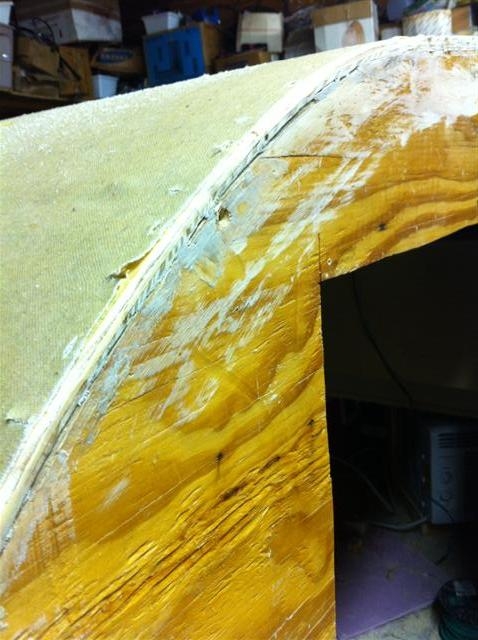

I have done a few things during this time, some I have a couple of pictures of and some I don't. The canvas that was already applied on the project top when I got it wasn't really done the way I thought it should have been. For one, the roof wasn't filled and smoothed the way it should have been leaving some noticiable screw heads that can been seen through the canvas and a couple that can be felt. Also, there are a few places that the canvas bubbled up a little where it didn't adhear to the ply. It was put on with spar varnish. both glued and covered with it. I would welcome any and all advise as to how I should proceed from here. There were staples all along the top edge where he held the canvas in place while covering it with varnish. there was also a open seem in places along the top edge where the roof ply met the side. I filled the seam with F21 construction adhesive. In my experence its about the strongest out there. Much better than liquid nails and it is completely waterproof. I then pulled all the staples and used a router to trim and then round over the top ply even with the side. It is now a smooth transition from the top to the side. I was planning on just putting the canvas on the sides and then adding another layer of canvas over the top that would overlap the side a little and then be covered with trim. What I could use some advise on is wether I should just sand the canvas already on just to smooth it out before putting the top layer over it even if that means sanding through the existing layer in the places where it is bubbled or should I try to remove the top canvas and fill and then start new? I'm not 100% sure the existing canvas will come off easily or not. I suspect in places it will and in places it will not. Any susgestions?
Here are what the sides look like after I cleaned them up with the router and a little sanding.
You can see that the canvas can be pulled loose at least on the edge anyway.

I hit the canvas on the top edge a little with my belt sander and it cut through it pretty easy. I think it would cut through the bubbled canvas petty easy but like you said, I think it would need to be taken back down to the ply and smoothed correctly to really look the way it should. I'm leaning toward that. Anyone have any susgestions on what is the best thing to use to smooth the ply before reapplying the canvas? I like the retro look of the canvas and was planning on adding some fabric accents down over the top of the canvas in places. I was planning on glassing a strip over the top edge but I have had a couple of people that have used canvas and said that going over the top and down the side a couple inches will do the same thing. The existing canvas does seem to be very water proof. It is getting trim on the top edge going over the side as well. I guess if it worked for canoes it should work here. It will be living under the carport while not camping.

I'd try a coarse belt in the belt sander and remove as much of the old canvas as possible. Would be worth the peace of mind in the long run knowing that you glued the new canvas down to something solid.
I used cheap ply on my build. Took a lot of Durham's rock hard water putty to fill the screw heads, knots, etc, but it turned out good.
