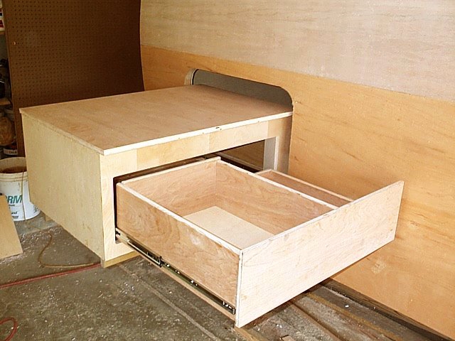

Postby mikeschn » Wed Dec 28, 2011 3:16 pm
parnold wrote:How about a table that folds down on the bed side for just those times. Of course it would add a little more work on the table, but would solve that problem.
I have to admit, being single for the last 8 years or so, I have (happily) forgotten to include someone else in my thoughts. lol.. Thanks for the tips.
Have you seen Carter's Big Drop. He does something similar.
Postby parnold » Wed Dec 28, 2011 3:24 pm
I like that idea, I'll have to measure the curves and depth and see if I can fit that type of drawer in mine!

Postby myoung » Wed Dec 28, 2011 3:44 pm
No cast iron pots and things in that cantilevered drawer, however.

Postby mikeschn » Wed Dec 28, 2011 4:27 pm
Looking at your sketchup sketch, I would just plan on a silverware drawer there. Plenty big for that.
Postby StPatron » Wed Dec 28, 2011 4:56 pm
(stove has been removed, it was located in the center section)
Dove-tail oak sliders and a fold-down leg were used for support. Plenty strong for all the galley equipment, stove, etc.
