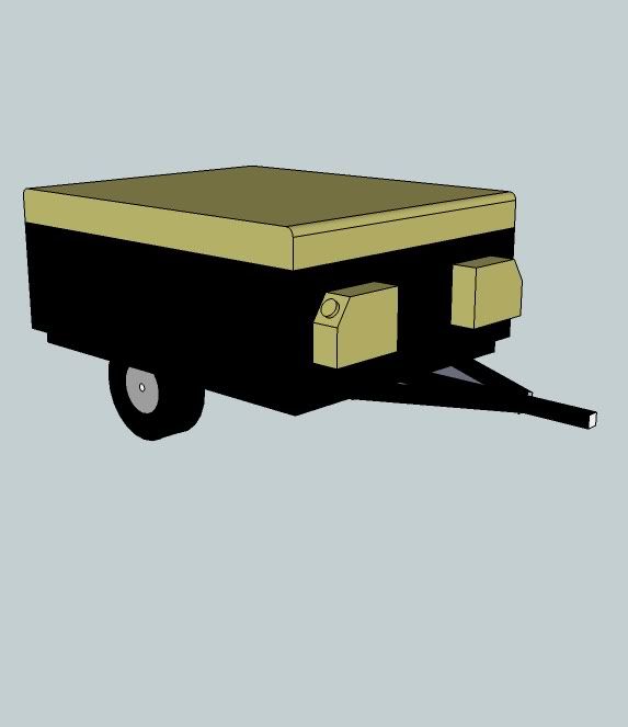

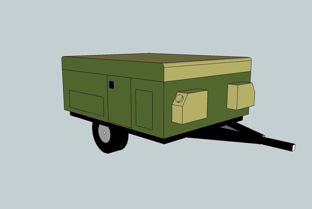

While I was on the boat I was able to buff up some of my sketchup drawings. Here's one with the beds and cabinets
Then there's the debate: green or black? I'm leaning toward black.
