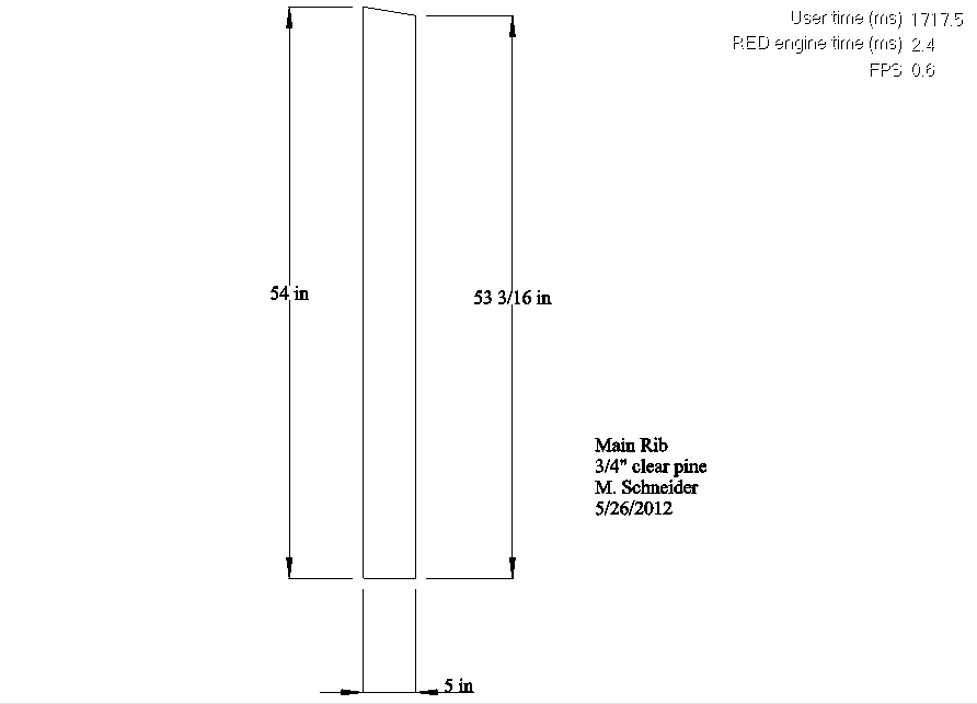

This is the last piece for today. This is the main rib. It attaches to the sidewall, behind the door. The inside wall butts up against it. The main spar that holds the hinge is also attached to this rib. I'll have more pictures of this main rib maybe tomorrow.

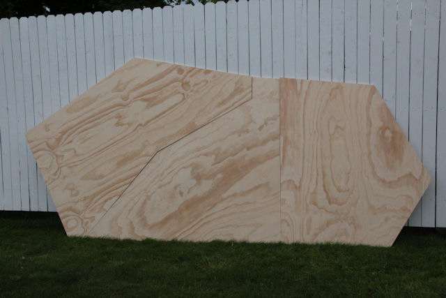

And here's how the pieces look, setting up along the fence!!!

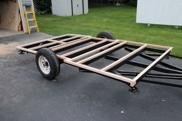

I didn't seem to make as much progress today. I got the subfloor done. It threatened rain halfway through, so I had to put everything away. But it didn't rain. So I dug everything out again.
Here's the subfloor.

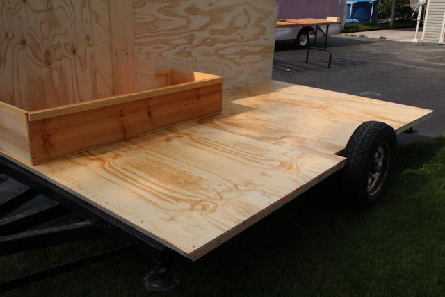

Then I started on the plywood for the floor. I was just starting the angled cut for the front, and the rain drops started. So I put everything away again, and no more progress today. Hopefully we have fewer distractions tomorrow!

Postby mikeschn » Mon May 28, 2012 4:30 pm
Yep Shaun,
No dropped floor on this one. The Hatch goes high enough that I don't need a one.
Anyways, got the floor on today... I had one bench from the last build, so I set it in place to see if the inside is tall enough. Seems to be. But I'll stick a mattress in there and double check.

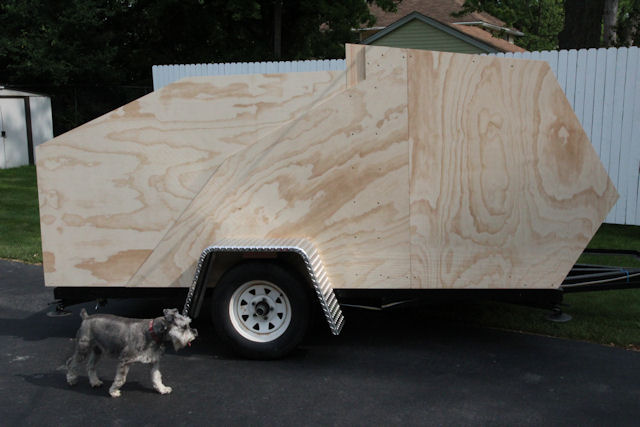

Then we assembled a wall, and hung it in place to see how it looks...
I like it! How about you guys? (The fender needs a little bit of work yet.)

It's looking good Mike. :applause: Keep it up and it could be campable by the 23rd. :twisted:
I think that the fenders look good with the off road look of the trailer.
