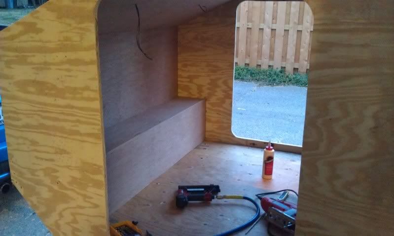

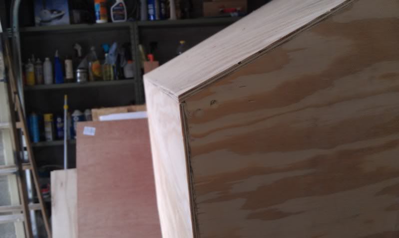

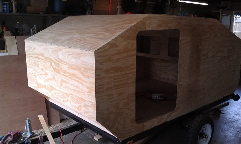

A little more progress yesterday. Had friends over this weekend, so not much progress since last weekend....it was just too damned hot outside anyway! :shock:

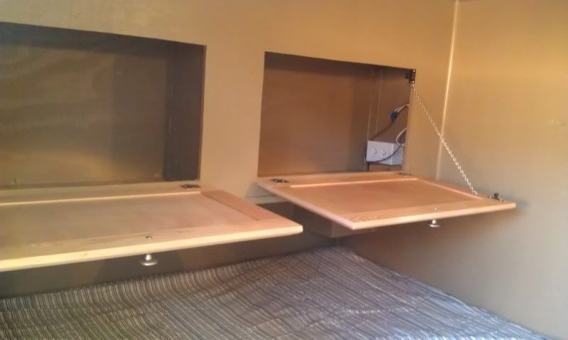

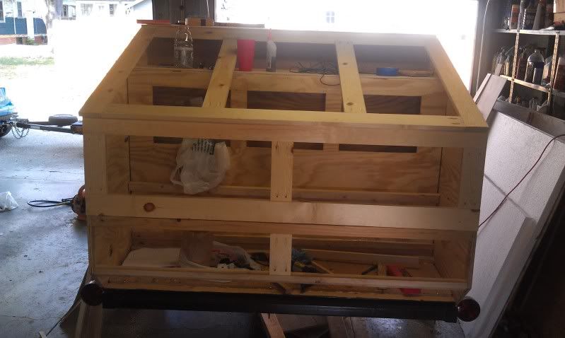

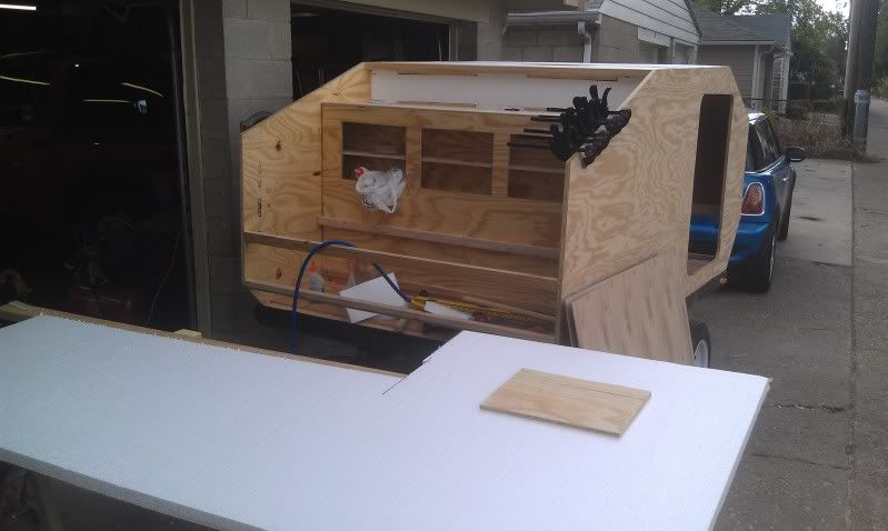

The cabinets are mostly done (just plywood). The doors are store-bought cheap oak panel kitchen cabinet doors and will just be mounted to the plywood faces of the cabinets.
More to come...

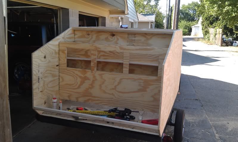

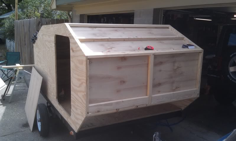

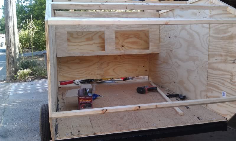

More progress today. Started out by heading over to home depot for supplies..

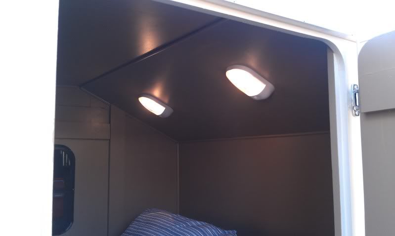

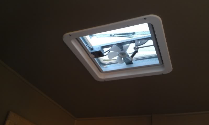

Worked most of the day installing the interior skin, insulating, and wiring for a few lights and a vent fan. Finally decided to make my own doors, so the holes are now cut out. Tomorrow I will work on the outer skin.

Another busy day in the garage. The outer skin is mostly done now and the galley hatches are framed and skinned.
I have two new favorite tools now...the belt sander and my new kreg pocket hole jig. How have I survived this long in life without them! :)

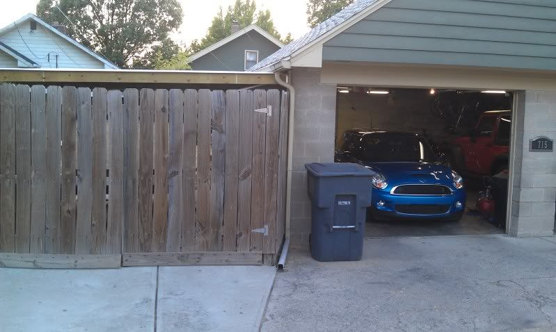

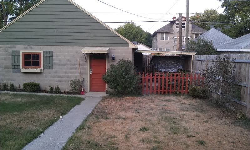

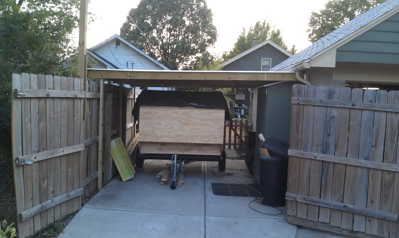

After nearly a month of the trailer hogging my side of the garage and parking my MINI on the parking pad next to the garage....having to get out and unlock it each morning and lock it back up at night.....I had enough. The trailer is nowhere near ready to weather outside without protection at this point. So today I built a 10 x 14 carport over the parking pad to serve as a permanent place for the trailer...
The MINI tucked in to bed where it belongs!
From the other side of the garage...
Hopefully back to work on the camper later this week. I need to order some parts....windows and some hardware.

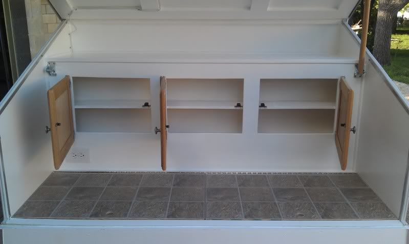

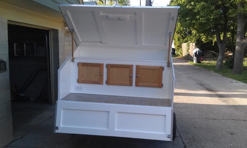

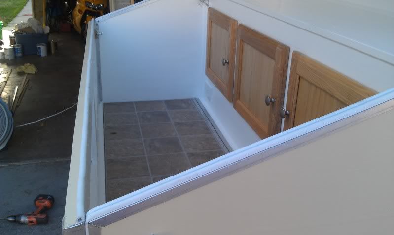

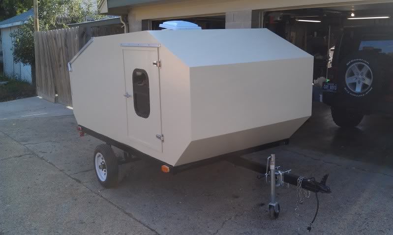

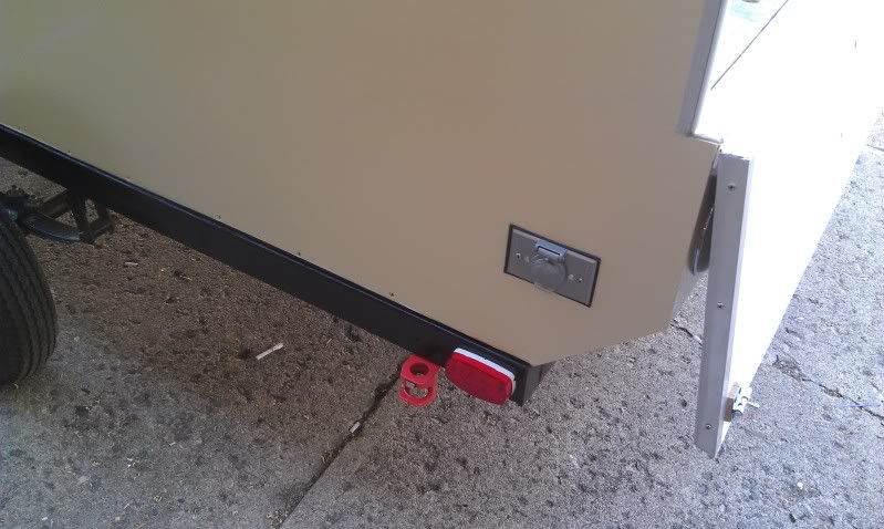

UPDATE!!: 5ft Weekender build in Indianapolis
Postby IndyCubby » Sun Aug 19, 2012 6:41 pm

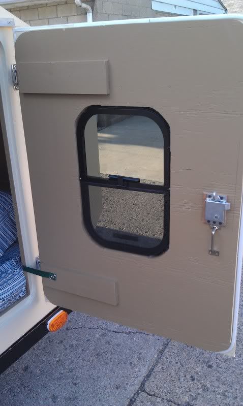

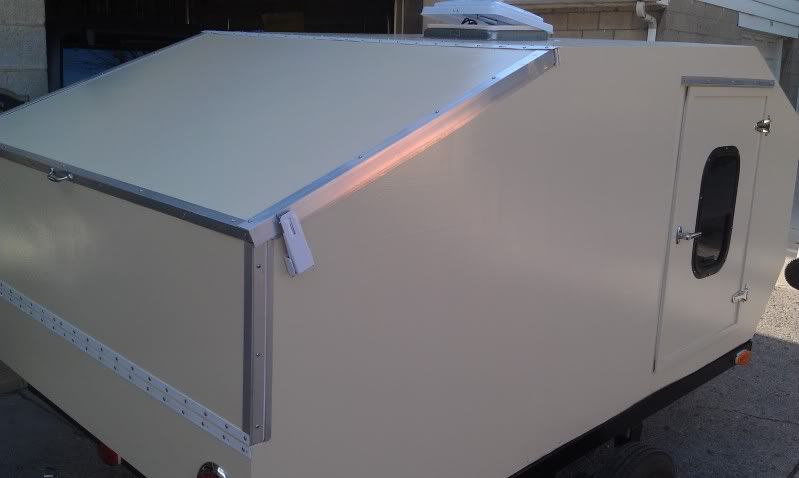

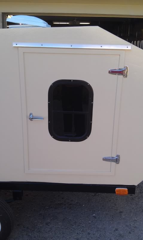

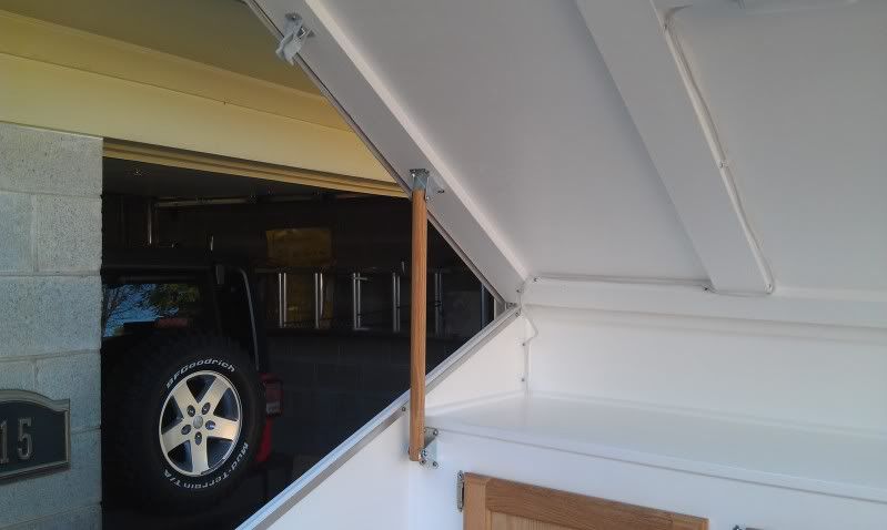

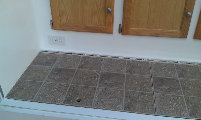

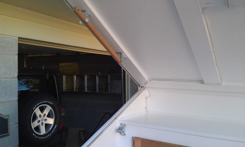

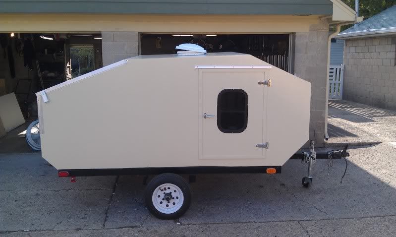

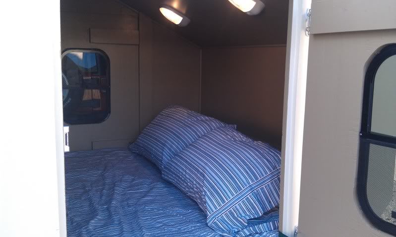

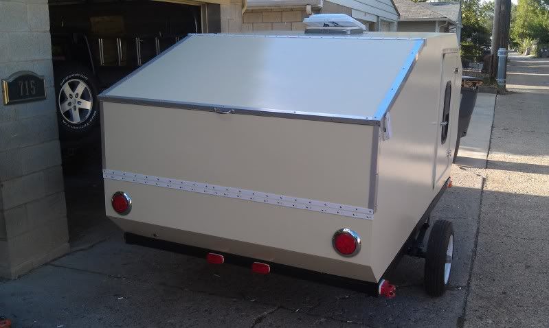

Well it's been a long time since my last update. My goal was to "finish" the Weekender by the end of the summer (I'm a teacher and wanted to get it done before going back to school). Well, school starts tomorrow and as of today, the camper is "camp-able". Still need to do several things....need to trim out the bottom of the body where it meets the frame (probably with thin aluminum bar), need some shelving in the interior cabinets, and need to add a tongue box of some sort (for storage....and to add some weight to the tongue!).

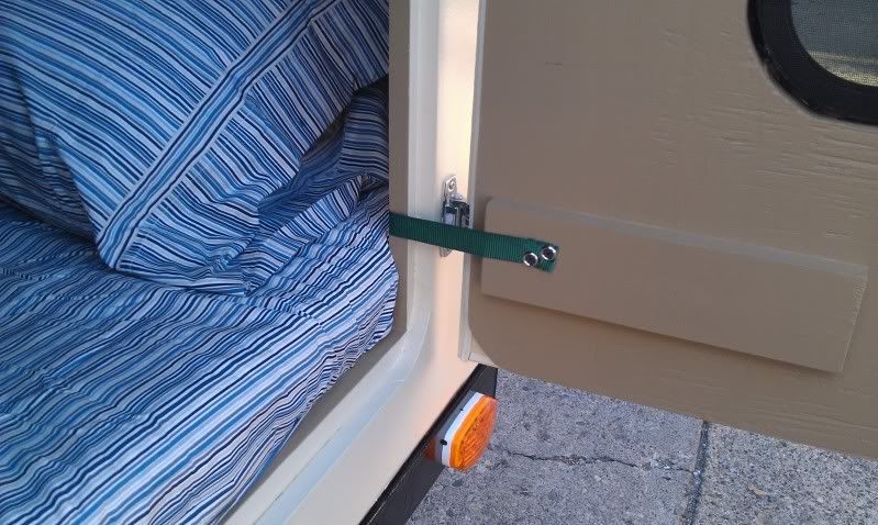

The outside of the camper was sealed with three coats of thinned polyurethane, sanded, filled, sanded some more, and then painted with two coats of primer and two coats of Rustoleum oil gloss in Almond. The worst part of the build was the doors....I originally set out to buy premade ones, but then decided I didn't want to spend the money on them. They turned out pretty decent in the end.
Here she is....
Thanks to Mike for posting the Weekend plans and to everyone whose ideas I "stole". :D
