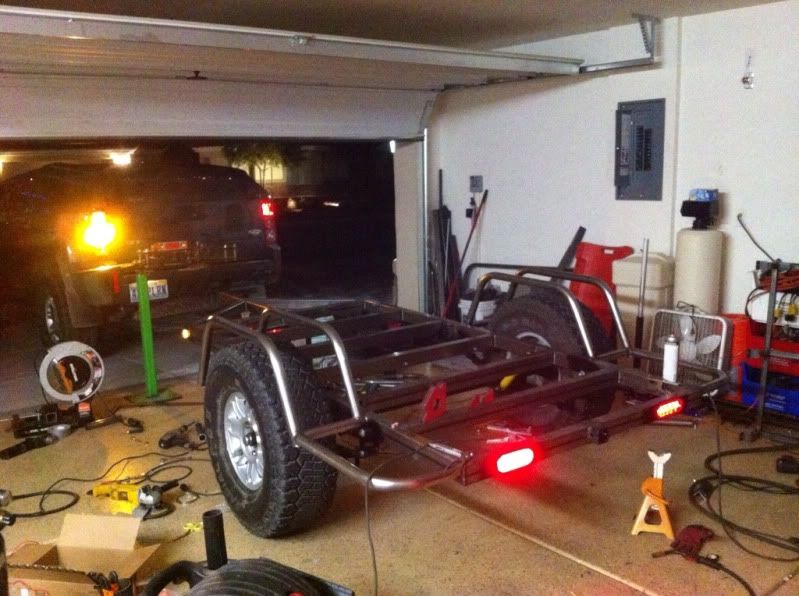

Postby Silvrzuki77 » Sat Dec 22, 2012 10:39 pm
Here is a pic of my led lights with the left turn signal going off. So I am nevada dmv complient minus need coverings for the fenders. All the wiring is ran through the frame and rubber groumeted round any holes. My lock n roll hitch is on its way xmas present from my parents. Waiting for the local steel yard to get some scrap steel for the fenders, hitch, front jack, and paint it. Then off to the dmv. First we are off to disneyland tomorrow for xmas. Wish me luck!

Postby JeremiahO » Sun Dec 23, 2012 10:19 am
Really liking the LED taillights mounted in the frame! I want to do either that or I'm debating a 3" bumper and then mount them in that. Is that thing gonna clear your garage door with those big ol tires?
