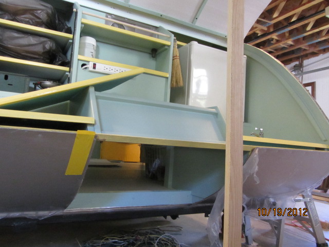

I fit the hatch on today and yes, we have clearance, Clarence.
(So how exactly did I close the hatch and still manage to get that picture?)
Bob

self timer on your digital camera??? LOL

No Houdini here, I slid up inside the spot for the A/C. I'm still working on a removable panel for that spot; at least I won't need the A/C for a while.
