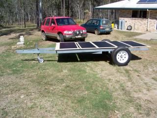

After all the hard work, here is the final result. I am very pleased with it and I can now complete the last of the painting with the Cold Gal paint
It is now too heavy to pick up by myself but with the wallaby, it's a piece of cake.
100767
You can see that I have enclosed all the ends of the RHS. It makes a huge difference for longevity of the frame.
100768
This is one of my new wheels. They are very nicely finished off and painted all over. I like the yellow and green stripes.
The tires are 14-185-75, they are 8 ply and called a Light truck tire. I was very pleased with the cost, $60.00 each
fitted and balanced
I made a tool from aluminium to set the hub caps into the hubs. The caps were driven in after filling them with grease. I made two washers to pack out the castellated nuts. These have works perfectly but holding a washer only .060" thick in a worn set of chuck jaws was not a pleasure. I discovered a major fault with the axle on one side. There were two holes to fit the split pin drilled in the outer end of the axle at 90 degrees. The split pin would only fit in one hole. When I tried to fit the pin into the other hole, I discovered that the pin didn't line up with the opposite slot/s in the nut. "Not happy, Jan!"
Everything is still the same, if I want something done right, I have to do it myself! At least it's all done now and ready for the wood chips to start flying.
I'm very pleased with the result, can't wait to get the plywood.

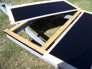

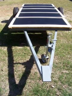

I now have the floor panels painted with the tar stuff. Using the masking tape was a great success. I applied two heavy coats of the stuff and now I can flip the panels over and glue and screw them down. Before they are screwed down, I will spray paint the trailer frame first. The photo shows the layout of what I have done so far.
This shows the front end panel and some of the bolts/studs that fasten the wooden bearers to the frame.
Front view, it will look quite different tomorrow. The frame will be painted (blue) and if the paint dries before it gets dark, I will glue and screw the rear floor panel down.

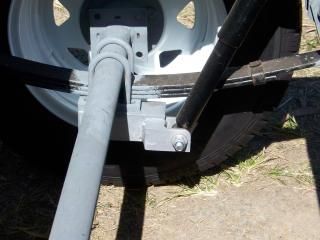

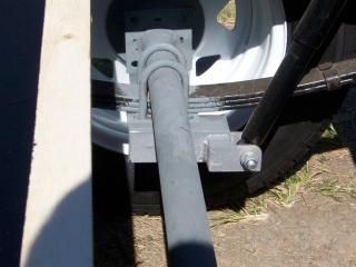

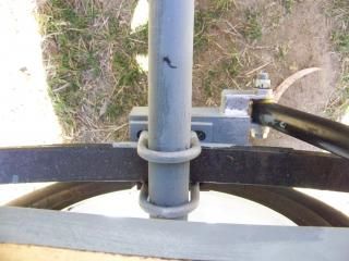

This is an above view of the shockie mounts I made. The mount consists of a 5" length of 2"x2"x1/4" steel angle drilled out to fit the shanks of one of the "U" bolts that hold the axle to the spring. The mount is a bit of an overkill and I will change it later (?) to a cantilevered bolt similar to the top mount. I much preferred this method of mounting rather than simply weld a bolt to the spring plate. It didn't take very long to make the mounts and I am pleased with them but the lower mount will be changed. (Maybe next year or the next, you know how it is.) If it's not broke, don't fix it!
This is how the mount is bolted to the spring plate. It was very easy to make, it just took some time to figure out how to do it in as simple a way as possible.
One more shot of the upper shockie mount. Perhaps this will inspire someone to install some shockies the same way as this. It really was easy to do, I hope the design/idea can can help someone.
