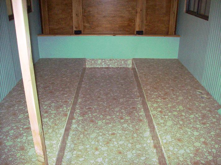

First photo - covered the entire floor with a single sheet of linoelum, glued to plywood subfloor.

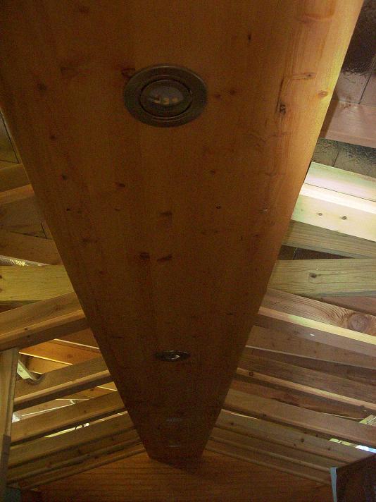

The roof will be a 3:12 gable. The 2 x 3 cedar rafters have 1 x 4 pine on bottom to simulate a beam ceiling and there is a 16" wide beam (edge glued 3/4 pine) down the center with recessed LED swivel lights. The roof panels and 2" rigid styrofoam insulation will drop in from above and be covered with sheating and a metal standing seam or shingle roof. The counter-sunk screw holes will be pegged.

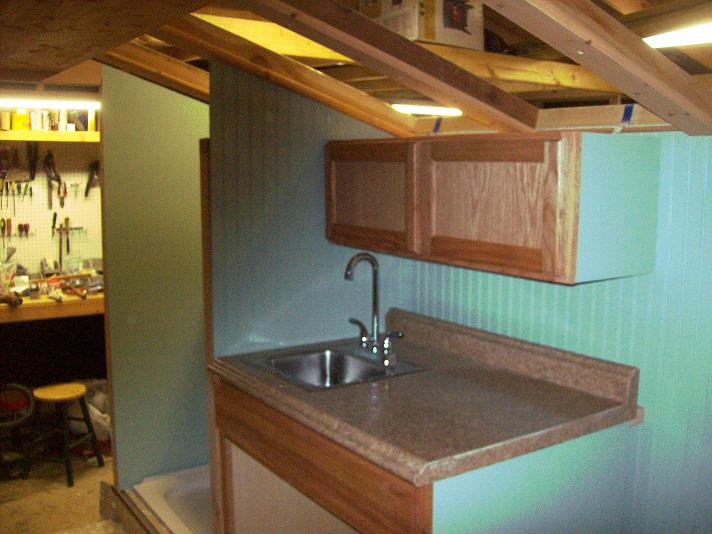

Shower, sink and cabinets on left. I will have the fresh water tank, water pump and heater in the lower cabinet. Gray water tank below floor to the front of cabinet and black water tank at rear of trailer under toilet/shower.

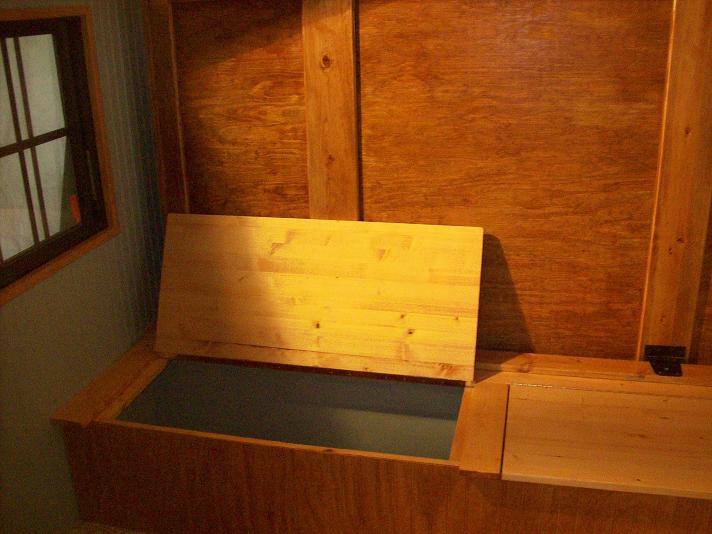

I built a cabinet/storage box the full width of the trailer in front of the murphy bed. The top of the box will serve as a desk top or table and additional seating. I will still have a table stored in the bottom of the murphy bed which will seat 4 -5 with the bench and chairs. The electrical converter will mount in the center of the box 3" above the linoleum floor and the batteries in a recessed box below the floor.

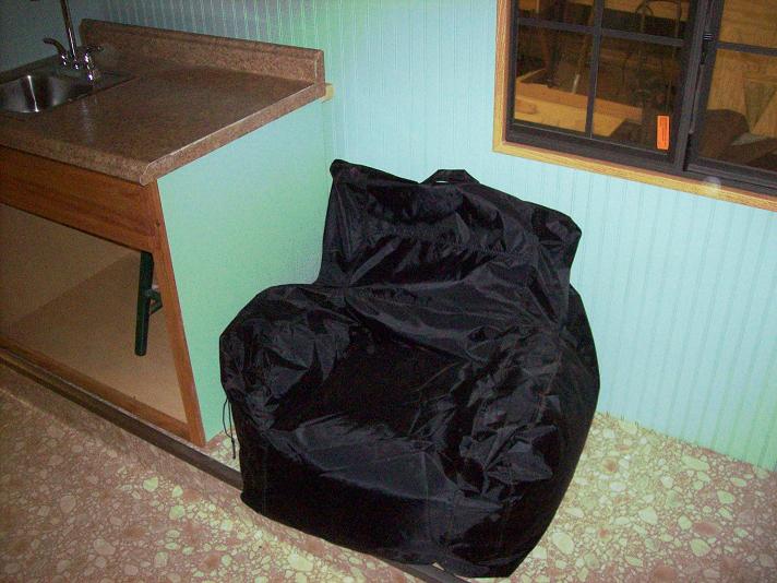

Rather than padded bench tops for seating I opted for these bean bag chairs. They have arms and a back and are quite comfortable, portable and cheap.

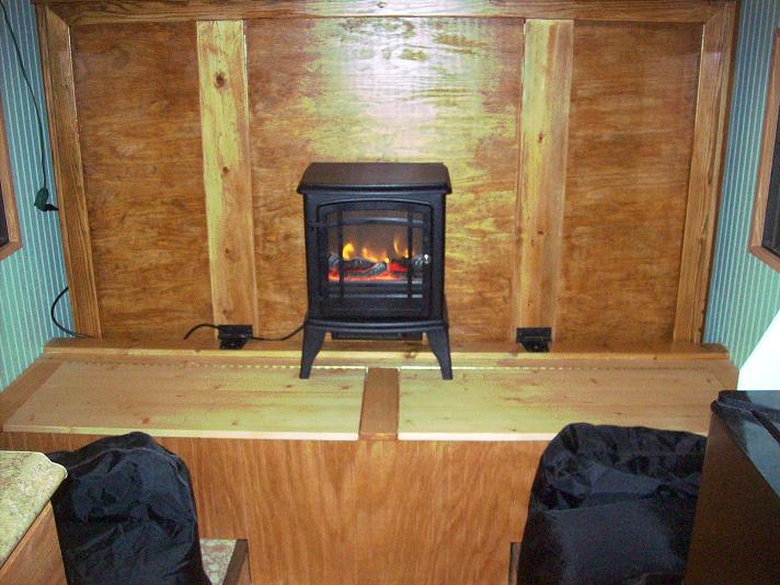

110V fireplace when on shore power or while completing the build in the shop. Quite cozy so far for glamping.

That fireplace looks real, not electric. You fooled me!

Great build, I had a look at it from the beginning some great pictures you took, love how you framed in the trusses and the wider board with the recessed lighting I might need to borrow that idea..... :thumbsup: :thumbsup: :thumbsup:
