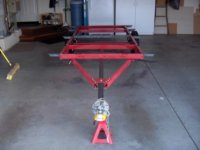

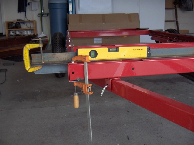

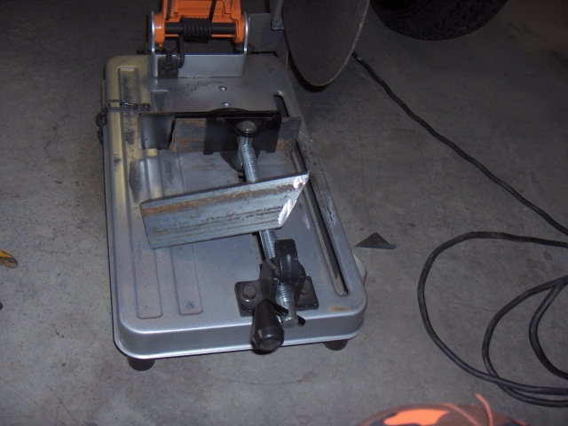

Well I've made a little more progress on the frame adding 2x2x1/8th angle iron to the sides of the frame as well as a cross member in the middle of the frame to prevent any sag in the floor when I put it down. This process would have been easier if I didn't have to rewire a 220 20amp breaker to be a 110 20amp breaker so I could weld (only have a 100 amp stick welder) but once that was done things seemed to move right along. I've come to the conclusion that the person who invented the stick welder was great but the peson who invented the grinder is even better. Nothing like a grinder to help clean up some welds. Now I need to paint the frame and then move on to the floor.
Here are some pictures of the progress.

What did you use to extend the frame? I've got the same trailer, and want to build out to 10'.

Enjoy the build. For similar reasons, I too chose the Compact design, but made quite a few modifications to design and layout and size. As a point of reference, my 6x11x5.5 trailer weighs 1,450 with a full propane tank, half water tank, and full port-potti.
Putting the larger floor plate on a smaller dimensioned frame isn't a big deal. A few pieces of angle iron extending to the outer edges is all you need. The plywood floor and the structure itself make for a sufficiently rigid structure.

c139 wrote:What did you use to extend the frame? I've got the same trailer, and want to build out to 10'.
Hi C139, I used the center cross members that came with the frame. The cross members fit right inside the frame on both the drivers side and passanger side of the trailer. Since I used those crossmembers to extend the frame, that left a big empty space in the middle of the trailer. What I did was get a 4' piece of 2x2x1/8th inch angle and welded it into the center of the frame. Not sure if I needed to but it gives me piece of mind which is worth a lot. Take a look at my first few pictures. I tried to photograph the extension. Hope that helps.

Hi Myoung, thanks for the input and especially the weight. I think I've read through your thread 3 times now and will probably take many more looks at it. Everyone has great ideas that we can all pull from. I'm only planning on 5.5x10 trailer. I won't have a fridge, AC or hot water tank so that will hopefully bring the weight down from what yours weighs.
