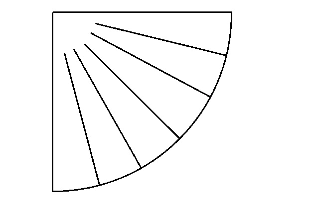

Maybe this could be a solution for the roof corner problem.
The radius of the corners is 300 mm. So the outer length of one roof segment is 471 mm.
The square angle will be on top of the roof.
If I cut a sheet of 471 x 471 mm in this way it could lay one segment over the other like they did it at the front shell of vintage airstreams.
Then rivets and sealing with liquid from inside.
I will test it with cardboard and if that works with a sheet of aluminum.
Or better draw the lines on one eighth of a 60 cm diameter plastic ball and cut it !

Never thought of doing it that way, but you may think about sealing between the overlaps. A faying layer of sealant and shooting rivets while it's still wet. We do that on jets and it almost act like a glue but that method, done with the right sealant, could be air tight.
Randy

Hi Tom,
If you use this method, I recommend you drill a hole at the top end of each of those
radiating lines, @ 1/16th to 1/8th inch diameter [obviously use your metric equivalents]
- or your rivet's required hole size - up by the top corner. This should prevent the metal
from ripping or cracking at that spot/point as you bend it into position and help the
top corner form a shallow cone section as you bend and form the end caps. I had to
recently fabricate a section of ductwork for an in-progress home project and this hint
helped me form the shape I needed - my first attempt at making a 3D shape from sheet metal.
Also, I was using very thin aluminum [Flashing stock, I doubled it and riveted the two
identical pieces together to get the thickness needed for at least some rigidity.] that
I cut by repeatedly scoring with an utility knife along a metal straightedge [a framing square
leg] at the cut line. I don't know if SS would allow you to do that reasonably easily or not,
but it gave me straight flush cuts with no deformation that would have been caused by
using metal shears. [I don't have access to a metal brake or guillotine style sheet metal
cutter, so I had to do it all by hand and 'by guess and by golly'.]

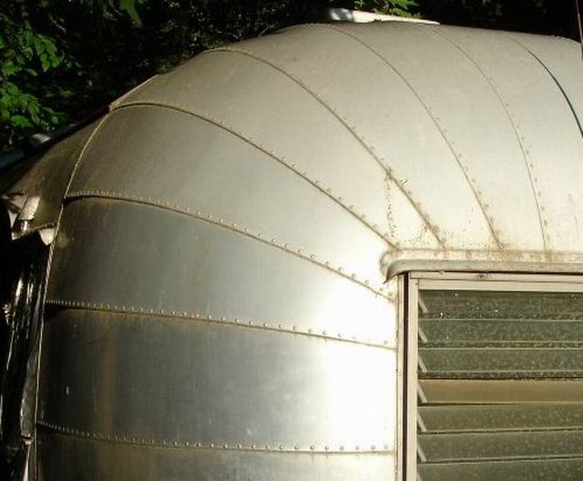

The Airstream on the picture is a good example. The tile apexes center at the front and rear end of the body.
So I take my six vinyl globe sheets and cut through the north pole.
The first five segments will get 20 mm overlap at the upper side and will be rivetet from the bottom to the top.
The sixth segment get no overlap and will close the roof. So they lay like roof tiles.

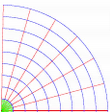

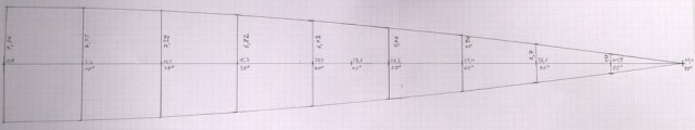

Drawing a segment of a hemisphere !
(sorry for my preference of metric distances)
There is an article in Wikipedia called Longitude http://en.wikipedia.org/wiki/Longitude#Length_of_a_degree_of_longitude
Here is a table on the right which shows the distances on earth at a defined longitude for one degree latitude.
My quarter hemisphere is 90 degrees wide, so each segment are 15 degrees.
The radius is 300 mm so from equator to pole the distance on the surface of my roof is 471 mm (10000 km on earth).
15 degrees on the earths equator are 1670 km so on my roof 79 mm.
Using such a table for the earth with 10 degrees difference in latitude i can calculate the wideness of the six roof panels.
At the base on the left side the panel is 7.9 cm wide and at the apex on the right side zero.
Drawing this on cardboard I can transfer the panels on a aluminum sheet plus the overlap and start a test.

Postby ST1100 » Wed Feb 06, 2013 7:35 am
Okay - next step:
Using my yesterday table I drew one of my roof corner panels on paper, so I can transfer it six times to an aluminum sheet.
Six of that panels should build a perfect quarter of a hemisphere. only for the apexes I have fo find a better solution.
Possibly I should cut the apexes and place a small quarter circle on top of that corner.
