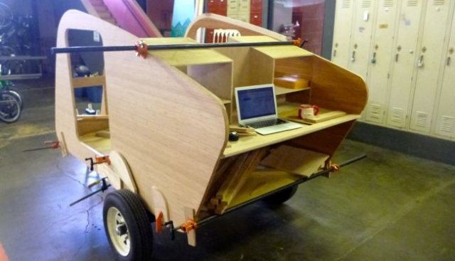

Postby theDangerz » Sun Aug 18, 2013 10:40 am

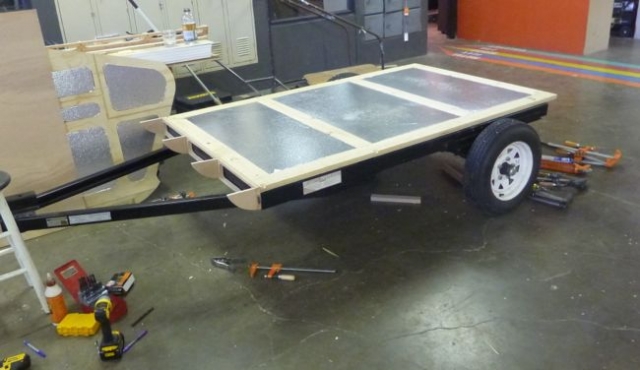

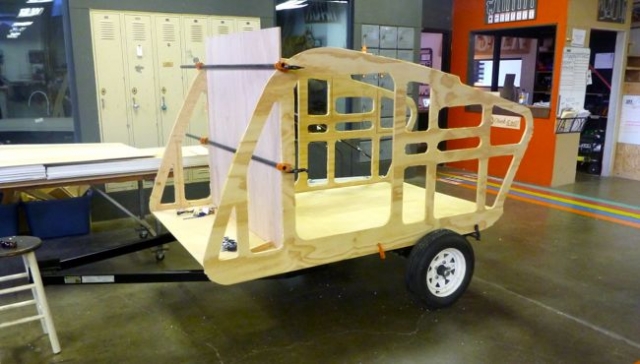

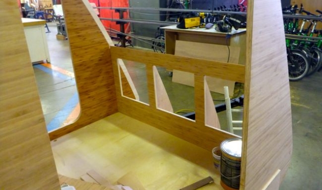

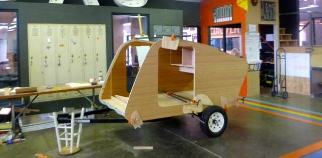

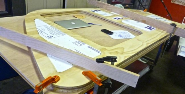

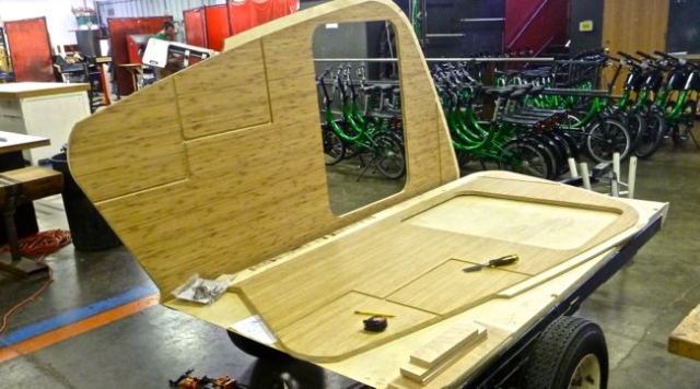

Finally- a build day.
Kind of a slow start. Mostly cleanup of all the edges and taking stock of what ive got.
The floor got half way assembled and i recessed some holes to allow for the bolts on the trailer (so it would still sit flush on the trailer.).
Our floor also has the lower curve built into it, so we had to tilt things us to confirm fit and curve in relation to the floor.
It was amazing to see the shape turn into a 3d object (even if hollow and supported by clamps)!

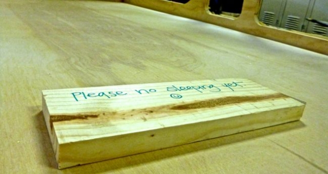

Jen took the time to put a note on the trailer to make sure no one cuddled up inside over night while we were away...
now, the only problem is- its going to seem like were moving backwards when we take the walls off in the morning. :roll:

Postby theDangerz » Mon Aug 19, 2013 1:42 am

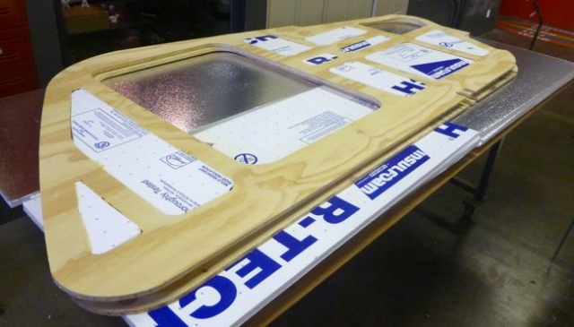

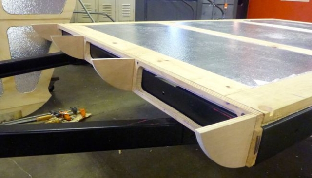

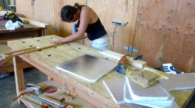

A bit more action to report, mostly in the insulation department.
the floor now has insulation
and the lower curves have been fabricated
the gaps in the side walls are now also filled in with insulation cut to size.
looked a lot better when things were standing upright- but at least there's still progress :D

Postby theDangerz » Fri Aug 23, 2013 12:43 am

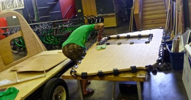

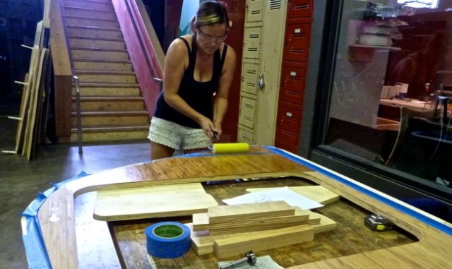

been a busy week.

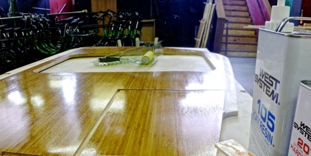

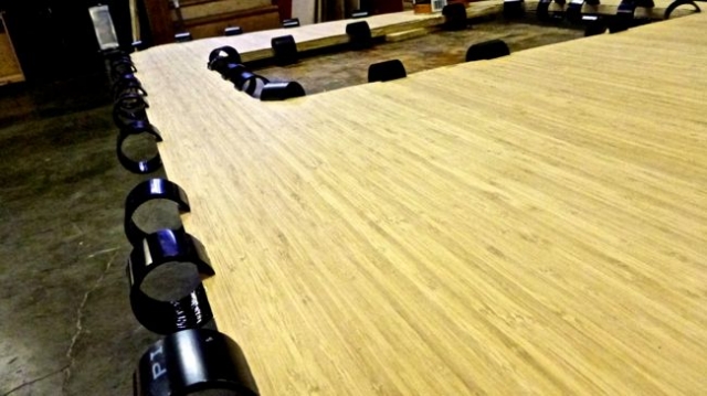

started laminating the bamboo skin onto the skeleton walls.
the inside was difficult to clamp due to the routing, but the outside skin was easy thanks to some homemade abs pipe clamps.
they saved us a ton of money over the spring clamps and worked great.
today we epoxied the interior surfaces prior to install.
its amazing the richness added after a quick coat of epoxy.
also started on piecing together the galley cabinets

Postby theDangerz » Mon Aug 26, 2013 4:20 pm

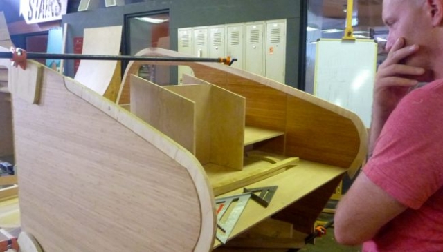

Still trudging on.
Finally got the cabinets far enough along to tilt things up and start working on it as one camper.

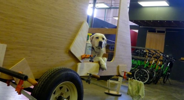

really gratifying day, but should have planned ahead to ask for a few more hands. Once again the community workspace came in handy as others came running over to help lift/clamp/support.
Dog seems to like the doghouse...
Currently working on the galley and front cabinets.
hadnt really fully planned these before getting underway so were figuring out what we want from the cabinets and workspace as we go.

Postby 3nero » Mon Aug 26, 2013 5:24 pm
Looking really good. Loving the ABS clamps, I'm going to add lots of those to my tool box 8)

Wow, looking good! Those homemade clamps are pretty ingenious, I might have to make some myself. I can't wait to see more updates!

the "clamps" save us a ton of cash ad have worked out great, especially when laminating.
