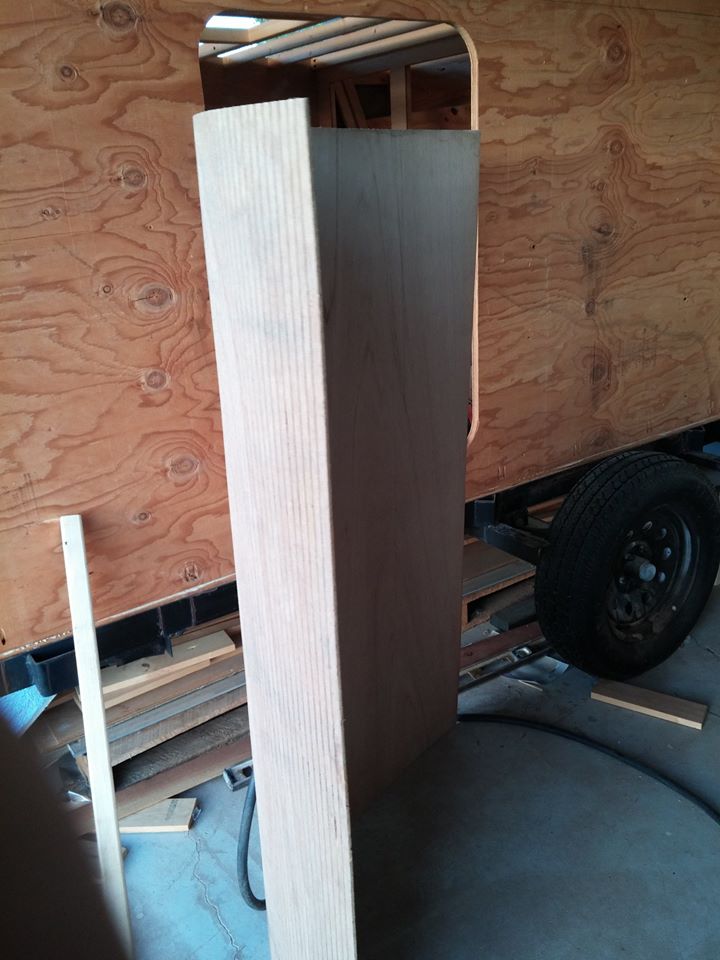

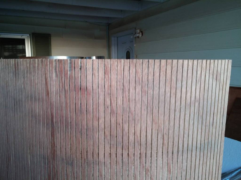

Well I bought some 1/8th sheets at home depot. When i put one on top of the front radius to see how far it would bend, the veneer cracked and bubbled under minimal pressure... Turns out the top layer was paper thin. I might as well have bought wood grain contact paper. So I decided to use my 1/4 inch stuff and kerf the back of it. I cut every half inch on a 4' wide piece. Made it really bendable! Still needs slight wetting and bending, but I am very pleased with it. Its to dark or I would have some pictures. I'm hoping to be able to install the headliner by the end of the day tomorrow. Pictures to follow.

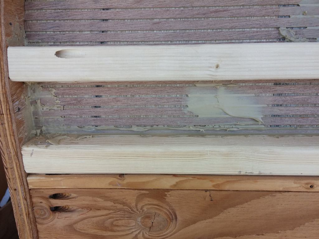

Word of the day kerfing. These kerfs are 1/2inch apart and total 96 cuts. Took myself and my father in law about an hour tag teaming moving the guard on the table saw and pushing it through. Once the cuts were made I put it on the trailer with some wet towels overnight and this is what I ended up with. Pretty pleased with the outcome.

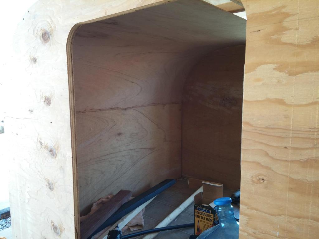

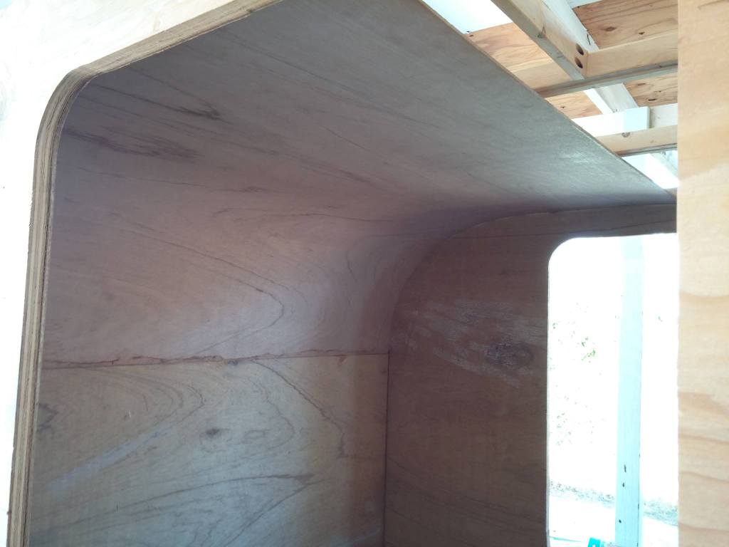

Bent section of the headliner is in. My trailer isn't square because I built off of the flatbed frame which wasn't square. This caused the headliner not to go In quite as easily as I planned. I added some shims which solved my problems. I then added some liquid nails along the spars to prevent the headliner from sagging in the future as I only stapled on the edges. The I spread the remaining liquid nails into some of the kerfs to help make the piece more rigid.

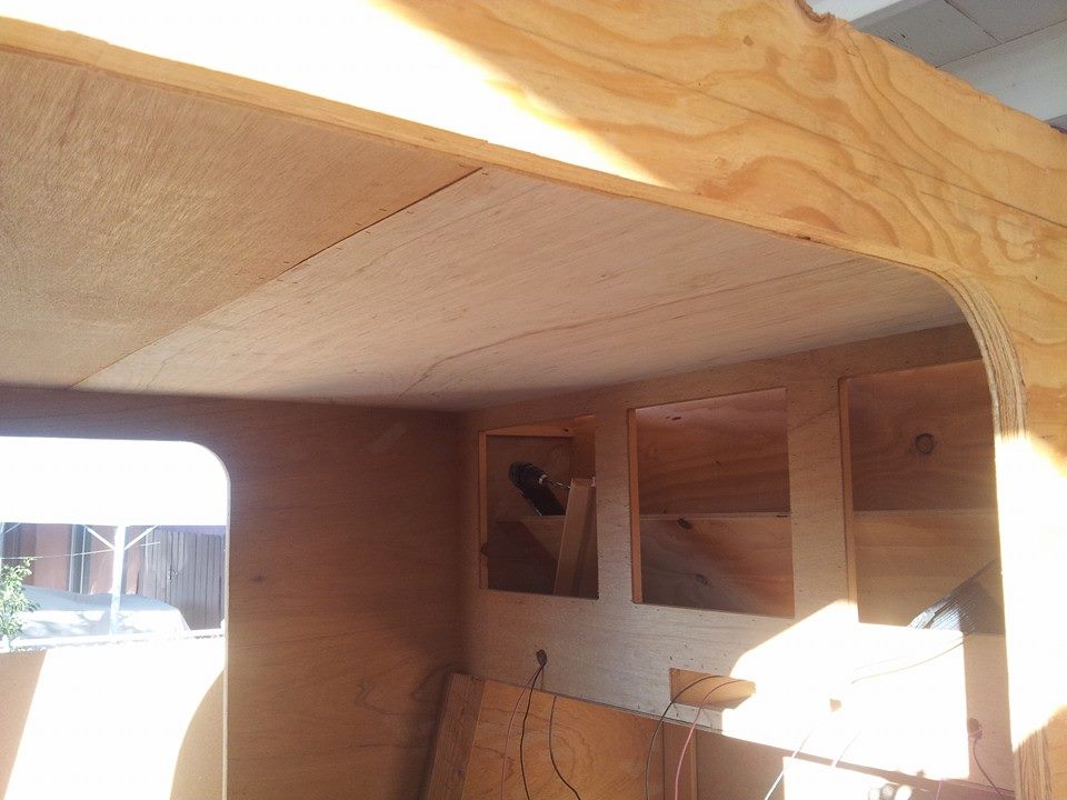

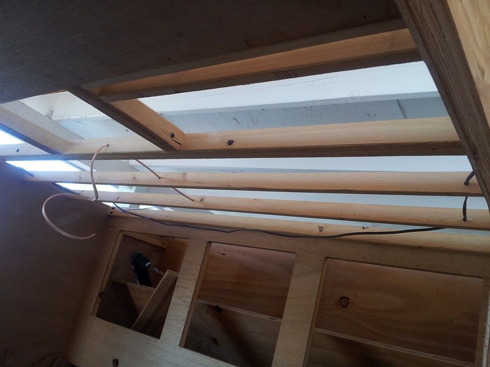

I finished running the cabin wires from my fuse box. I also installed the last piece of the headliner in the cabin area.

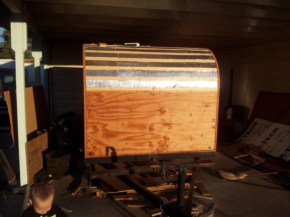

I had a bit of time today so I started adding some foam board insulation with some help from my little man.
