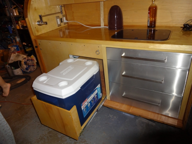

Postby twinight » Tue Mar 25, 2014 1:01 am

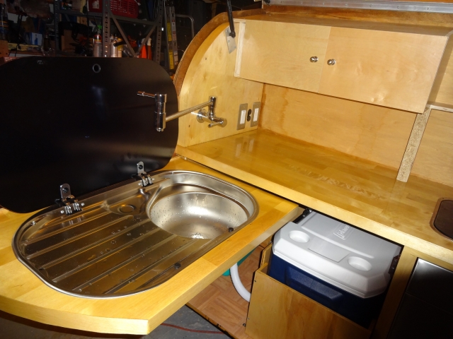

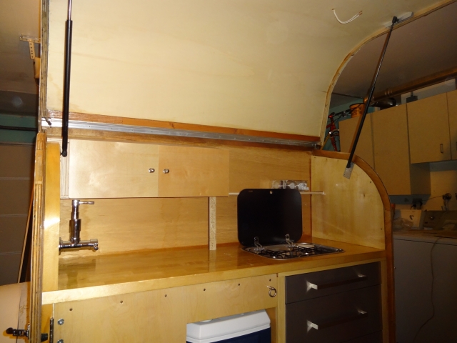

The galley is almost finished. The gas is hooked up with copper line to the tank up front. The plumbing is installed with a pressure switched pump.
The upper cabinets are mounted temporarily while my wife hunts down the terrazo FRP backsplash she likes and the grey FRP to skin the inside of the hatch. I found some bright 12v LED puck lights at ikea that are going in the ceiling. The hatch struts were spare parts left over from an old integra I had. They hold the hatch horizontal at full extension. When the hatch is closed, they do hold the hatch open just a bit when it cams over center, giving the draw latches a workout.

Postby KCStudly » Tue Mar 25, 2014 6:39 am
Looks really nice! :thumbsup:
Re: The "Minibago" benroy continued.....
Postby S. Heisley » Tue Mar 25, 2014 8:07 pm
That galley is very nice and also well thought out! :thumbsup:
Posts: 8867
Postby jimun » Tue Mar 25, 2014 10:24 pm
That is a nice looking galley.Image

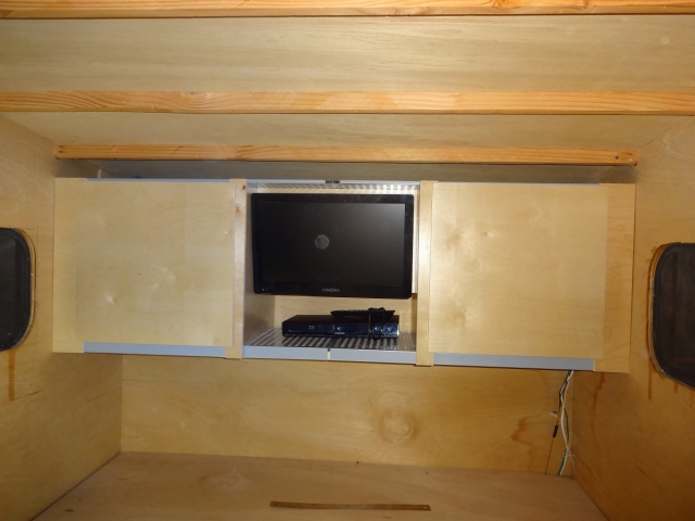

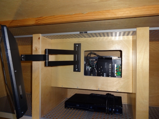

Postby twinight » Thu Apr 03, 2014 2:08 am

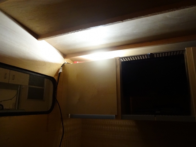

I got the inside cabinet done. I used some perforated metal racks that happen to be the perfect width when joined. I used these on the top and bottom. The center is a recess for a 19" TV and a DVD player shelf. Behind the TV is a compartment for the converter and solar charger. The perforated metal panels allow for venting and also light to pass through. I plan on mounting some cove lighting that will wash the ceiling and light the cabinets at the same time. The inverter will be mounted next to the battery on the floor to keep the 2awg cable short.. All the wiring will run down a chase in the corner.

Postby jbyrd » Thu Apr 03, 2014 7:37 am
Great job on those cabinets! I'm really liking the perforated metal :thumbsup:

Postby twinight » Thu Apr 03, 2014 2:09 pm
The metal was used because I ran out of the birch plywood, but it became a design element.
I love the as-is section at IKEA. Lots of building material for dirt cheap.
My wife said no flush doors like the galley cabinet, and this way I didn't have to build a cabinet face either. The doors are also held off the face of the metal and requires no door pull to open for a cleaner look. The perforated metal will creates some cool lighting effects. I might use an acrylic shelf or clear coroplast to save weight and allow light to shine through.

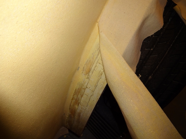

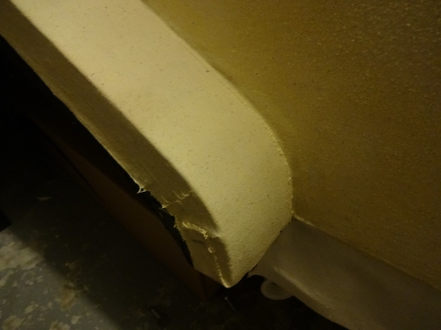

Postby twinight » Tue Apr 08, 2014 4:52 am

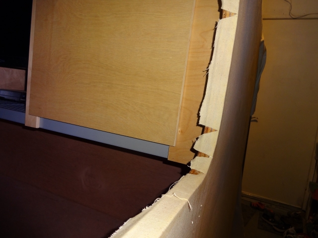

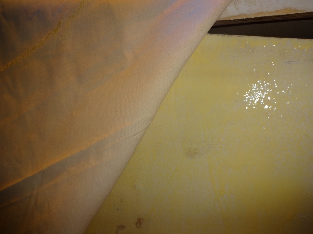

I just got done skinning one side in canvas and it came out looking pretty good.
The 8oz canvas from Rose Brand was not-preshrunk and not-ironed.
I cut the canvas a foot longer than the length and secured it over the side with some weight plates on the roof.

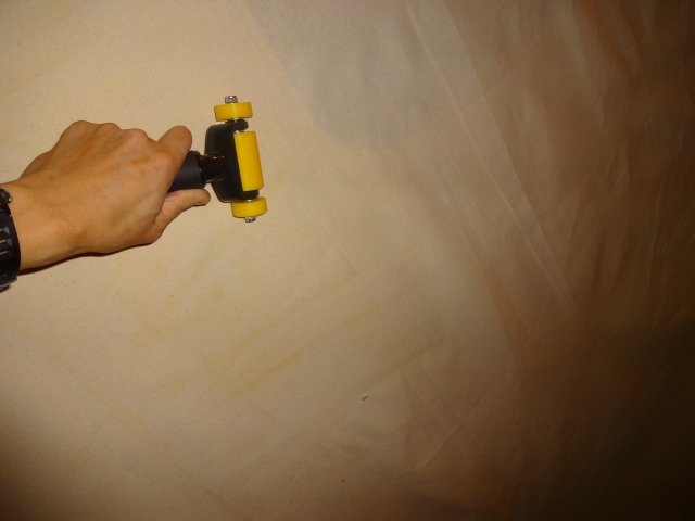

then I folded it all on top while I rolled on undiluted TB2 on half the 5x13 side. Then I dropped the canvas down and started smoothing it out by hand to stretch out the folds and prevent bunching up and wrinkles. I followed up with a carper roller and a spray bottle to get the glue to soak into the canvas and spread evenly. The wheel wells I ended up using a staple gun to secure the edge and followed up with an overlapping strip to cover all the exposed wood. The window openings, I overlapped the thickness of the walls.
After all the canvas was on, I rolled on a layer of 50/50 diluted TB2 to make sure the canvas was soaked through.
After all was said and done, I only used 1/2 gallon of glue.
Postby twinight » Wed Apr 09, 2014 12:43 am

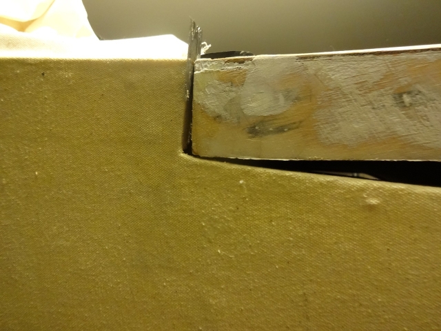

I only used one layer in the window jambs, since it will be covered up by the window and trim and not visible. It's a tight fit, but I placed the window in the opening as the canvas was drying to make sure the opening didn't shrink. I only used 2 layers over the wood fender extensions. I'm working on the other side tonight. The door and hatch jambs will be covered over with butyl tape and aluminum angles to act as flashing and water stops. After the other side is done, I will trim the canvas flush at the top edge. I will be cutting 2" wide trim pieces out of 1/2" foam to create a raised band along the edges. Then the roof canvas will wrap over the side and terminate on the inside edge of the raised foam trim.
