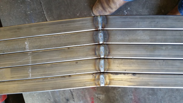

Clamped cross members together so they all keep the same angle.
bows clamped.jpg (133.51 KiB) Viewed 1862 times
Welded them up.
bows welded.jpg (66.72 KiB) Viewed 1862 times

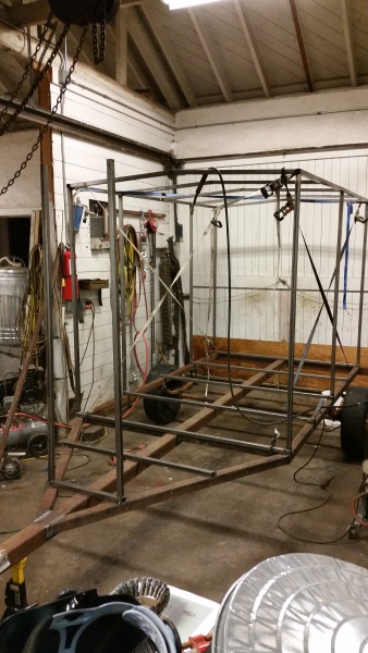

Got the uprights and bows tacked in and scrounged every ratchet strap I could find for x braces to square it all up.
