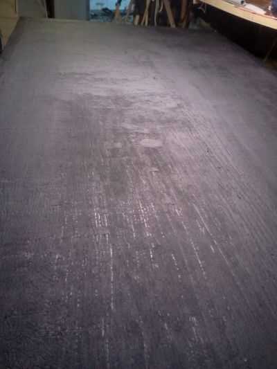

Postby Wobbly Wheels » Mon Dec 08, 2014 1:12 am
Yesterday I got the underside of the floor coated according to plan. I will might slather on some more and get it onto the frame as well to seal up the cracks between the two and the fasteners holding it all together (1/4" galv carriage bolts). Black goo is a bit like explosives that way: figure out how much you're going to need, then add a bunch more.
I've kept a weather eye (aaargh, matey !) on the weather all week so I would be ready for the break in the rain forecast for today. It was nice and warm today (10 degC) so, with the glue and the panels kept inside and a t-shirt on, I glued on the walls.
Anyone familiar with camping in the rain (and experienced tarp-ologists) in general will of course know that I need to support the tarp between the spars or I'll get giant pools of water that will be looking for an excuse to dump their entire contents onto the bare wood floor and framing. In order to foil ol' Murphy, I threw a piece of doorskin over the roof spacers to keep the tarp from sagging between them. I guess it's just as well that this is a 4X8 build, eh ?
I wonder if anyone's ever come up with a way to drain a tarp full of water without that water drenching whatever the tarp was meant to protect in the first place ? Of course, there is some kind of perverse pleasure in just slitting the 'belly' and letting the water splash everywhere.....but then again, I was always the kid who found the nearest mud puddle whenever he got a new pair of sneakers.
Enough babbling: on to the pictures !!
The black goo went on about 9am yesterday and by lunchtime it was tack free, though by this morning I could still leave a fingerprint in it if I pressed hard.
I used Bakor Roof Patch, which I've used before on utility trailers. It never really 'hardens' but it goes on runny enough to soak into the wood and hardens enough that you don't really get any on you when you're handling it. That said, I'll be carrying it by the edges and the top side and in latex gloves...
In warm temps, it softens up a bit and self heals from rock chips. If I make my own wheel wells (probably), I'll use it as a liner there as well.
I haven't done this in a while and, if memory serves, I thinned the first coat down into a paint last time I used it. I was looking at the quart can and figured I'd need two. They were $9 a piece and the gallon can was $20 so that's what I came home with. Those marketing folks know their business, eh ?
My 4X8 surface used about half the gallon but it's a bit thin in a couple spots - not a big deal since it's soaked into the wood really well but I still want to get a thicker layer on it. If some is good, more is better (again with the explosives references) The label mentions a 3mm (~1/8") film thickness, which I've pretty well got in the first coat.
I used the disposable yellow plastic drywall knives and it went on well with a 3" notched and then a final smoothing with a 6" straight blade.
