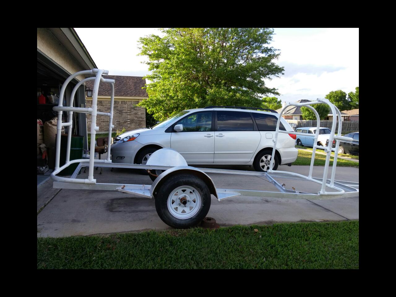

Suggestion: consider putting the water tank and battery closer to the axle center line. The less weight at the extreme ends the less wag potential. Also, the water tank is "variable ballast" so changes in tank level will have a greater effect on tongue weight if placed at the back than if placed at or near the axle.

I've been hearing similar advice from some truck driving friends. The bed will reach over the axle almost to the door, so I will be able to fine tune the position of my ballast as needed.

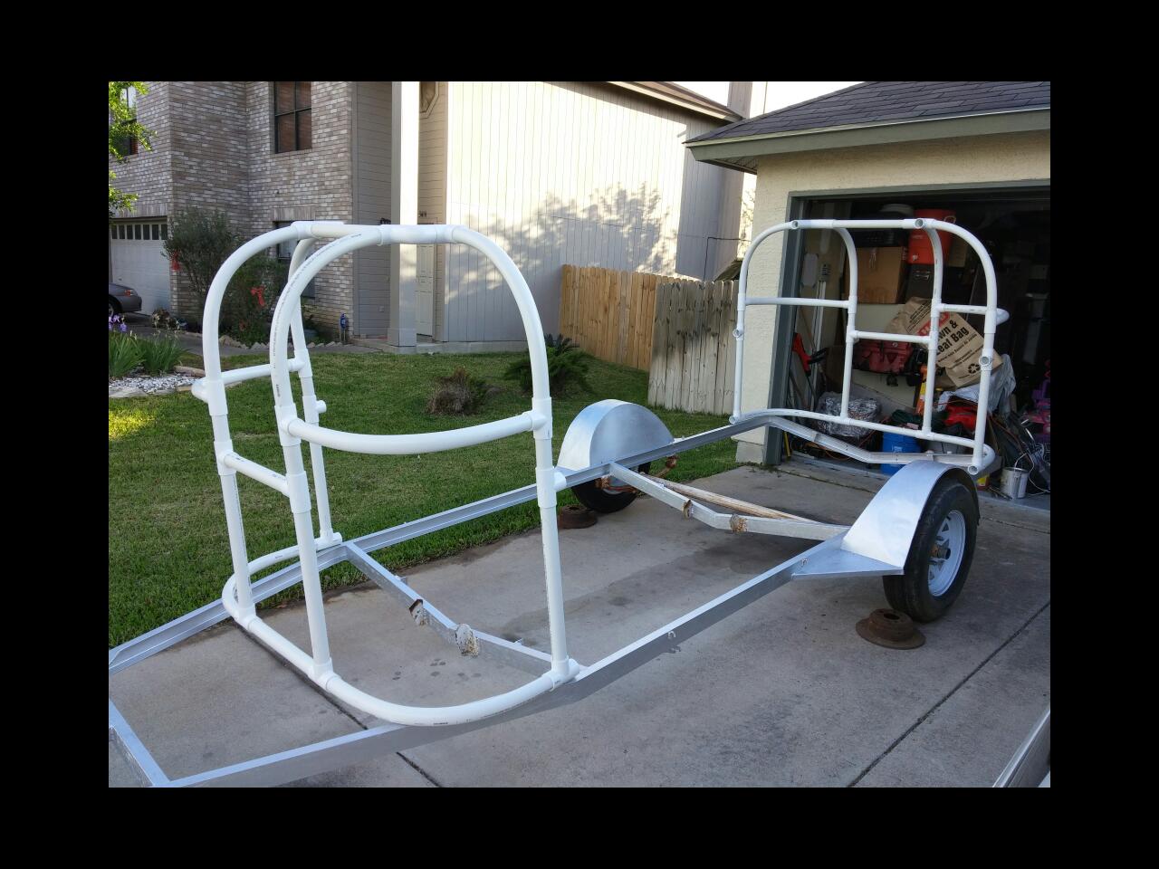

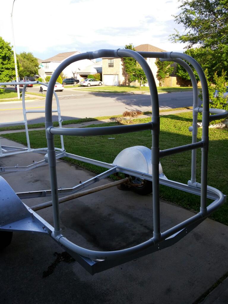

I got the end pieces mocked up and set them on the frame to get my first visual of the profile. The front will be closer to the hitch, I just can't set it there till I get the floor built.

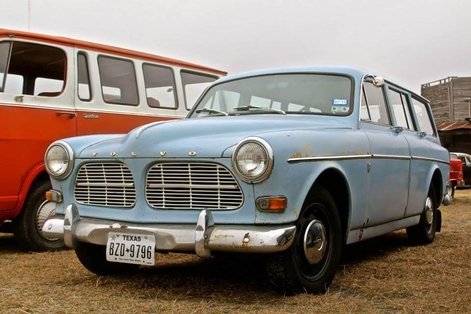

Very interesting,what kind of car do I see ,Triumph maybe?Gary

That's my daily driver, a 1966 Volvo 122s wagon. It might pull occasional tow duty to local car shows depending on the weight of the finished trailer. I have a deep love for this car. Reliable, easy to work on, surprisingly quick and a real blast to drive. I have owned a lot of 60's cars but the Volvo is getting passed down to my kids one day.

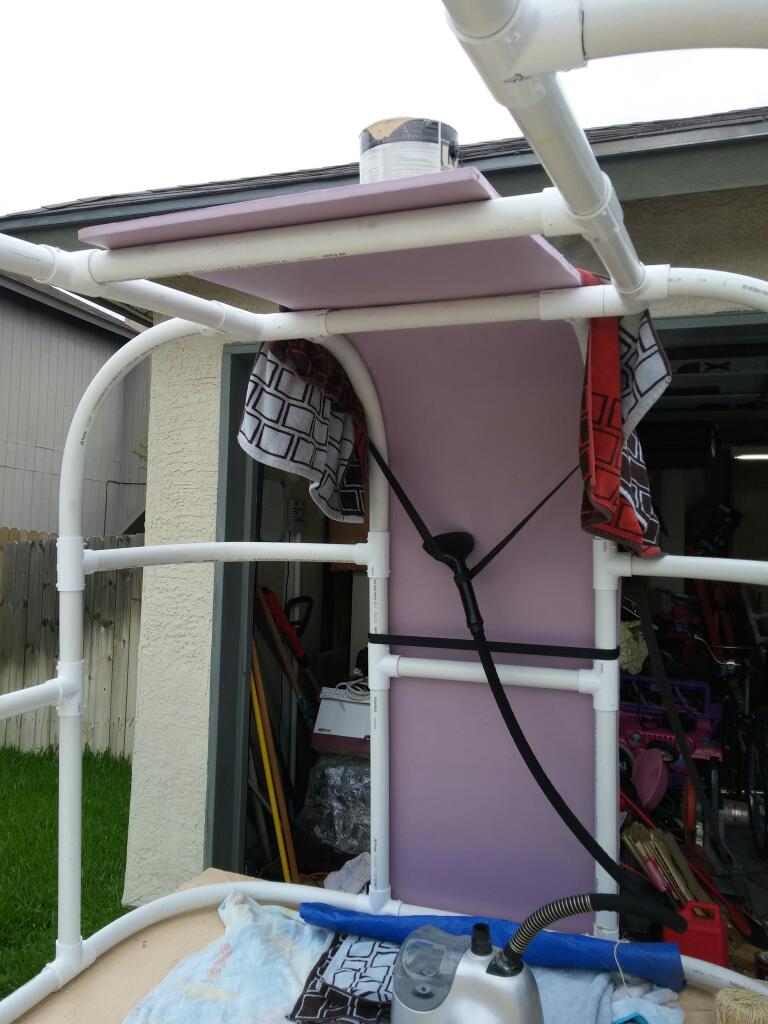

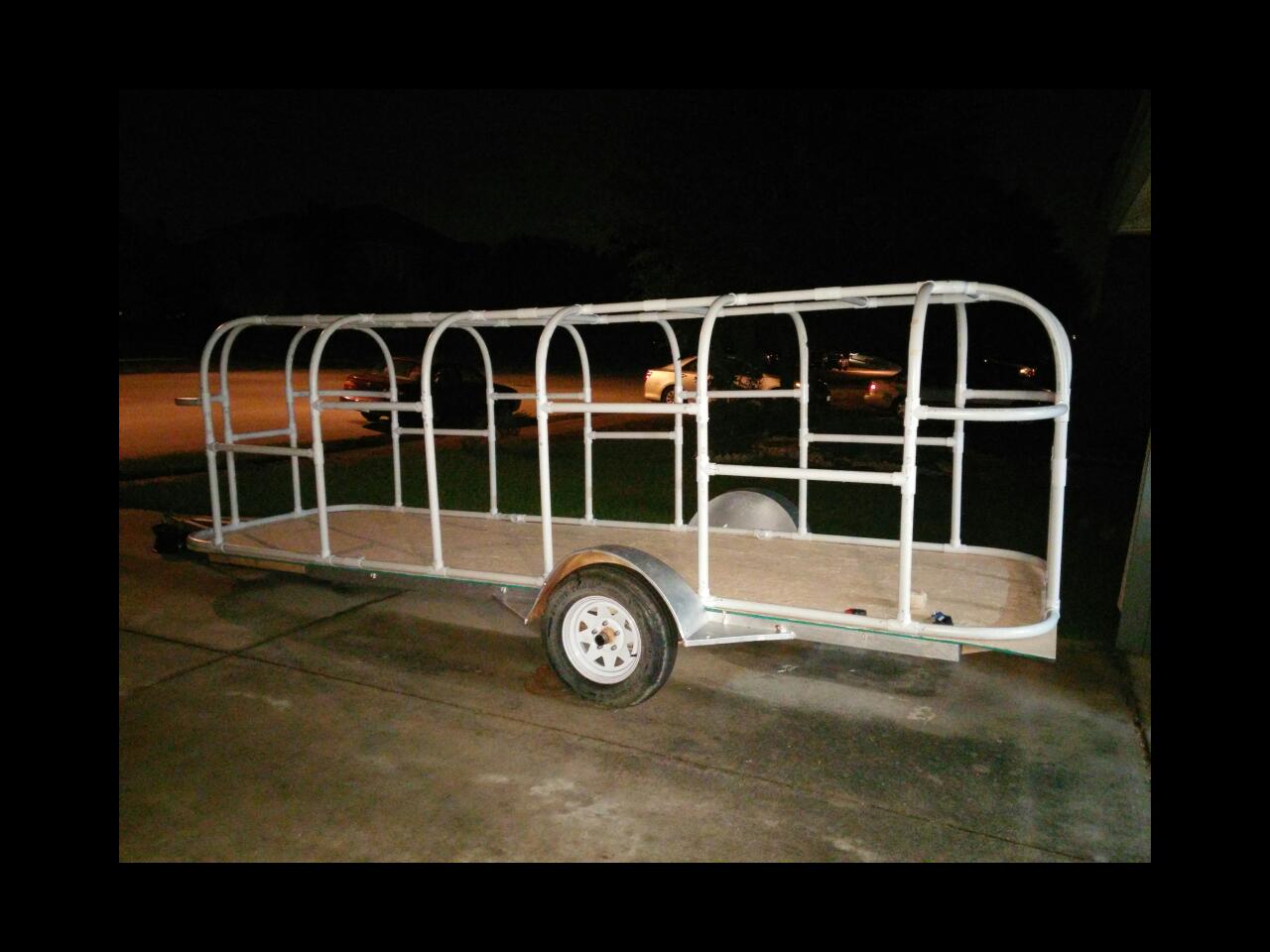

Progress has been slow due to non-stop rain in central Texas over the last month. I have been working on it when weather permits. I'm about a month and a half away from my deadline. The PVC skeleton is done, still working on the door. I began steam bending the foam sheeting today before I got rained out.

Have you decided how the foam will be attached to the PVC or will you rely on the exterior canvas shell to keep the entire unit in place ? How do you plan to finish the interior ?
