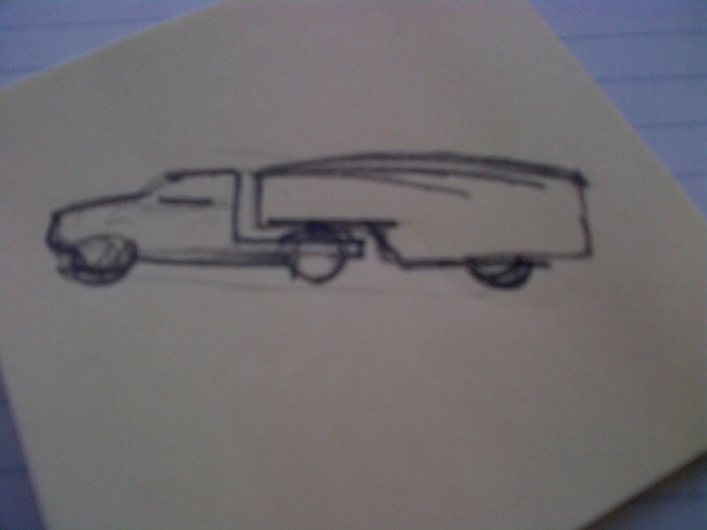

To have more height and save on weight you could go with a flat platform of just "almost" naked frame vs. standard pickup box in the back. That should give you more space and turning posibilities for the fifth wheel.. Could also get it very close to the cabin to have a better aero shape.

Postby OP827 » Tue May 12, 2015 9:58 am
Something like that?

OP827 - Yes, something very much like that!
