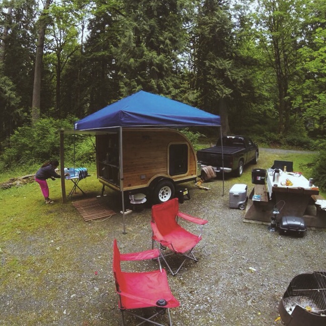

Postby wiseguydirk » Thu Jun 11, 2015 11:40 pm
The siding fits under a grove routed on the inside of the trim.. This is to hide the brad nails and to keep the trim edge as clean as possible.. Later silicone was put between the siding and the trim..

Re: Woodie build
Postby dogscats » Fri Jun 12, 2015 12:45 pm
Can you give more information on your siding

Postby wiseguydirk » Fri Jun 12, 2015 6:28 pm
The siding is T&G red cedar.. Stained with log home finish to protect. The trim is yellow cedar from a mill.. The trim is pocket screwed together. The siding has no visible staple or brad marks. Everything is hidden with a routered edge.. The trim os sealed with epoxy and a UV type stain over top.. Because epoxy is not uv resistant.. The siding is sealed on many levels to prevent water getting in.

Postby wiseguydirk » Fri Jun 12, 2015 6:29 pm
Stainless screws hold the trim in place.. I haven't decided if I want to put plugs in the holes or just leave the stainless screws in place.

Re: Woodie build
Postby wiseguydirk » Fri Jun 12, 2015 6:37 pm
Test camping.. More pictures of the finished kitchen soon.

Re: Woodie build
Postby wiseguydirk » Thu Jun 25, 2015 1:54 pm
Taking the woodie out for a good weekend of camping!
