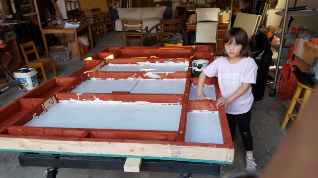

Materials for Floor
- 2x4x8 studs - 20.96
- 2x4x10 studs - 6.84
- 3 sheets 1/2" OSB - 28.65
- 3" Screws - 4.37
Running total - $443.37

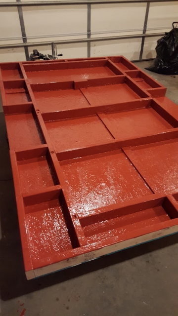

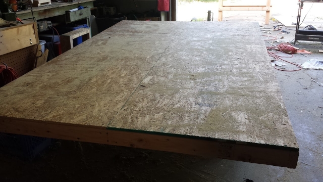

It has been a busy fall with work, and family, and Boy Scouts, etc. It has taken me way too long to finish the floor.
I cut out and layed down the floor.
I then flipped it over and gave the bottom three very heavy coats of barn paint. The first was red, then white (I had some leftover), and then finished with more red. It worked well because you could see if you missed any spots.

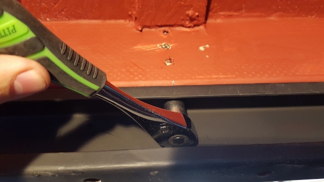

I then flipped it back over and attached the floor to the trailer with lag screws.
Now with the floor finally done, I get to start on the walls. This is when it starts to get real. I have to return to the lumber yard to get more materials. Should be exciting.
