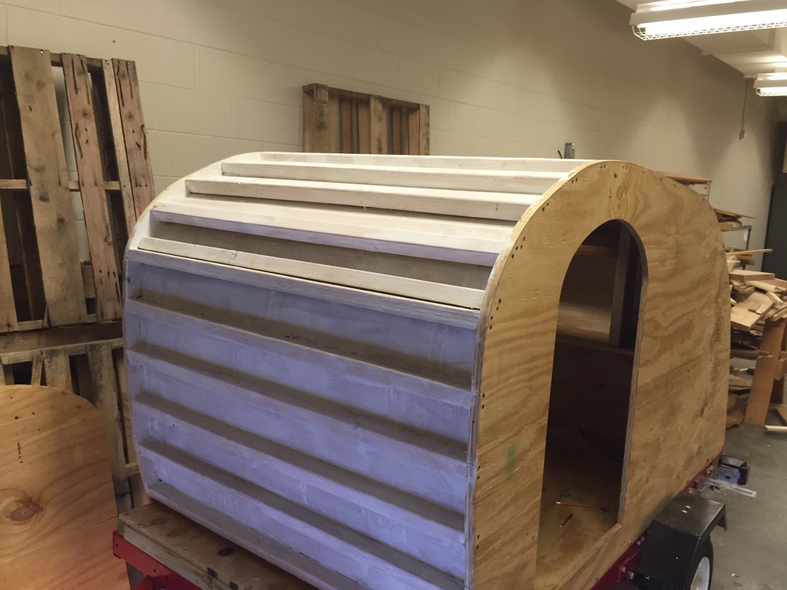

Postby hpuckett4 » Thu Oct 15, 2015 11:52 am
Thanks guys! I've heard a lot about the elastomeric, I think I'll go to menards and check it out.
Here is an update of where I'm at, kitchen is just about done and i have one coat of oil based paint/primer on the roof.
Thinking about insulating the roof, what have you guys found is the best way to cut that pink board stuff?

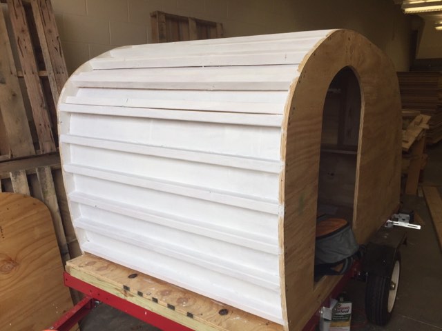

Postby hpuckett4 » Thu Oct 22, 2015 2:14 pm
I just got my final cost of oil based paint/primer on the outer side of the inner skin. Technically, I have no idea the purpose of this step, but water protection always sounds like a good idea.
My dilemma is that before me are three daunting tasks: the doors, the hatch, and the exterior skins. I'm not sure what to tackle first.
My current and hesitant plan of attack is to put in room insulation, skin the front part of the roof, glue on the aesthetic side skins (3/16" ply" then do the hatch, then doors, then trim. Sounds good, right? Let's see how it works out.
