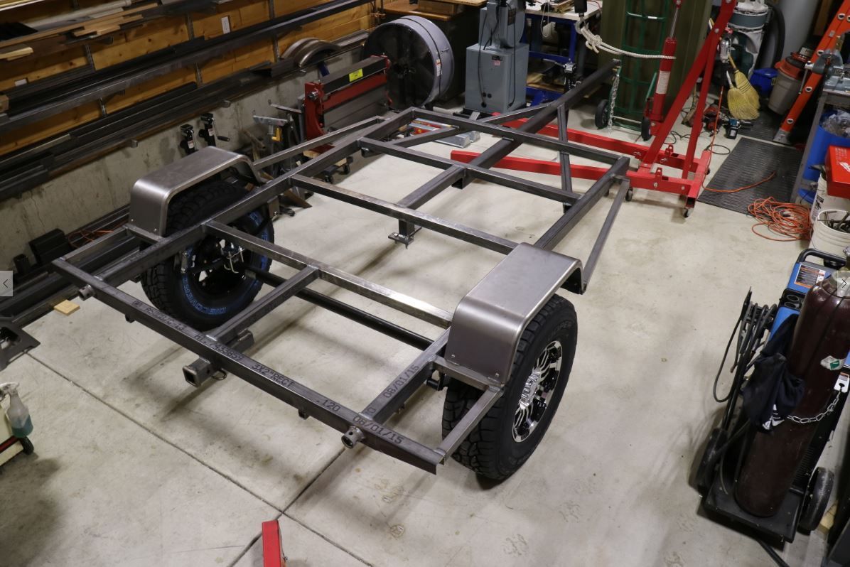

Re: Overland Trailer build Jkidd6339
Postby jkidd6339 » Sun Jan 10, 2016 8:04 pm
I removed 10" off of the tails. I'm down to the shocks, lights and putting caps on the end of the square tube. Oh and the angle for the tie downs and deck. Here's a pic of today's progress.

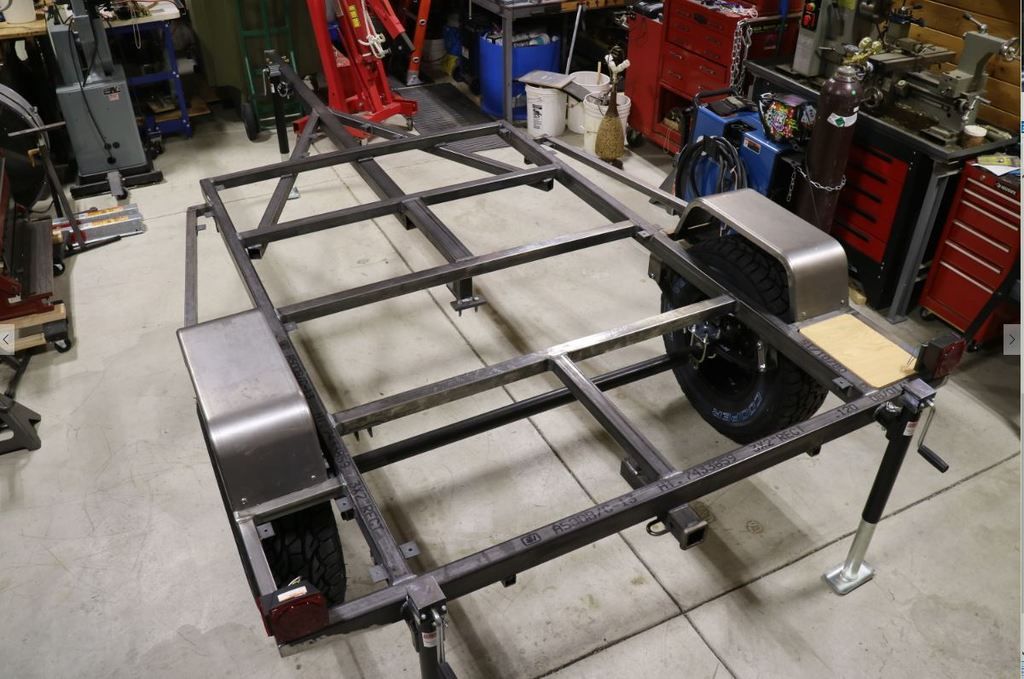

Postby justageorgiaguy » Tue Jan 19, 2016 9:45 pm
Dumb question, what's' that round port/mount?
James Davidson
Photographer
http://www.jdavidsonphoto.com
justageorgiaguy
Posts: 79
Joined: Wed Aug 04, 2010 8:50 am
Location: Cochran, GA
Postby roamer » Tue Jan 19, 2016 9:51 pm
Those are for pipe mount stabilizer jacks.
They are nice because you can put the jack down, at 90 degrees for travel, or remove it all together.
I have three of them on my off road utility trailer.
Dave
If you think you can't, you won't
138765
roamer
Posts: 94
Images: 25
Joined: Wed Sep 03, 2014 4:56 pm
Location: Where the sun meets the rain
Postby justageorgiaguy » Tue Jan 19, 2016 9:52 pm
Gotcha, I wondered if it was for a table, but the jacks make a lot more sense
Postby jkidd6339 » Tue Jan 19, 2016 11:02 pm
I have 6 1-1/4" receivers 4 on the back and 2 up front to mount tables or any accessories that I come up with. I figured that I could use the jack mounts to mount other things as well. I think I could get away in most cases using just 2 of the jacks.
Postby jkidd6339 » Sun Jan 24, 2016 1:31 am
Trailer frame is finished and ready for paint. Let the sawdust begin.
