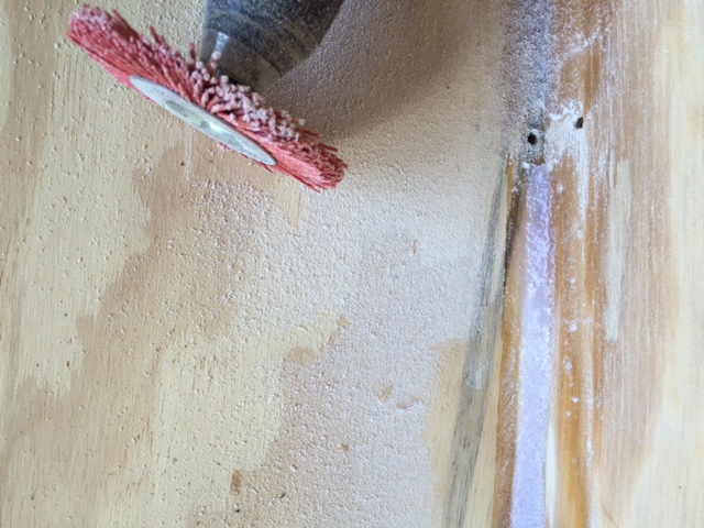

when working w/ pox i mixed wood flour not saw dust in it for a thickener
https://duckworks.com/wood-flour/
the four mixes more thoroughly/evenly and the color is more attractive to me
fillets are easy to contour now that i found this abrasive wheel
https://www.harborfreight.com/4-in-80-g ... 60325.html
get a couple of the 4" ones as they do wear down
when run diagonally along the initial fillet the 80 grit in the nylon bristles makes short order of fairing leaving a nice concave result
knocking the sheen off.jpg (136.51 KiB) Viewed 1421 times
