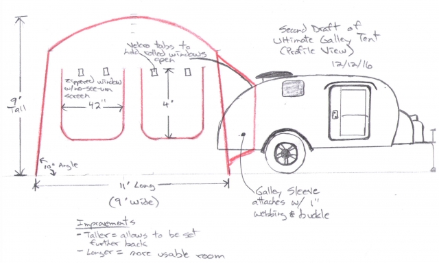

First Draft Profile Sketch
Postby Dusty Mark » Mon Dec 12, 2016 10:14 pm

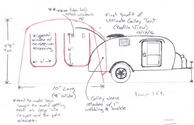

Here's the first draft profile sketch. I originally thought I might skip this step, but I'm glad that I'm taking the time since it is highlighting some areas of concern with my design.
The 10 degree angle on the legs is needed to keep the tent stable, but it sure robs usable space. I may need to increase my dimensions one foot each direction in order to yield enough usable square footage. This could cause me to run short on my tent poles, but I'll determine that in a little bit...

Second Draft Profile Sketch
Postby Dusty Mark » Mon Dec 12, 2016 11:50 pm
Here's my second draft profile sketch.
I made the tent taller to accommodate moving it further back and therefore wasting less floorspace. I also sketched it at 11' long. I messed up in my original planning and need to order more tent poles. I can't move forward without the poles since I'm draping the material over the poles and pinning out my design as I go. :roll:

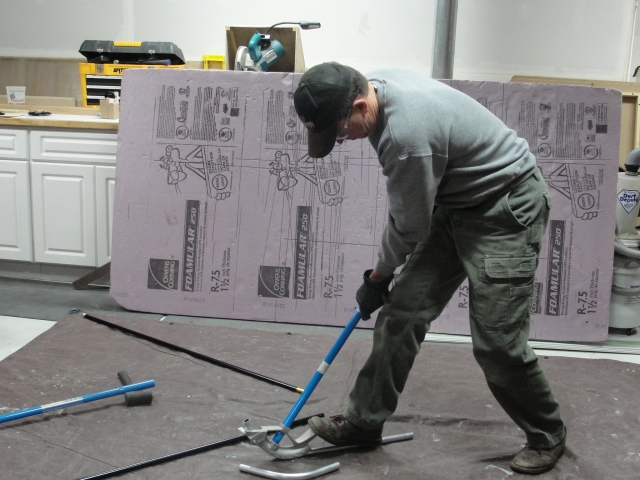

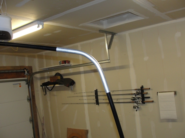

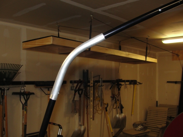

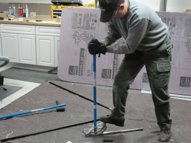

I began fitting the tent poles tonight. The first step was to set grommets into an old tarp that were spaced the same as the grommets in the final product. I then began to bend the aluminum tent poles with a conduit bender.
NOTE: Easton's anodized aluminum tent poles won't take these kind of bends. My first attempt snapped and one of the pieces flew past my face. It was one of those rare instances that I didn't have my safety glasses on.
Not to worry, I had 7/8" diameter softer aluminum pipe scraps from building three layout boats last year. I know that this material takes a bend well and is plenty tough. The duck boat blinds have two seasons of hard use and the aluminum has held up well. Thankfully, the 3/4" tent poles fit inside the 7/8" aluminum pipe with a perfect fit.
Finishing the prototype bend.
Here's the transition from leg to ceiling.
I need to bend the final corner pieces about 5 degrees less in order to put a bit more arch in the roof. I'm able to purchase the 7/8" aluminum pipe locally, so that won't be a show stopper. The rest of my poles arrive tomorrow afternoon, so I should complete the frame tomorrow night. That leaves the weekend to start sewing!

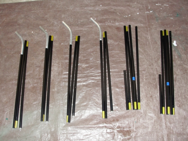

Tent Poles Done
Postby Dusty Mark » Thu Dec 15, 2016 6:34 pm

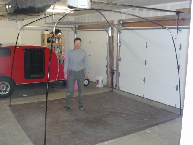

I completed fitting and shock cording the tent poles today.
The poles are a lot easier to deal with now that they have shock cord installed.

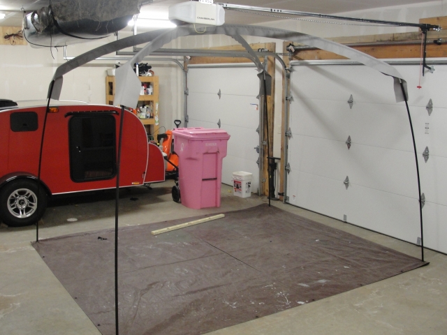

Having reduced this angle, the roof has more of a rise. I played with this angle and the overall length of the cross pieces to get the desired rise. I plan to run and tighten small cords across both diagonal spans to increase tension in the frame while fitting the tent panels. This pretensioning will allow me to be a little loose as I pin the panels together and then the whole tent will tighten up around the frame after releasing the cords.
I'm pleased with the results so far. Tomorrow night I'll reassemble the frame and begin fitting and sewing the sleeves that connect the tent to the pole frame.

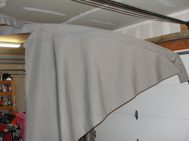

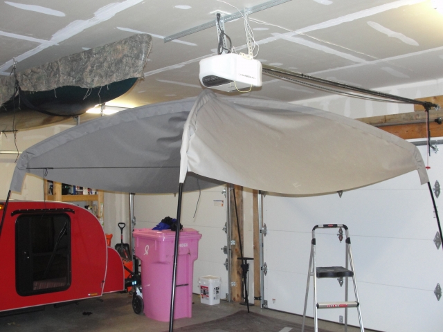

Fitting the roof is the most challenging part of the project. I'm not using a pattern, so I'm just test fitting panels and clipping them up one at a time.

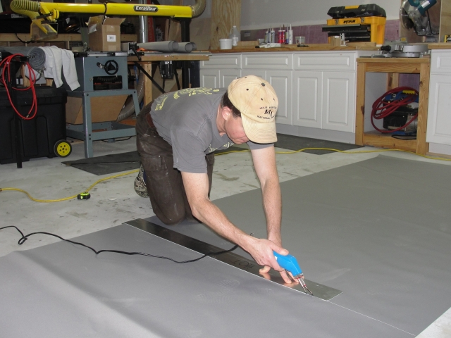

A hot knife is a "must-have" tool to prevent fraying of cut edges.

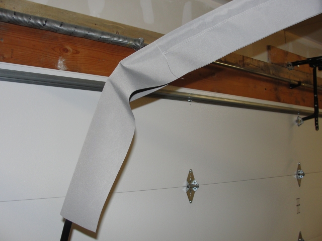

The tent body is suspended from these sleeves.

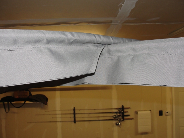

The sleeves are continuous to make pole insertion easy. UPDATE: Do not sew the seams for the sleeves tight like this double row of stitches that you see in this photo, the poles will not come out once the tent is assembled. Sew a seam at the far end of the sleeves to hold them together during panel fitting. Once the roof is completed, the only thing holding the sleeves together are the seams from the roof panels. I finally left one seam continuous and split the other open to bridge the continuous sleeve.
The transition from leg to roof arch. I didn't bother making an angled sleeve. I'm okay with some puckers in the final product. UPDATE: Put darts in now and make your sleeve angled. Also sew a hem at the bottom of the pole sleeve that is even with the bottom of the angled piece of aluminum pole. This is also a good time to sew in your webbing and tie down rings for the guy lines.
Panel going up for a test fit.

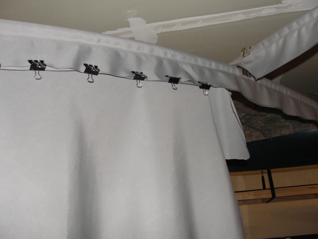

Binder clips work great for my "trial and error" panel fitting method.

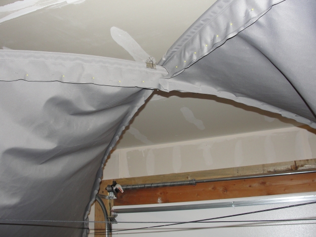

Two opposite panels pinned in place. A lot of the sag will come out when the adjacent panels are installed. I'll also tighten the whole assembly by sewing above the pins. UPDATE: You might run a line along the lower roof line between each pole to drape the roof panel across during fitting. This would make fitting easier and help to avoid puckers in the panel.
Pins visible from inside the tent.
