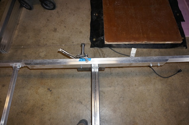

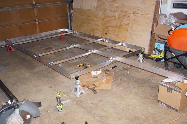

Someone wanted to see a better picture of the sister frame rail. These pictures should give everyone a better idea of where the sister is located in relation to the main rail and the axle. The sister is 4' long, so it'll add some strength and some flexibility in locating the axle for optimal tongue weight.
And a quick mock-up of the fender to see how much room I'll have for the door. The plan is to build as much of the trailer as possible before actually locating the axle so that I'll know the final weight distribution. I'll probably use some c-clamps to hold it in place until the very end.

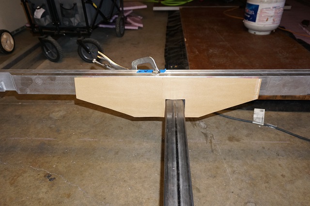

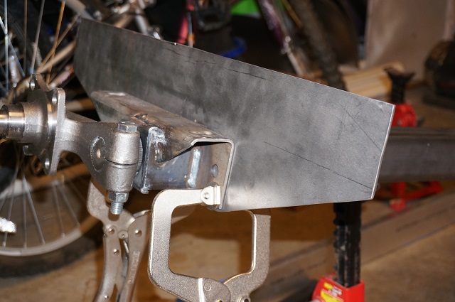

Making a pattern for the inside axle mounting plate. The axle manufacture sells a mounting plate for this axle that is about 1/3 this size. :frightened:

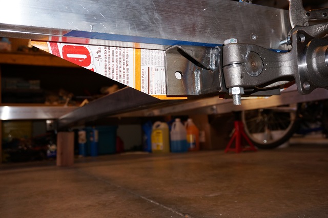

A shot of the axle mount and mounting plate from outside of the main rail. There will be a similar plate on this side, but I'll probably make an integral fender back that will tie in with the axle mount.

StrongFeather wrote: better picture of the sister frame rail. These pictures should give everyone a better idea of where the sister is located in relation to the main rail and the axle
Excellent, thanks all clear now.
Personally I'd shoot for being able to easily relocate the axle's longitudinal placement as desired even after the whole build is complete.
Heavy stuff like batteries, water tanks, propane bottles may be added or relocated later on.
I think your design allows for that if slightly modified. Put two cross-beams instead of one between the "sister rails", equidistant from the axle mount point, or even a third one at the mount point for plenty of anti-twisting stability.
This "inner frame" is fixed wrt the axle mount position.
Then the "outer frame" can slide back and forth, its cross-beams if any will set the maximum limits for that longitudinal positioning.
Fixing point bolts hold the the axle plate to both the inner and outer frame rails, as well as many as you like between the outer rail and inner "sister" rail.

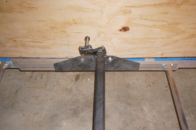

I think I’m picking up what you’re throwing down, John, and I realize that it’s hard to see what my final arrangement will look like with the pictures I provided, but I think it’s very similar to what you described if I understand you correctly.
What is not shown is two missing crossmembers (they’re each 2’ apart). Also, just to clarify, the beam you can see in the pictures above is the axle beam, not a floor crossmember.
Anyhow, that plate that is mocked-up in the pictures will bolt to the frame as well as the axle bracket (the part welded to the axle beam). If I ever need to relocate the axle, all I need to do is drill some new holes in the plate or make a new plate.
It’s hard to describe in words, so I’ll try to get some pictures in a day or two.

Postby StrongFeather » Fri Dec 21, 2018 10:59 pm
Hey all! It was a relatively productive Friday on the build.
The floor is finally laminated! It does have a slight bow to it though. I'm not sure why, but the first side laminated flat as can be, but the second side caused the whole thing to bow slightly (~1.5" over 10'). I don't think it'll cause any problems, and I'm hoping that it'll actually be beneficial by adding some pre-stress that'll help to support the front and rear ends of the frame - although I don't think it's necessary. I'll install with the crown down so that the stress will provide lift to the front and rear. If the bow is going to be an issue, it'll probably delaminate when I attach it to the frame, so we'll see. Here's a very unglamorous picture of her majesty. At some point, I'll lay the frame on it, trace the final size with a pencil and cut it to size with a circular saw before adding a layer of fiberglass and epoxy to add a little strength to the seams and waterproof the wood.
156939
I was also able to get the axle mounting plates done and mounted! Here's a shot of the first plate being fitted and bolted to the axle mounting bracket.
Here's the axle sitting between the frame rails (upside down) with both brackets. I plan on using 4 c-clamps to hold it in place until I have a better idea of the weight distribution, at which time I'll be able to locate the axle properly.
156940
This shot shows the axle plate sitting inside of the sister rail. It can slide fore an aft, so once the weight distribution is known, it will just be a matter of drilling holes to attach the plate to the frame rail and to install the last floor cross member.
And last but not least, the main tongue beam is pretty much done.
I really appreciate all of the input from everyone. I'm loving this build.
