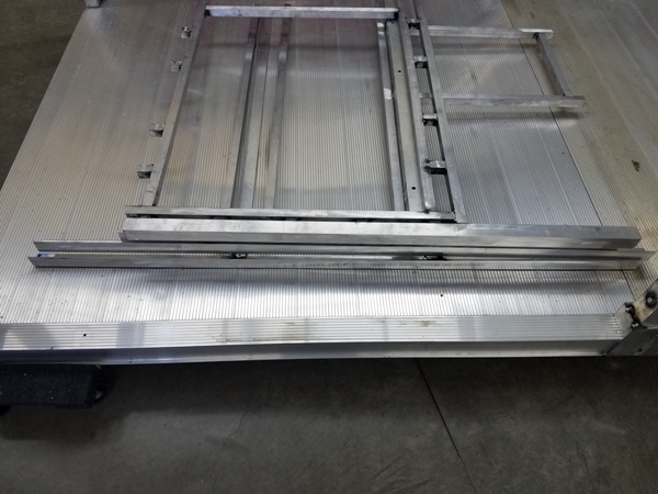

Postby twisted lines » Thu Feb 21, 2019 4:06 pm
Been framing in the doors, first is the entry door just the frame for my vintage door.
Second is rough frame for rear door, initial frame not finish welded and still moving way to easy so adding more mass to it, long way to go before I will be comfortable rolling it on the sides to finnish welding, grinding, sheeting and fiber glassing.
Last one is how tedious it has been to get fit for the 1/4" birch.
Entry door.jpg (118.37 KiB) Viewed 5824 times
Back Door.jpg (131.41 KiB) Viewed 5824 times

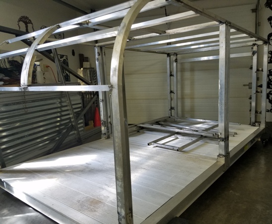

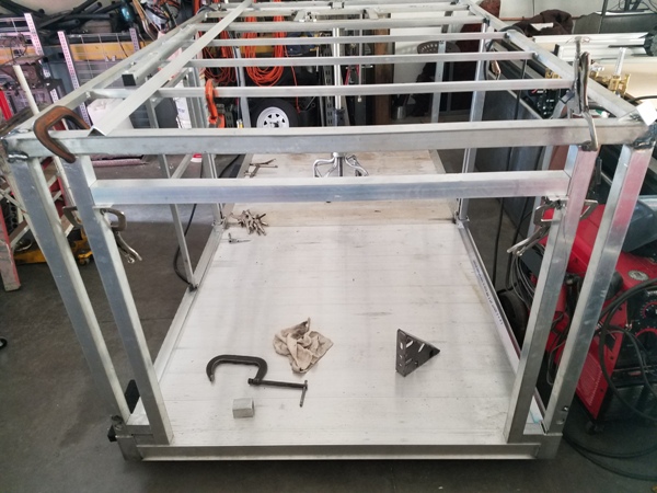

Postby twisted lines » Sun Mar 17, 2019 3:18 pm
Atomic77 wrote:In the off chance you do use it, you will need a gram scale. It's the only way it can be accurately measured out. And keep it warm
Sent from my SM-N950U using Tapatalk
Thanks I have the scales, and it Finally started to warm up :lol: I may still find a need.

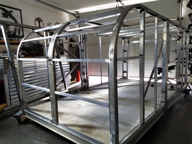

Weather is what I have been waiting for & the skeleton looks like it did in January, but its not; and the second picture is most of the wall sections I will be gluing on the bottom tomorrow, The floor is thin enough I don't even want to try any other methods.

Postby twisted lines » Fri Mar 29, 2019 4:35 pm
The rest of the wall's glued at the bottom, welded or at least tacked sides / top,

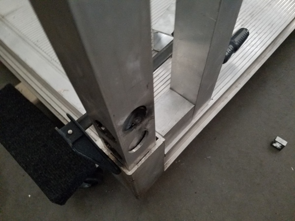

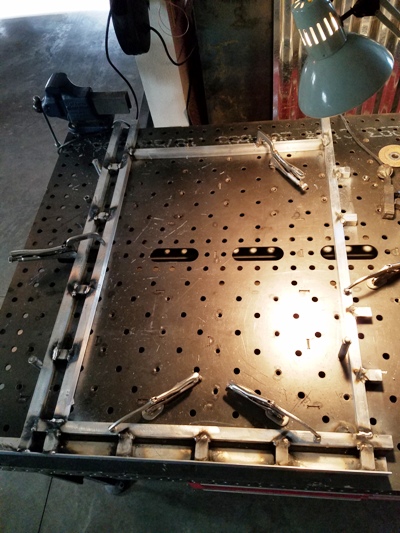

Postby twisted lines » Tue Apr 16, 2019 7:42 pm
And the back door delima shows it's self :roll:
Door frame looks ok but this makes it a good time to through the gloves & :beer: won't be much left in 1" Tube
First attempt stretching on the hidden inside door skin, & my dremel didn't help :lol: but it fit's now

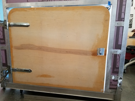

Postby twisted lines » Sun May 05, 2019 7:19 pm
Finally got somewhere with the back door but have a long ways to go :)
Rear door skin.jpg (78.16 KiB) Viewed 5555 times
inside door.jpg (73.94 KiB) Viewed 5555 times
Outside door.jpg (64.5 KiB) Viewed 5555 times

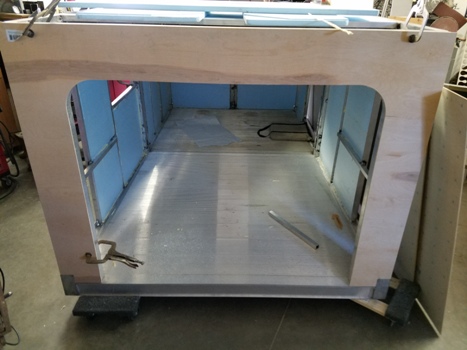

Postby twisted lines » Sun May 12, 2019 2:19 pm
Two sides a little closer :thumbsup:
My markings will always be out of line, Still planning on monstaliner over the top!

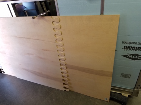

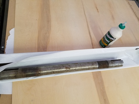

Postby twisted lines » Wed Jun 05, 2019 9:09 am
Progress is slow but getting something done, thought I would be applying today but forgot a couple things!
This job sucks
Finnish fitting.jpg (90.33 KiB) Viewed 5437 times
First wood.jpg (65.01 KiB) Viewed 5437 times
