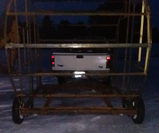

I did get the new axle mounted and it increased the track width from 58 inches to 89 inches, so it makes me feel much better about the stability. I also have been using machine screws to bolt 1"x1" strips of pine/spruce in the interior of the walls to have something to attach my 5/16" knotty cedar tongue & groove interior to.

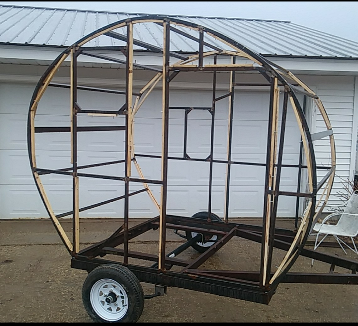

Postby Danomite » Tue Apr 02, 2019 11:15 pm
Well, I have been adding 1×1 wood strips for my interior t&g to attach to, and now that they are all in place I welded the skeleton to the trailer. The total height is 93 inches. This means the remainder of the work will be done in the pole building out back with 12 foot sidewalls. The garage has a 7 foot tall door, so it will no longer fit in there.

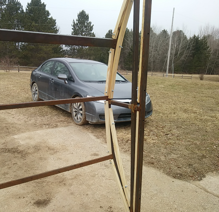

Postby Danomite » Tue Apr 02, 2019 11:26 pm
In case I need to further clarify the idea of the wood strips, I took this pic. The aluminum skin will be pop-riveted to the steel skeleton, but the interior t&g cedar will be attached to the wood strips with a crown stapler.

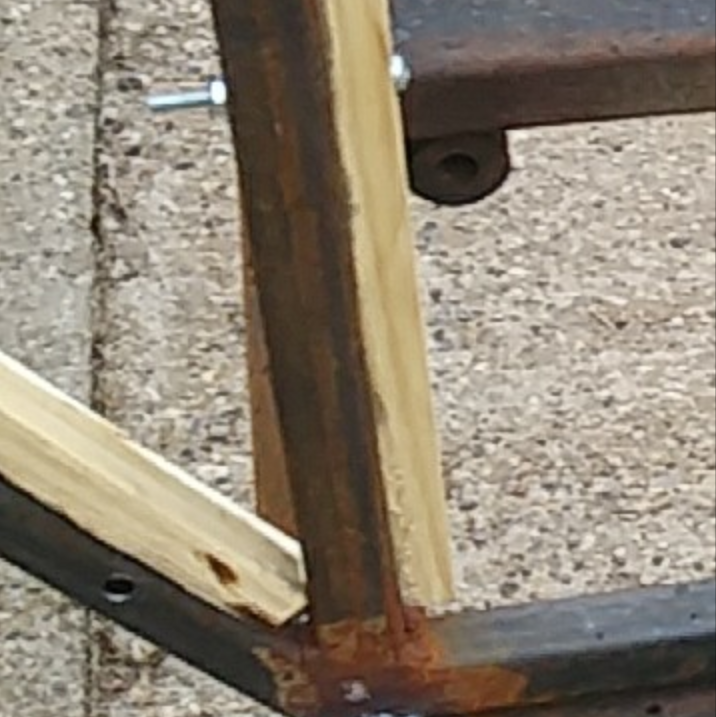

Postby Danomite » Tue Apr 02, 2019 11:41 pm
And a close-up of the strips that have been bolted in with 10-24 machine screws. In the length of the walls it isn't necessary to hide the heads, but in the corners I drilled my 3/16" holes thru & then drilled a 3/8" hole thru the outside of the tubing so that the head of the machine screw is actually inside the tubing & not being a bump in the exterior to be in the way of the aluminum skin.
There have been 2 rather important things I have learned in this process so far:
1. Not all $5 (3/16") drill bits are created equal. The best one I've purchased so far was from Advanced Auto Parts. Century brand.
2. Use a 2 speed drill. I was using my cheapie Black & Decker rechargeable single speed and it was slow going. Tried the 2 speed Dewalt rechargeable and I won't be using the B&D anymore on this project!

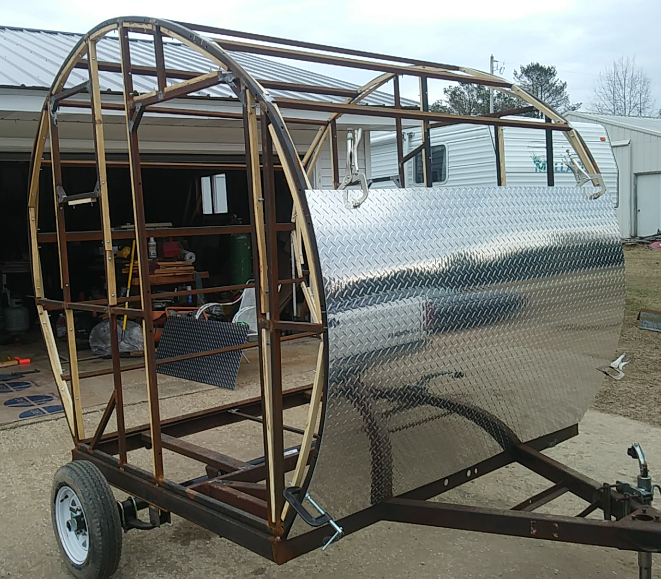

Postby Danomite » Sun Apr 07, 2019 11:38 pm

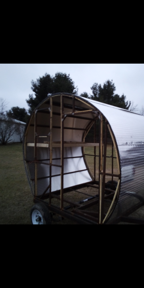

And a test fit of the aluminum diamond plate. Now I need to find a local fabrication shop with a sheet metal brake over 74 inches to bend the edges for the overlap joints.

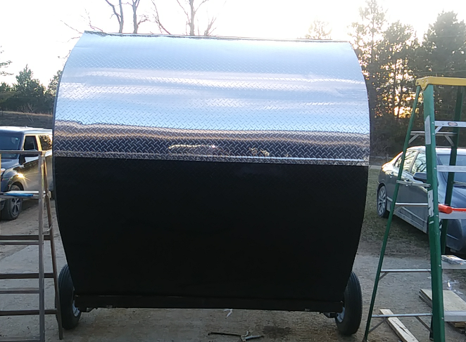

Postby Danomite » Mon Apr 08, 2019 7:56 pm
Started actually installing the aluminum today. The sheet of black diamond plate at the back is so cars coming up behind don't get blinded by their own headlights.

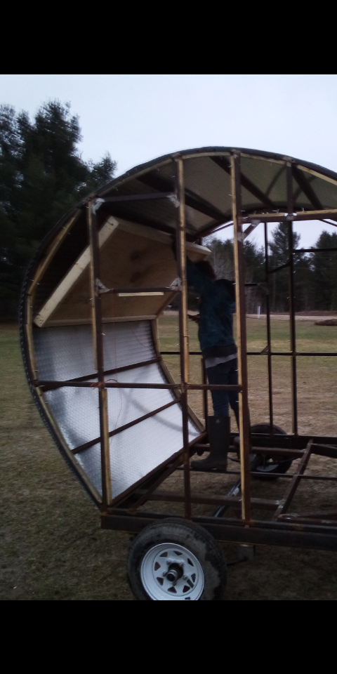

Postby Danomite » Thu Apr 18, 2019 7:48 pm
We had to install the upper bunk before the sidewalls were put on. It is piano hinged to the steel tubing framework.

Postby Danomite » Thu Apr 18, 2019 7:53 pm
The (future) lower bunk will also be the dinette, so the upper will be swung up out of the way when it is being used in dinette mode.
The floor will be the next step, then skin the sides, insulation, and then on to putting up the knotty cedar inside.

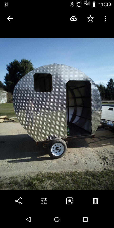

Re: Central Michigan Canned Ham

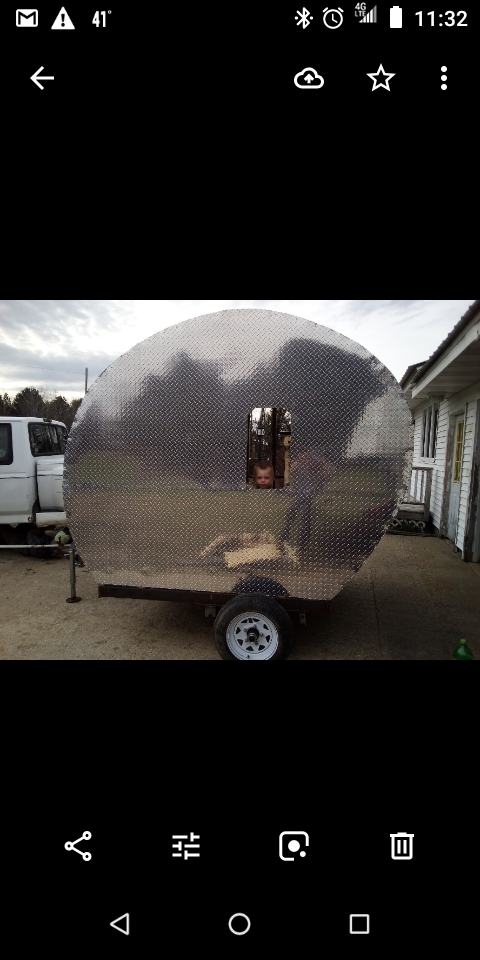

Postby Danomite » Fri Apr 26, 2019 10:10 pm
BTW, my apologies for these last 3 pics, I dropped my old phone one too many times, so I got this new one, and quite frankly, it sucks. It has no cropping ability.
Ok, well, I got the driver's side skinned. And even got Grampy's little man to pose in the picture.
I believe I will have to get insulation in the walls and get the t&g cedar hung before I can install the door & windows.
Postby Danomite » Mon Apr 29, 2019 9:39 pm
And the passengers side is now skinned. Also, I got on Etsy & ordered a handmade awning today.
