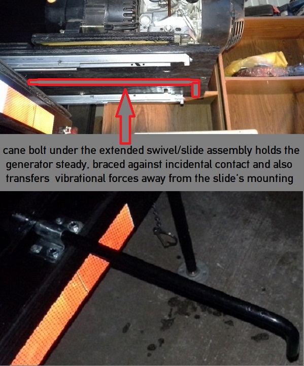

Jeremiah worked on the sliding mechanism for the galley cooler. We went with a rather large 9-day cooler that had some difficulties fitting under the counter height we needed. So to put the sliding channels on the floor with a board on top of those wasn't working.
Jeremiah came up with a neat idea, but he ran into a little more work than I think he was expecting. He cut channels in the 1/2" floor ply to fit the slide bars down into. Then he slid some 3/4" ply pieces underneath the floor to screw the slide bars into, creating a countersunk slide mechanism.
He cut a 1/2" piece of ply for support on top.
We are having a little trouble getting it to slide well, and are worried about it being able to handle the weight of our cooler. The slides are rated for 100lbs, but there is a lot of resistance when it is extended. We may end up putting a support chain from the wall to the slide board to help pull up the slides when they are extended.
Any advice is welcome.

Postby working on it » Mon Aug 12, 2019 10:55 am
kristaology wrote:...
Sent from my LGL83BL using Tapatalk
* I have an on-board generator mounted on a swiveling slide-out in the galley. I pull it out to the full 21-inches that the (new) Blum slides allow, then turn it (and lock the swivel in place with a pin), so that the exhaust points out safely to the right. However, I previously found that 85 lbs on a triple set of drawer slides I used (100+ lbs rating for the three), at full extension, could be too much weight if additional loading occurs (I accidentally pushed down on it at home). When I replaced the first set with better slides, I also made a hidden support arm that inserts into a slot under it, and there's no problem with extra weight on it. I used leftover hardware to fix the problem, but I also considered just using a simple jackstand, to support it (I have several extra ones in the garage). But, I like modifying/re-purposing stuff, whenever I can.
generator support plan.jpg (140.33 KiB) Viewed 6491 times
* If there's room underneath the cooler slide-table and the slide base, you could use a simple piece of leftover plywood inserted there to help support the weight. That was my first idea, but I had no piece available at the time. I didn't think of the jackstand idea, until later. Here's a link to the thread where I made mine: http://www.tnttt.com/viewtopic.php?f=2&t=59704
173193172890148599
