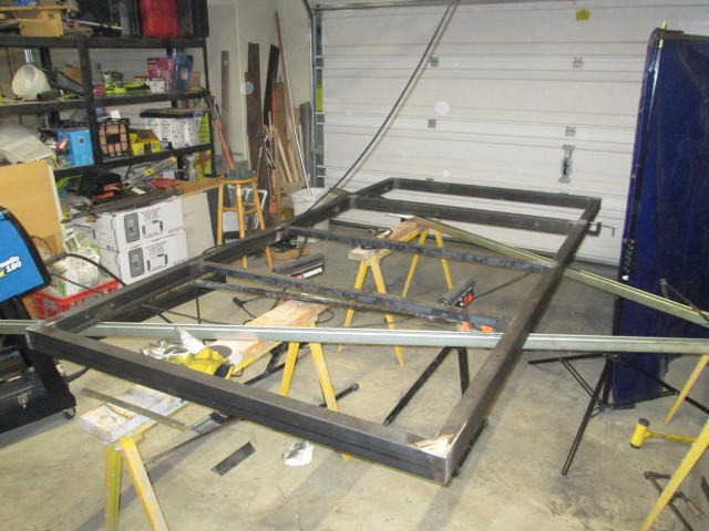

Made some good progress last weekend. Need to get back in the garage to try and get this frame finished...
Today I'm picking up some special order 3/4" rigid foam (foamular) that I was able to track down. I also met with a guy (friend of a friend) with a 5x12 CNC table :shock: . After seeing his shop, I think I'm going to go very CNC heavy on my design. Sidewalls, roof rails, hatch rails, cabinets... My hope is that by adding tabs/slots/etc, the primary structural elements will self align and make assembly go much smoother. CNC time comes at a cost, but the method appeals to my engineering side and will hopefully save me a ton of time.
Thinking about how to paint/finish this frame - any suggestions?
But for now, still lots of cutting, welding, grinding...

Well, I haven't posted any updates for a while, but I made some more progress on the trailer.
I haven't been in the garage much because I've been finalizing the CAD for the sidewalls and cabinets. Data is sent to the CNC shop and I should be posting some pictures of that soon. I'm excited to see how the CNC parts turn out - I think it's going to make the next phase of the build really fun!

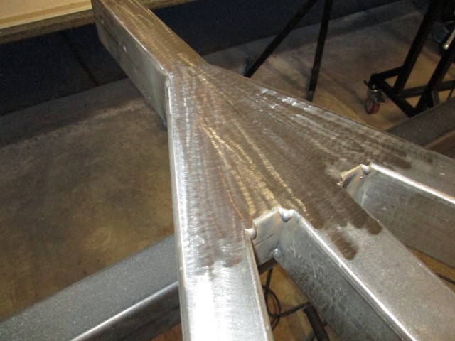

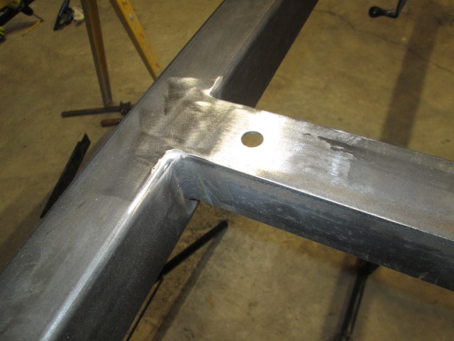

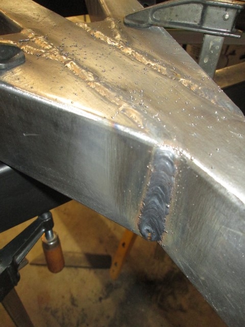

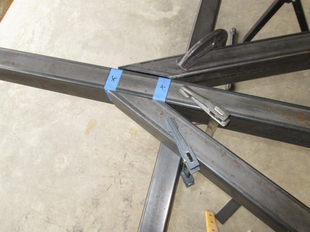

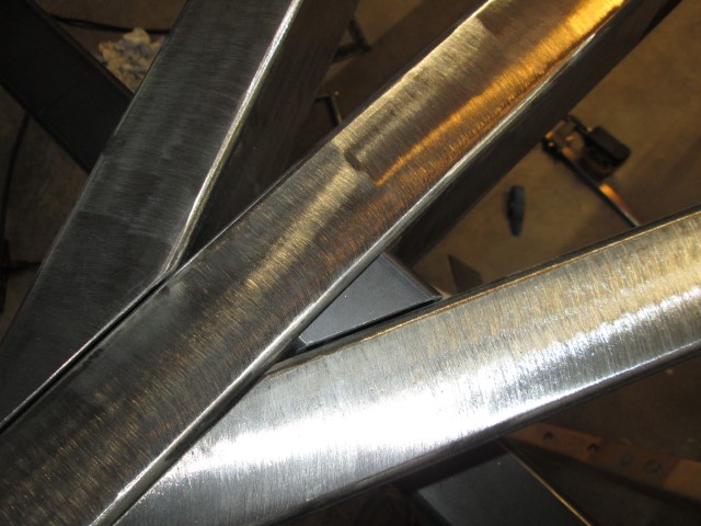

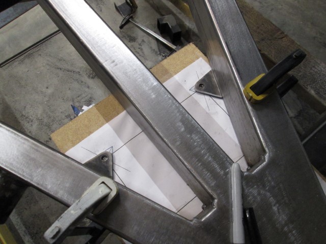

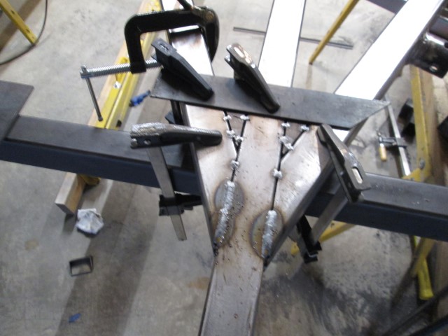

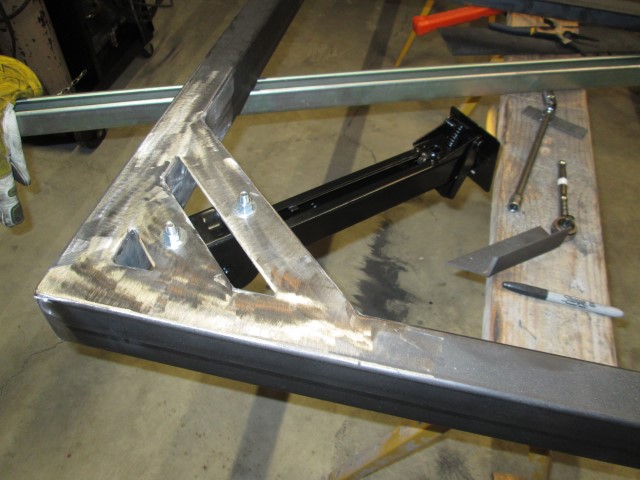

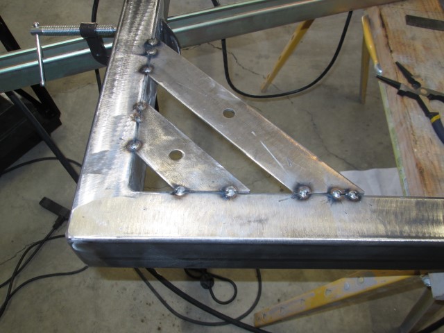

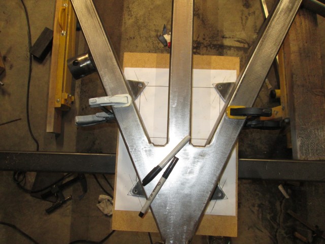

Last weekend I added some stabilizer brackets to the main frame and started laying out the 50 degree composite tongue. The stabilizers are tucked up into the web thickness of the frame so they don't get caught on anything if I drag the rear end. They'll be clamped through the floor and steel flat bar braces, and to really over engineer it, I added some L brackets to increase the stiffness on the longer braces. They required a small custom cut to allow the stabilizers to fold up flush. A little fiddly to build, but I'm happy with how it turned out.
At first I was confounded by the extreme angle of the cut for the composite tongue braces as they come into the straight tongue - I wanted to cut the angles on my horizontal bandsaw, but at 65 degrees it was just beyond the limit of what the saw could do (I tried taking off all of the guides to see if I could just clamp the tube to the base and still clear the arm). In the end, I just measured twice, clamped a straight piece of scrap steel the the tube and went at it with a metal cutting blade on my angle grinder (first one side then flip for the other). It turned out better than I hoped and shouldn't have cause me so much stress. I also cut some little triangle wedges to fill the acute space so I can weld inside the corner. It looked too tight to get a good weld otherwise, and the wedge buys me some space. Just planning to weld across the top and bottom triangle and then the new back vertical edges.

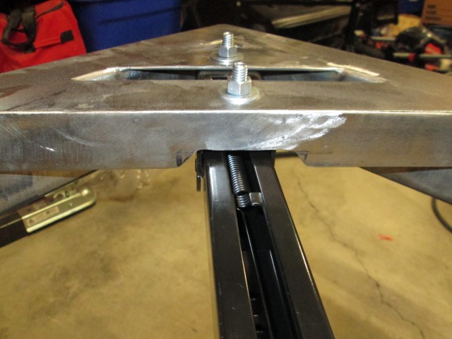

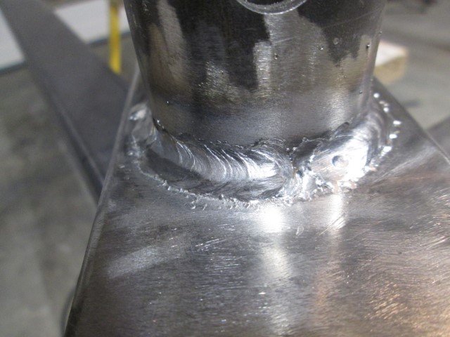

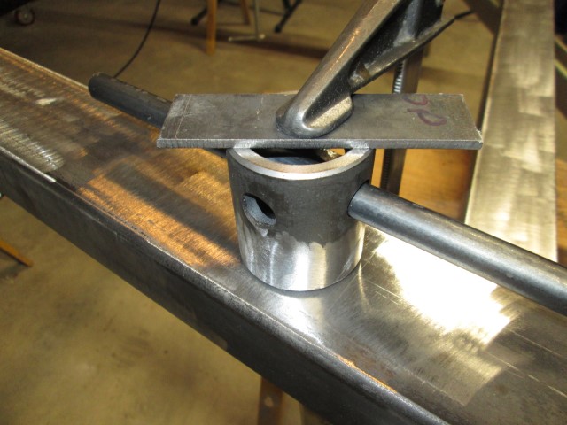

Also welded on the pipe for the pipe mount tongue jack.

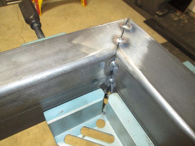

This week I'm hoping to finish welding up the tongue, flip the frame and weld the underside, weld the tongue in place and hopefully receive my axle... :worship:

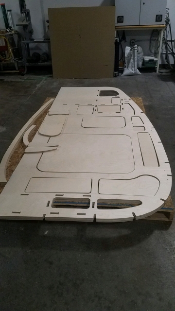

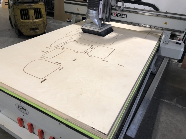

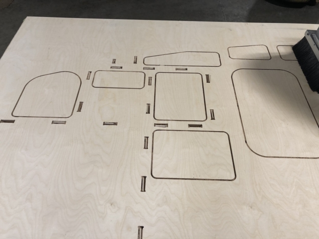

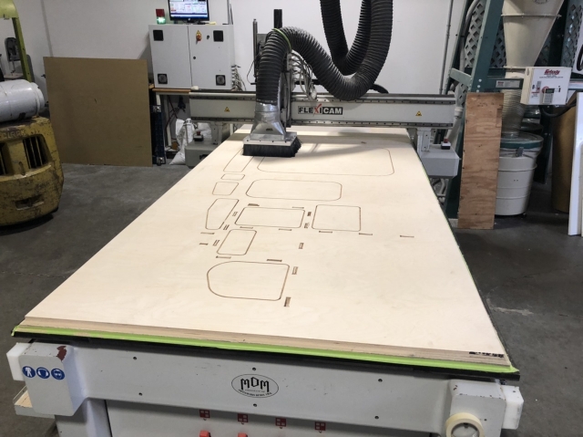

Postby uberpixel » Tue Dec 15, 2020 3:48 pm
Here's a sneak preview of the CNC parts... :D
Forget about a Teardrop Trailer, my next obsession is that 5x12 CNC table... :shock:
Profiles are done - I think he's cutting my cabinets and hatch profiles today. I REALLY need to get that trailer finished and painted.

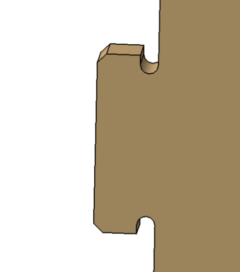

Postby uberpixel » Tue Dec 15, 2020 5:33 pm
twisted lines wrote:You did the hard part drew it.
Looks like dog bone's so you don't have to trim the corner's & 5' sheets?

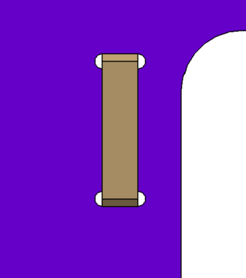

You got that right! Dialing in the design and all of the inter-related features, considering material and build tolerance, design for assembly and manufacturability, available materials, not to mention functionality and aesthetics... just getting to this point has taken more hours than I’d care to admit. :oops:
I’ve attached screenshots of the basic dogbone and tab geometry below. Both need to have special relief cuts to work with the CNC router so that there is no additional hand trimming required to square up the corners (as you mentioned). I've also used dado's in some locations (instead of the tab/slot) where I didn't want the tabs showing (cabinet face frames), but I like the positive engagement these tabs and slots will provide. Although it's all theoretical until I try putting it together. :thinking:

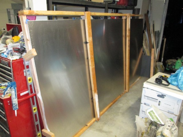

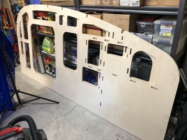

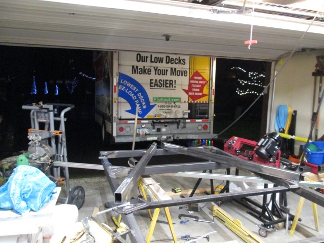

Biggest developments include renting a U-Haul big enough to get my 5x10 sidewalls home. I figured as long I have the truck I might as well get my 4 sheets of .040"x5'x10' 5052 aluminum and any other 5' baltic birch I might need. So I made an afternoon out of it and got it done. I've kind of been dreading the handling of those big pieces so it's a relief to have everything safely in the garage.
My first stop was for 13 5x5 sheets of BB plywood - those would go on the bottom of the stack. Next stop was for the 5x10 CNC cut sidewalls (while precious - they didn't seem particularly fragile). And finally the 5x10 aluminum sheets would go on top of everything. Seemed like a foolproof plan...
The aluminum was pre-packaged on a skid or pallet - so I pointed out the plywood sidewalls and asked the operator to be careful when loading. Unfortunately (maybe he was distracted by my request), on the first attempt at loading the aluminum, the forklift operator bumped the corner of the stack on the back of the U-Haul. He proceeded to line it back up and start putting in the truck, but I quickly flagged him down and asked if I could inspect the sheets. As you could imagine, all 4 sheets were bent. I considered offering to take them at a discount, but unfortunately I have at least one area where I need a full 10' piece without interruption. Fortunately he went and grabbed me 4 fresh sheets without an issue. They were loaded "loose" with no pallet or skid. This made it easy to load and since I don't have a forklift at home was probably the best option for unloading.
While driving home, I started worrying about how I was going to unload the sheets without damaging them. I guess desperation breeds innovation (or whatever the saying is) and the idea of a simple cradle popped into my head. I made a quick stop at Home Depot to buy a few 10' sticks of lumber (another good use for the U-Haul). I thought I took some pictures of the cradle in use, but I don't seem to have them. Basically, it's a simple rectangular frame 10' long and 5.5' tall with a few cross-braces and a stop block on one end. I propped the frame on the bumper of the U-Haul and with the help of a neighbor we slid each piece of aluminum on the frame. Then I secured a couple of 2x4's on top of the frame to keep the aluminum from falling off when I propped the frame on it's side.

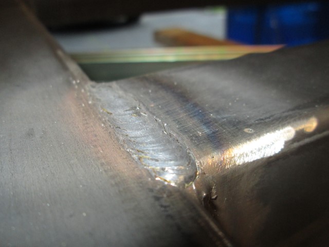

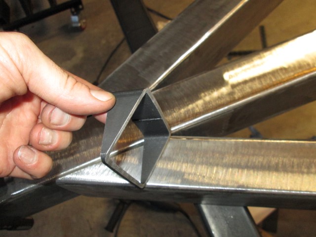

With all of that stuff safely unloaded I got to work on finishing up the tongue for the trailer. You can see in the pictures how I managed the tight welding access created by the composite A-frame tongue by adding a small wedge piece. This was actually cut from a scrap piece of 3x3x0.120 since the extra inch (all I had on hand was 2x3) gives a little more width for the MIG torch. I'm going to wait to do the final vertical welds in the narrow section until after I weld the tongue to the main part of the frame. Even though I had it clamped to the frame, it was already starting to pull the braces inward due to the heat from welding. Those inside corners are the worst for that phenomenon so I don't dare weld them until the braces are welded solid to the main frame.
