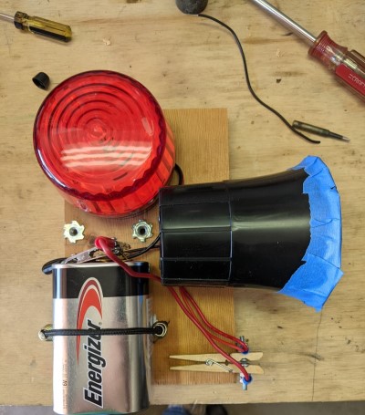

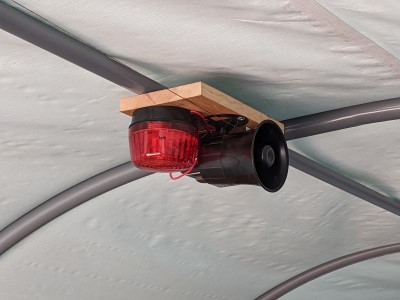

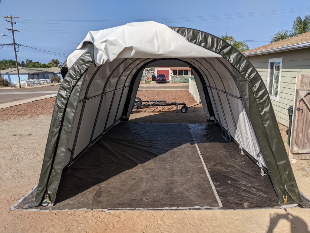

Not much progress being made over the past few weeks due to some health issues. I have made some advancements in support systems. I needed to move the operation inside so we purchased a 12 x 20 x 8 carport. I also made a trip alarm since I live in an area that warrants the protection.
Hopefully construction will continue soon.

DIY Alarm
Proximity trip alarm.jpg (172.13 KiB) Viewed 1418 times
Alarm installed
Trip alarm set.jpg (93.8 KiB) Viewed 1418 times

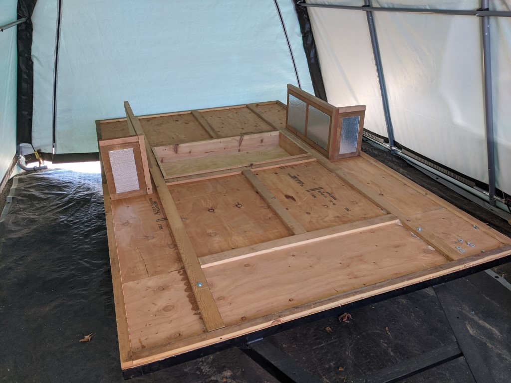

I have finally been able to get back to work on the project. Here are some of the highlights of the progress I have made.
First was the completion of the tank cradle. It is only going to be an 11 gallon tank, however, that is 91 pounds full and will be the lowest part of the camper and closest to the road. It will also be covered with .040 aluminum.
Tank cradle welded in. Don't look too close. I learned to weld this year.
Tank Cradle.jpg (207.55 KiB) Viewed 1280 times

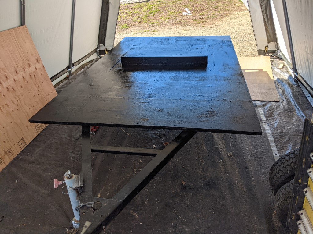

Next I installed the water tank box. I will not be installing the water tank and pumping system with the initial build due to cost. With rising costs on everything the whole water system is too expensive. Should have bought it all back in 2020. :cry:
Floor with water tank box installed. Finally!
Floor with tank box.jpg (165.01 KiB) Viewed 1280 times
It feel really great to be back to work on this. We hope to have it done for a vacation in September.

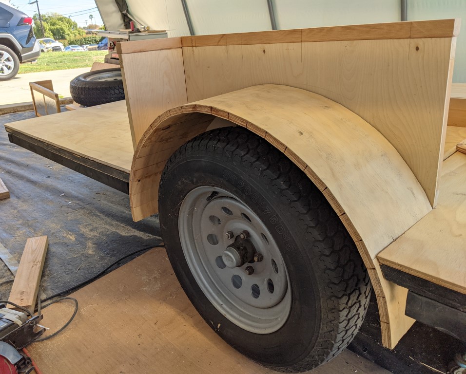

Finally made the critical cuts into the floor for the fenders. I have been working toward this part with great anticipation. The underside of the fender wells and the side walls will be covered with .040 aircraft aluminum. I was concerned about the tire clearance. What do you think? I have figured out how I would increase the clearance but it would be a bunch of work (rework). I will be performing some weight test along the way.
For a Dexter torsion axle, I build in 4" of clearance. And that's before I add the cabin (weight) to the chassis.

Thank you Tony. I spent a long time in SketchUp working on that design. When I get back out to the project I will measure. I think I am maybe at 4", possibly 3". This is the time to fix it before I go further. I have done lots of woodworking but nothing that had to move down the highway!
