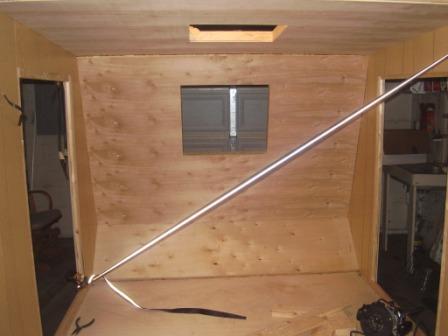

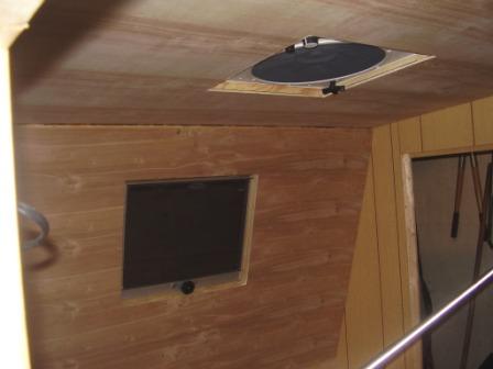

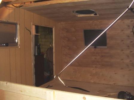

Postby Alfred » Thu Sep 17, 2009 9:46 pm
Hey Gang,
In keeping with Aunt Miriam's sage advice that if I do even just a little bit on the camper every day, I will at some point arrive at the end of this journey...
Tonight, after a long day of attention to other things, I went down and cut the opening in the ceiling's inner skin where the Fantastic Vent fan will be...
Having finished the cut, I couldn't resist dropping in the vent and popping in a couple of windows, to get a peek what it might look like when it is done, and daydream about camping in it for a few minutes...
AL in Asheville :thumbsup:

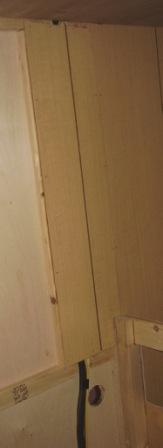

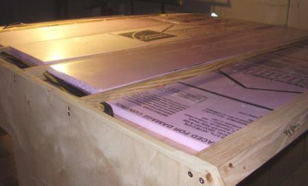

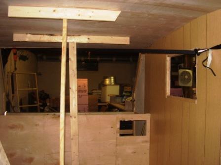

9/19/09 Update
Postby Alfred » Sat Sep 19, 2009 9:12 pm
Hey Gang,

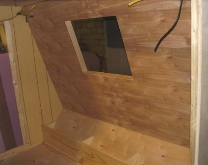

My friend David from the T&TTT forum came over today and we spent the afternoon camper building.
The rear inner skin is glued in place and propped with supports for drying. This means most of the inner skin work is done.
Quite a bit of the insulation is done. Used two layers of 3/4 in" to make 1 1/2" of insulation in the ceiling. I am going to use foam spray insulation to fill the gaps, including where the wires are running.
This is a picture where the wires leave the ceiling and run behind the wall to the electrical box area.
In the front, started working on a small bin storage area/shelf below the front window. This also acts as an additional front bulkhead. We are also working on a shelf above the window, which will have the 110v plugs and the 12v plug.

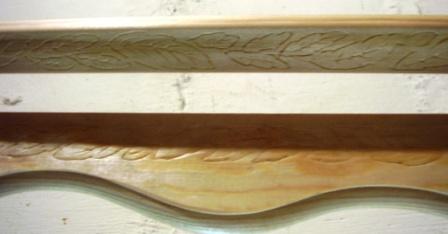

This is some very nice trim I picked up at Home Depot, which I am going to use on the front shelves and bins.
The camper continues to come together. The kids came out and 'helped' some this afternoon, too. All in all a very nice day!
