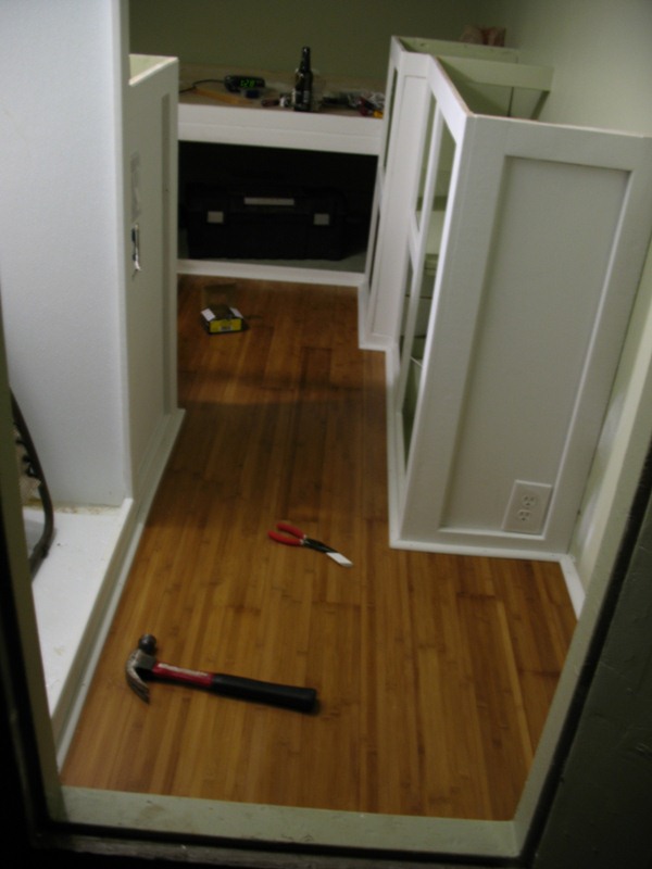

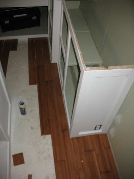

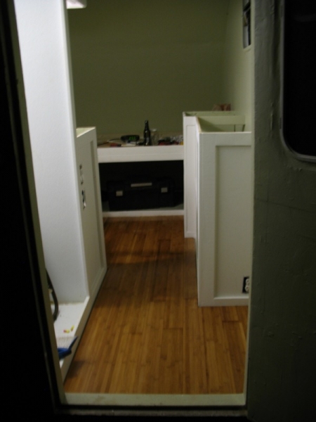

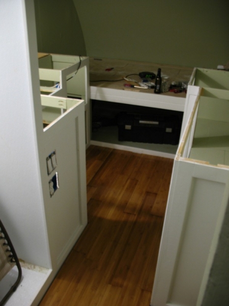

Sunday I recovered, but did get a bit of progress. I went ahead and put in the flooring Sunday and finished Monday night:
I've realized all my image quality is really poor because I work at night, after work... Or in the evening, after recovering from the night before. :roll: Since I have to go to the 9-5 grind, I'm stuck with crappy pictures for now. I did manage to get some pictures in the daytime today though.

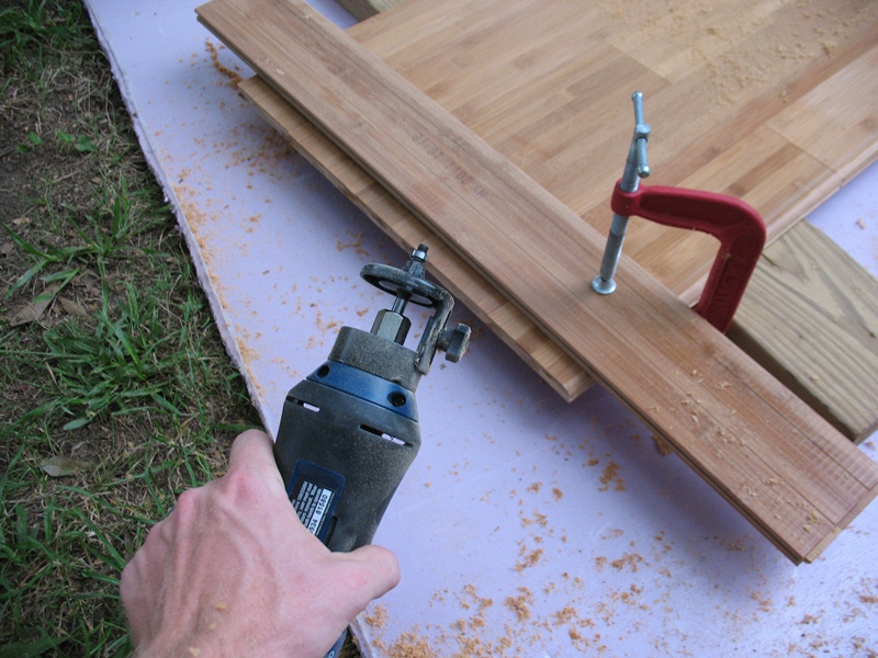

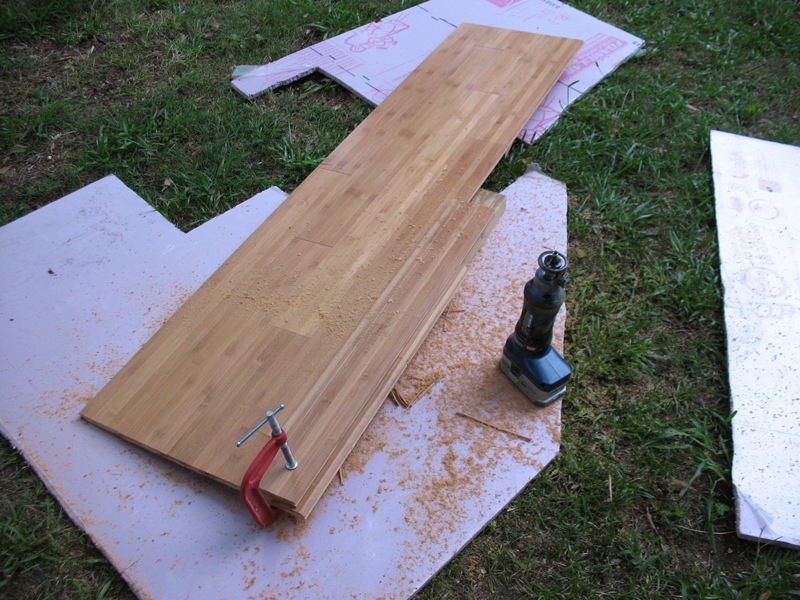

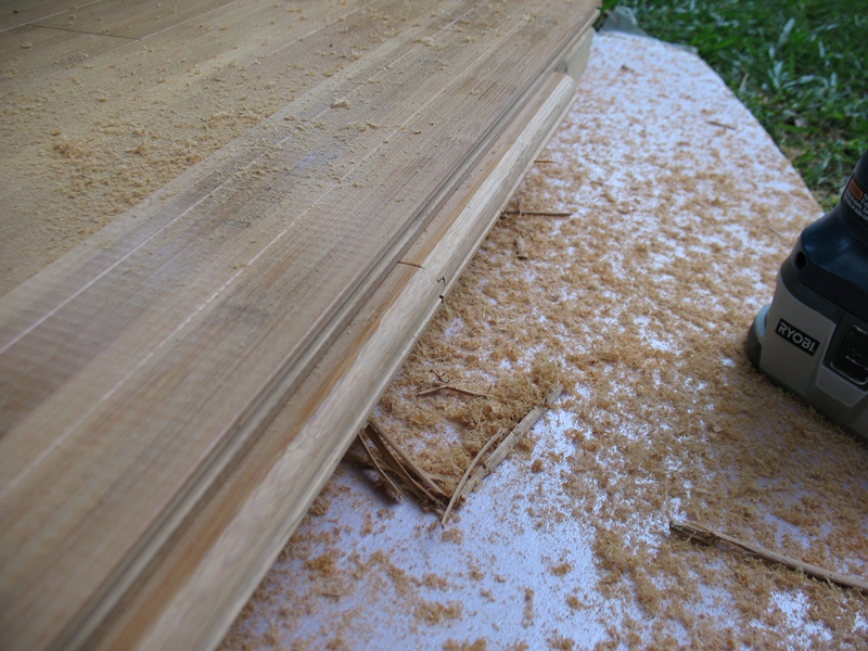

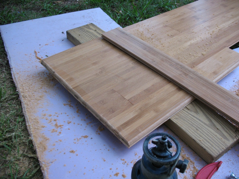

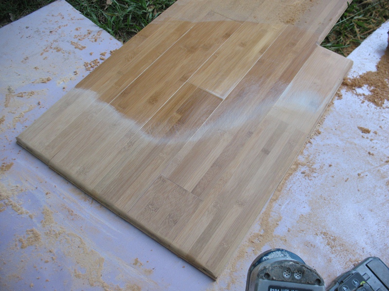

I figured I should finally finish the edges of the countertops (the tongues and grooves were exposed, and the pieces weren't all perfect), so I cut them evenly, and started rounding off the edges with my router.
I set up a fence to help stability, to make sure my routing is more consistent. I'll have to sand it all down and smooth anyways, but less sanding is always better. :thumbsup:
My tool of choice is my trusty router, the same one I used earlier in the build with a flush trim bit. Now I'm using it with a rounded-off edge bit.

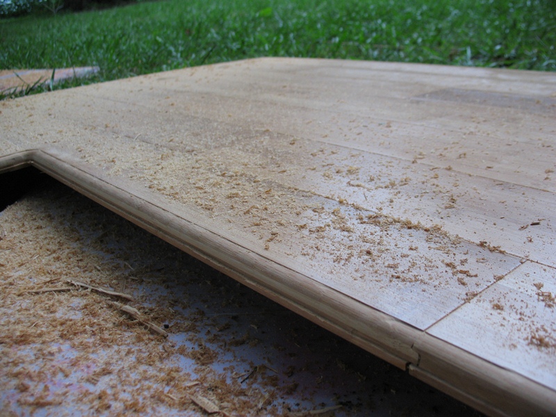

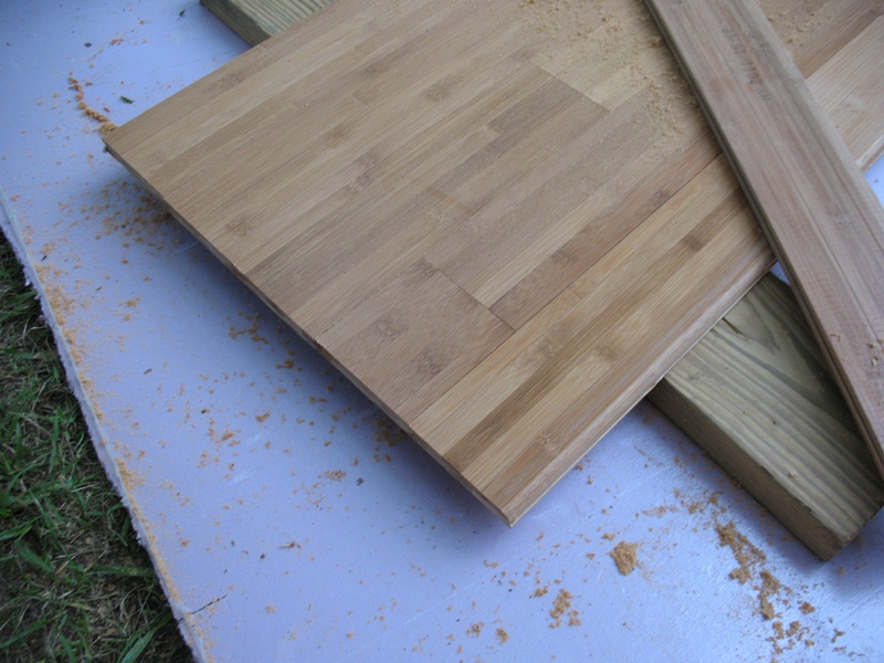

Next edge:
Nice and smoooooth:

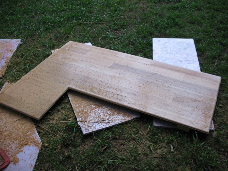

And do the other countertop:
Close-up. Good quality, lotsa sawdust. :thumbsup:

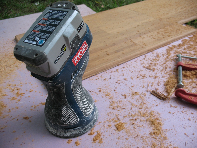

Next, time to sand. I'm using my trusty random orbital sander, my well-used weapon of choice. :twisted:
Phew, I needed rougher sandpaper. This is a battery in. I'll have to finish the countertops tomorrow, my hands are too shaky to finish this.
I spent the rest of my evening putting toe trim on the floors, to make the edges finished. It turned out okay, I'll have to touch up some spots with paint.
