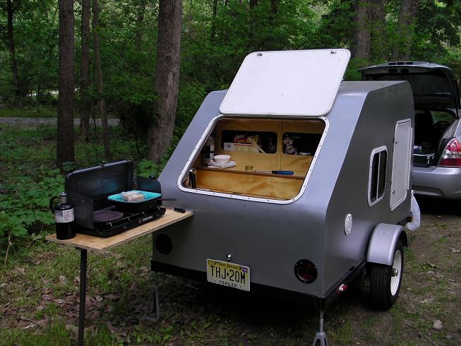

I knew when I designed the back hatch, that it was going to be a weak spot as far as waterproofing goes.
Well, it's been raining for two days now, and I have water in my galley. I have the hatched sealed with both butyl and silicone, and the leak is coming around the door, not the frame. The factory gasket is pretty wimpy, so my first attempt at fixing the leak will be to replace that gasket with something heavier.
I have already drilled two weep holes at the base of the frame so water won't collect there. If the new gasket doesn't work, I'm trying to come up with alternate plans.
The interior is totally dry, so the roof vent, windows, and entrance door are all functioning perfectly.

Well.. 2nd camping trip this weekend, and the new weatherstripping on the rear hatch and the modified drain holes solved the leak!
I did have a little wicking of the luan at the bottom because I haven't sealed up the bottom yet... duh! I'll let it dry out before I caulk all those gaps.
I only forgot one thing this time :cry:
Eggs!.. but I had two delicious pork roll (Taylor's Ham for those in the know) sandwiches to make up for it.
The Picnic stove wouldn't work with the cabinet I built for it, apparently there wasn't enough air flow, I took it out of the box, and it worked flawlessly.

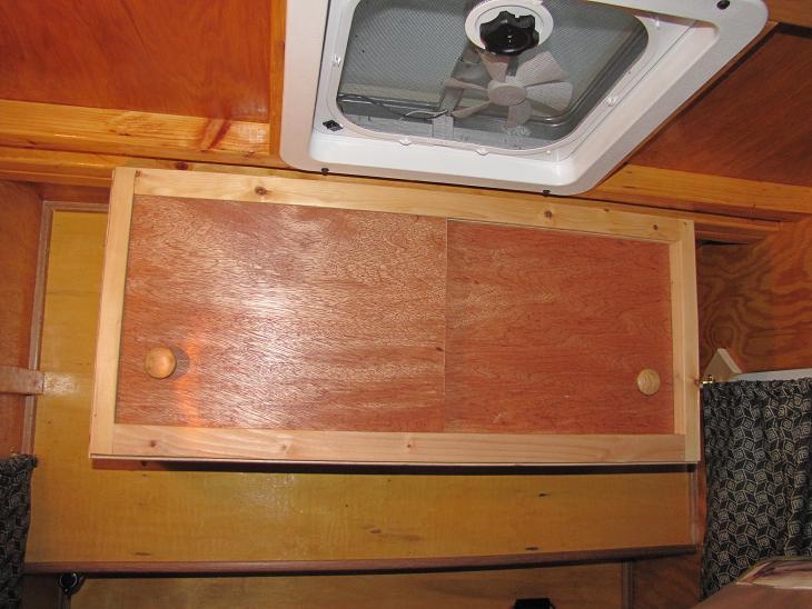

Getting ready for the Hallow Fun gathering at Knoebels in PA. Decided to do just a couple more things. I had a nylon mesh basket hung from my wall inside, it worked well, but it always seemed what I wanted was on the bottom... grrrrr. So I built this simple little cabinet with sliding doors. Of course, as carefully as I measured, the doors were ever so slightly undersized. grrrrr again. A trip to the store, and I bought two pieces of 1/8 steel rod, dropped into bottom groove, and they now work perfectly. They even slide better on top of the rods!
I didn't take a picture, but you can see my curtain to the right of the cabinets is hung a little low, and the block of wood that the rod holder was screwed into was a "temporary" fix I did right before my first camping trip. The rod holders are now screwed into oak blocks, and raised enough so you don't see the window frame above the curtain.

:applause: :thumbsup: Looks great. It's always the little things that you thing of after the build that keeps you thinking and more comfortable.
Keep up the good work and enjoy the ouying.
