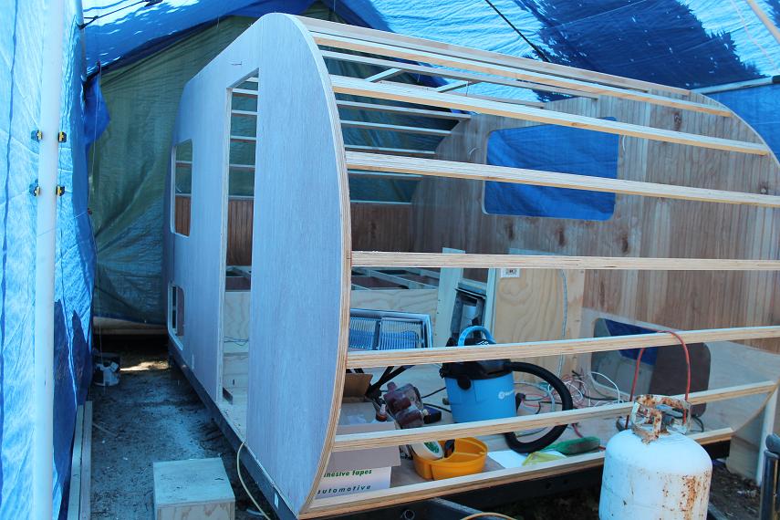

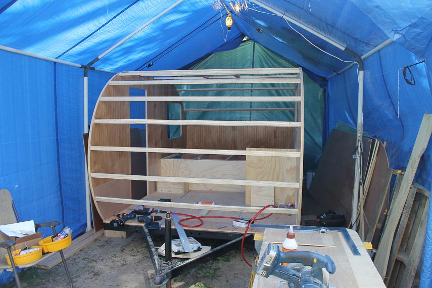

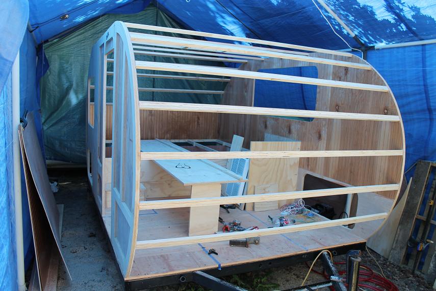

parnold wrote:Started the day off by cutting the door opening finally. As KC noticed, the door opening in the wall framework was smaller than my sketchup drawing, and was actually very narrow at about 18 inches. I widened the door opening to 22 inches, which is comfortable for me to get in and out without having to twist sideways.
I continued installation of the spars. I have four more to install, one on the bottom front, and three on the back. It's a good thing I got the door cut open.. it would be hard to get inside otherwise.
I did some more bracing to the bed framing, and finished isolating the area for the slide out kitchen. There will be some storage under the edge of the bed. Tomorrow, hopefully I'll get the plywood for the bed, and hinges for access to storage, finish the last of the spars, and get the wiring in place. Who knows, maybe I'll get to start on the insulation too?
Here's another view of todays progress.
Wow! Your trailer is coming right along. I think it was only an idea when I was last posting here and now it is half done already. I think when they are bigger trailers with lots of stuff in them it is easy to under estimate the time it takes to build them. The wait and work shall be worth it. You will have a roomy trailer more like a home away from home. Nice going.

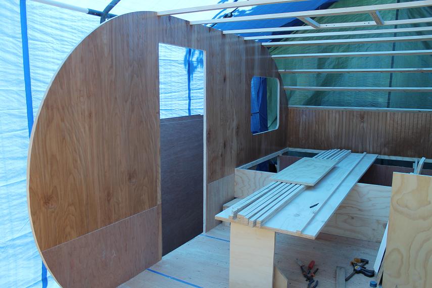

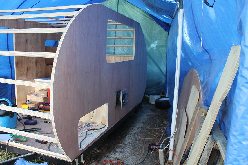

For KC, a picture of the right wall completed.
And the left wall.

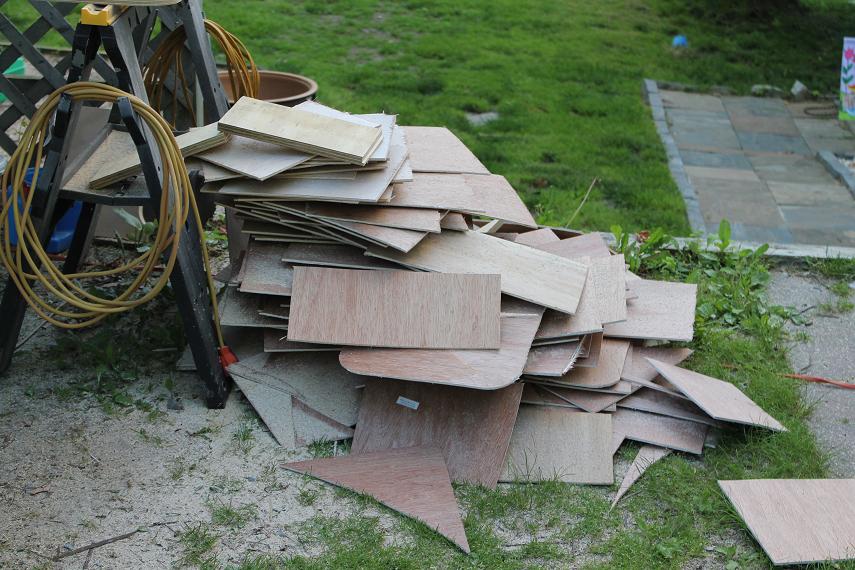

And this is the pile of scraps I'll use for firewood.
The left wall took most of the day since I had to build it around the furnace exhaust. Before I can finish attaching the interior part, I need to completely seal the outer hole with resin, and carefully caulk the standoff. Only when that is done can I finish the interior cabinet work.

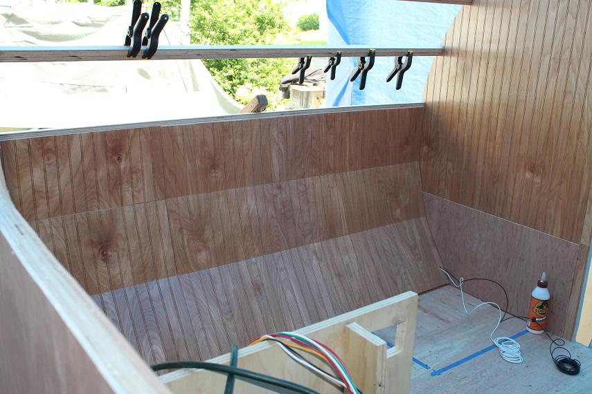

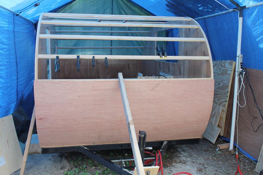

Postby parnold » Sat May 26, 2012 4:57 pm
90 degrees today, 350% humidity, and a very severe thunderstorm in the middle of the afternoon so here's what I got done today.
No matter how hard I tried, I could not get this wood to bend to my profile. Most of the wall will be hidden behind the bench seats and table, I'll dress up the cracks with some molding... no biggy.
Insulation in.
Outer skin on. The luan, or underlayment did not like bending from side to side, however it bends extremely easy from end to end, so the rest will have a seam down the middle.

Postby Cliffmeister2000 » Sat May 26, 2012 5:07 pm
I wonder if it would have bent better with the bead boarding horizontal instead of vertical? Not that you would have wanted it that way, just pondering...

Postby Martiangod » Sat May 26, 2012 5:34 pm
Horizontal would have bent, the structural integrity of the bead board runs with the beading.
You may have been able to steam it to bend, but I doubt the glues would have stood up to that.
Will look great as is when done.

Postby parnold » Sat May 26, 2012 8:25 pm
The bead board, or birch paneling is very stiff stuff, and I was worried about the strength of the spars if I tried to force it. It was also rather expensive at 42.00 a sheet. It is almost twice as thick as cheap paneling. Since I have my little trailer to use, and not rushing to finish this one, I did spend the extra money for the better interior.
