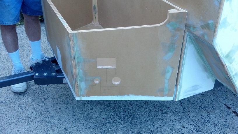

First we added the inputs to the side of the tongue box, we had to router the back of the panel because the 120v power inlet only has enough threads for a 3/8" panel when my tongue box is 3/4". There's also a 12v outlet and a space for a duplex 120v outlet. I wanted to have 120v and 12v power externally so we could have access to them without needing to leave the galley or a door open.
20140725 tongue box inputs small.jpg (164.14 KiB) Viewed 2251 times

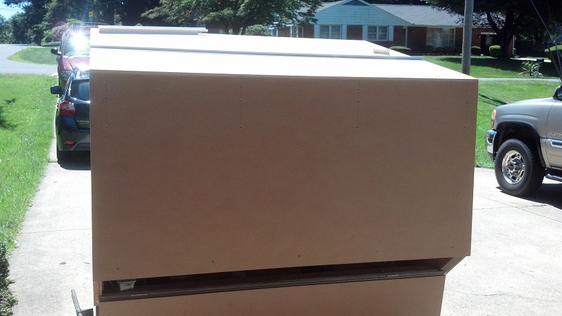

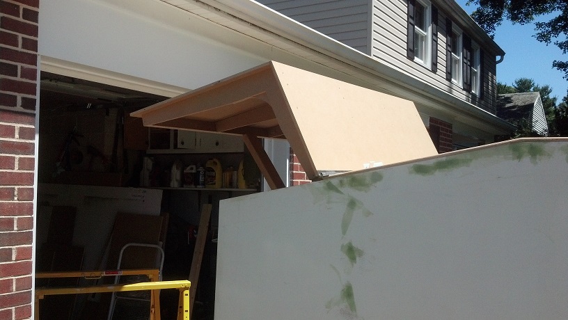

Then, we played with the hatch a bit. You can see the lower hatch hanging down in this picture, I have to buy the barrel bolts to hold it in place. It will also need bumpers on the trailer frame because the stabilizer jacks each have a corner that sticks out that dents the panel whenever it swings free.
20140725 hatch closed small.jpg (117.98 KiB) Viewed 2251 times
20140725 hatch open small.jpg (125.26 KiB) Viewed 2251 times
We had to cut the center galley divider a bit due to the size of the rib we put at the hinge, but now it opens pretty easily. It is at about my comfort level for height, so my wife (who is 6" shorter) may not have as easy of a time opening it. I need to figure out how I want to prop the hatch open, I'm thinking a single prop rod from the center divider up to the larger panel, with the relative sizes and positions, I'll have to have the rod on the oven side of the divider and hinged there instead of on the hatch. But I have to get the galley completely done and installed to make sure nothing interferes with it.

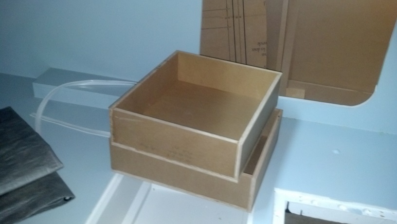

Oh, we also built the drawers for the galley.
20140725 drawers small.jpg (74.22 KiB) Viewed 2250 times
The photo's not the best, all of the joints are flush. I have to decide if I want a small pull or drill a finger hole in them like the rest of the doors/panels will have.

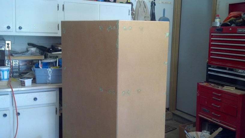

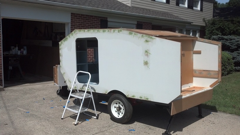

I made a little progress on several different areas over the last few days, I filled all the voids in the sidewalls on the bottom edges, filled any gaps between the walls and the subfloor, etc. I also filled in the hatch's exterior holes:
20140727 hatch filling small.jpg (93 KiB) Viewed 2191 times

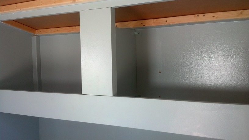

And I installed the divider for the foot cabinets. I originally wanted a smaller divider, but making it 6.5" wide let me get away with only three sets of sliding door track for the entire trailer instead of four. I also decided the interior divider did not need to go all the way to the ceiling, I hope we never pack enough stuff in there that it becomes an issue. (does Hoarders do episodes about RVs? :oops: )
20140727 shelf divider small.jpg (90.26 KiB) Viewed 2191 times
The two brown marks on the right are screws holding the galley divider in place.

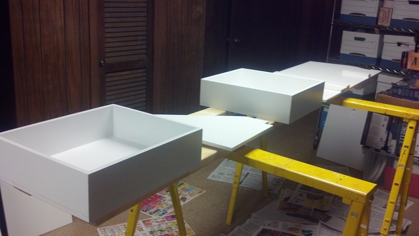

This week I've been painting everything in the basement, just one coat left on the two galley shelves and I'll be done painting the removed pieces.
I also put the first coat of paint in the under-floor storage box, I can't wait for that to be done so I can put the lids in and be more comfortable when I'm sliding around inside the trailer.
Here are the two galley dividers and the galley drawers:
20140808 basement painting small.jpg (113.79 KiB) Viewed 2080 times

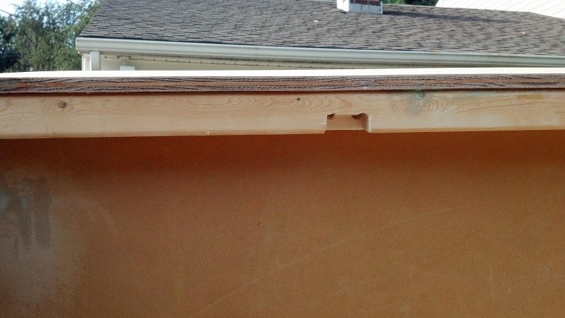

-Cut a space for the wires going from the trailer to the hatch, I'd drilled them through the crossmember too high and they would have interfered with the hatch closing.

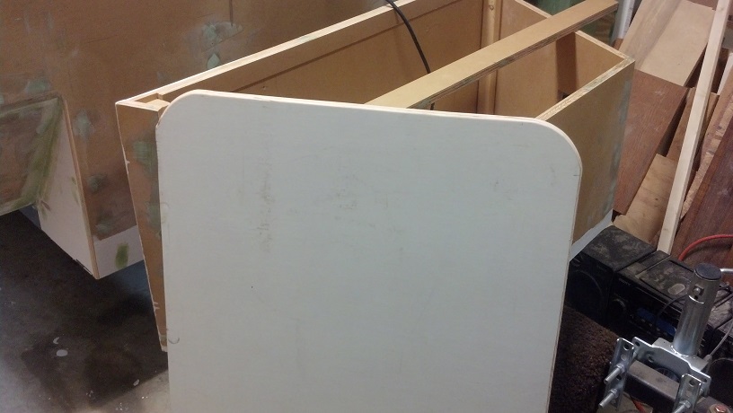

-Made the two door cut-outs into side tables, including sanding, round-over'ing the edges and fitting the table rails to them. I had two 36x26" cut outs to work with, so one has the rail on the long edge and one on the short edge. I had hoped to prime them and the galley interior this evening, but the router revealed a 1"-long void in the plywood that I wanted to fill before priming. The long edge railed table will go low on the driver's side and get two folding legs underneath it (adjustable in 1/2" increments) for our cooler or other items that do not fit nicely in the galley.
The short edge table will go on the passenger side and I'm a little conflicted about it, the one leg I bought for testing only goes to about 32" high, I would need ~37" to make it equal to my countertop. I could always bring along a base of some sort for it, or I could put it at 30" and have it the same height as a normal kitchen table (vs 36" for countertop height). I set up one of our camping chairs at the kitchen table and tried to eat from it, our chairs end up way too low to the ground to be comfortable/natural. :thinking: At what height do most people put their side tables?

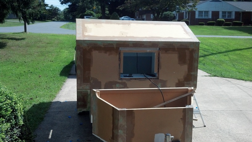

I had to give a neighbor a tour of the tear, he caught me outside working on it and said his family had been taking guesses at what it was for the last few months. They'd never suspected it was a camper. :lol:
The wiring notch, a Multimax made it super easy, but not as square as I wanted.
20140809 wiring notch small.jpg (125.93 KiB) Viewed 2000 times
One of the side tables after routing:
20140809 side table small.jpg (95.85 KiB) Viewed 2000 times

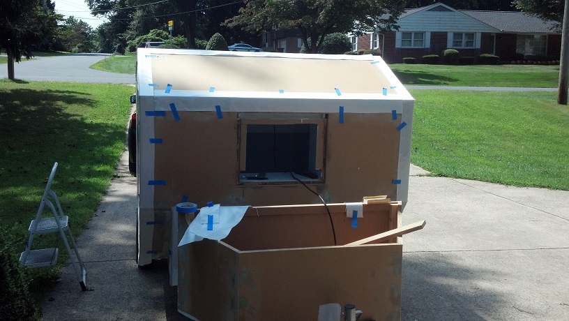

So today was my first experience with fiberglass and epoxy. I used West's 105 resin, 206 slow hardener (wasn't sure how hot it would be, and I figured I'd need a little extra working time since it was my first time) and West's 9oz, 6" tape, using West's 7" roller covers (cut down to 4" to fit my roller and 3" tipping brushes) and disposable paint tray liners. The left and right upper corners of the front face did not go nearly as smoothly as I would have liked, for one the tape slipped about 1/4" and made a mess of it, the other wasn't nearly as bad. There's also an air bubble I have to fix at the center of the rear-most roof seam that I couldn't get to lay down when wet so I'll fix it when it's dry.
20140816 epoxy layup front small.jpg (153.71 KiB) Viewed 1961 times
For the lay-up, I used the machinist's square to mark 3" in on each panel as a rough guide to where the tape should end up, I used a sharpie to put a mark every 12" in the center of the tape for the pieces where I couldn't easily use the square on the joint to be covered. That worked out really well, and made alignment easy even with sun and sweat in my eyes, but I'm going to paint my trailer so the tip wouldn't work for those building a woody.
I did a continuous strip of the tape on the roof from the galley all the way to the bottom front, then folded it over the side and cut the corners using a pair of heavy duty office scissors. I probably should have just made a single cut for each corner and dealt with two layers of fiberglass at each location, since the tape moved a bit while the epoxy was being rolled on. The rolling bunched the fiberglass at the forward corners and left a gap at the top roof joint which I'll have to fair with thickened epoxy, when if I'd left extra fiberglass at each joint, I could have just adjusted it. The tape was held in place with painter's tape, I folded over ~1/4" of the trailer side of each piece so I could easily remove it while wearing nitrile gloves after I'd wet the fiberglass in that area.

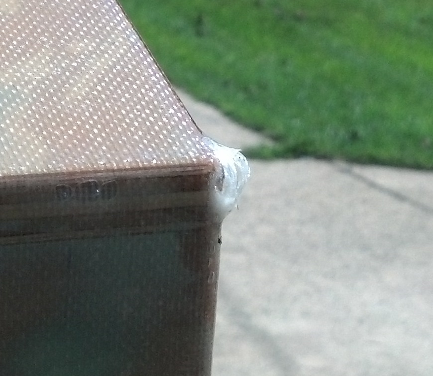

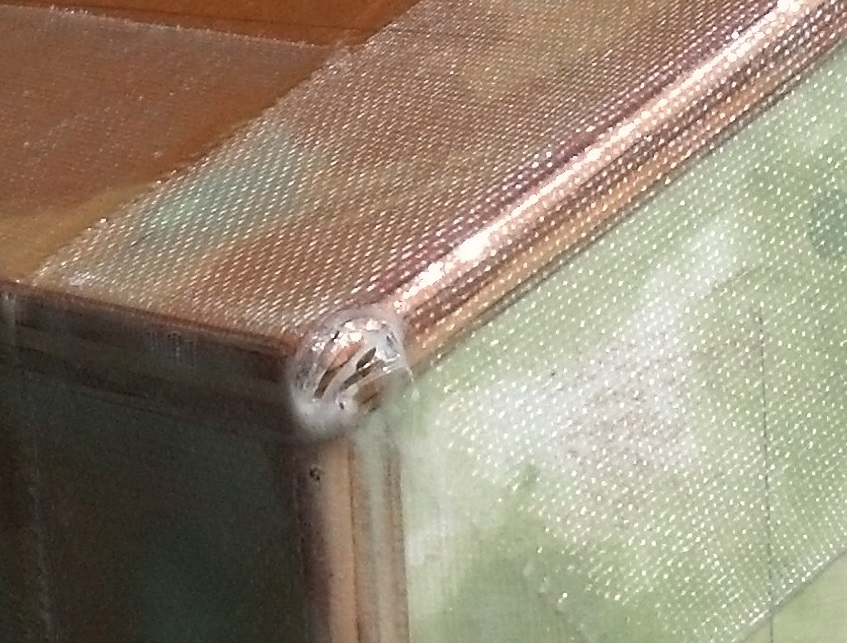

Here's the worst corner, the individual fiberglass strands are lifted up pretty far from the wood.
20140816 lifted fiberglass 1 zoom.jpg (207.86 KiB) Viewed 1959 times
20140816 lifted fiberglass 2 zoom.jpg (157.65 KiB) Viewed 1959 times
You can also see 3 little air bubbles at that corner, when the epoxy is dry, I'll drill those and use an epoxy syringe to fill them.
Kharn
Posts: 655
Re: 4-Day Weekender - Epoxy fun
Postby noseoil » Sat Aug 16, 2014 3:41 pm
The nice thing about working with glass cloth is that you can just grind it down and add another layer or two for a filler. Since it will be painted anyway, just knock the corner down, then cut some small pieces to lay-up a bit more thickness and you're good to go. The epoxy will make a good bond and the problem is solved.

I ended up mixing a batch of epoxy with silica to rebuild that corner after I trimmed away the raised fibers with an Xacto, another layer of fiberglass would have been a huge effort to feather out.
For sanding the epoxy, West says to take the gloss off, do they mean sand it until it has a flat white appearance or is there a level before that which is sufficient for more epoxy or paint to stick? Even with 100 grit paper and an orbital sander, it was taking forever since I'd have to use the edge of the disc to make sure I hit every little area. I didn't scrub/wash the epoxy prior to sanding, but I didn't notice an amine blush. :thinking: (I have to get a pack of 80 grit, after I sanded half the trailer I found it is required to use 80 if recoating with epoxy when 100-220 is fine for paint)

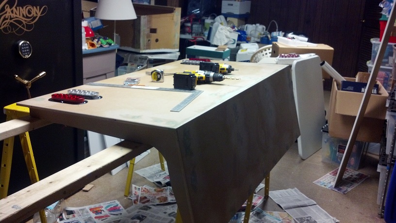

I moved the hatch and the tongue box down to the basement and drilled the holes for the hatch's taillights and reverse lights (I touched the leads to the contacts on a deep cycle battery and dang they're bright :? :lol: ), I want to get a center brake light as well, but I haven't gotten around to ordering it.
