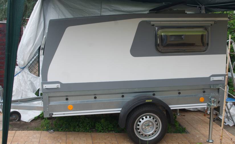

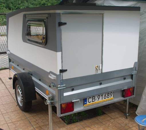

Postby ipy » Fri Jul 24, 2015 2:45 pm

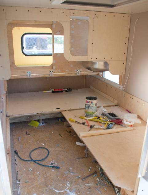

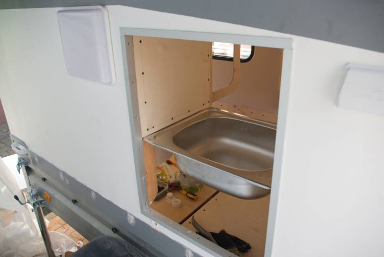

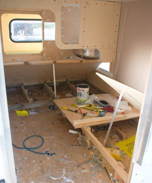

I am about to finish external part of my trailer. Just need to install kitchen hatch, build lower part of the door and install lock on the upper part, paint elements that surround lower edge of the capsule and finish windows.
Now I spend more time working inside. Installed a wall between main room and a kitchen unit- it is insulated. Perhaps I will change its shape, as I do not like it too much. The sink is installed. Also I built most of the bed constructions. Matresses came, 4 of them, each in other colour. Hope it will look funny, not disguisting.

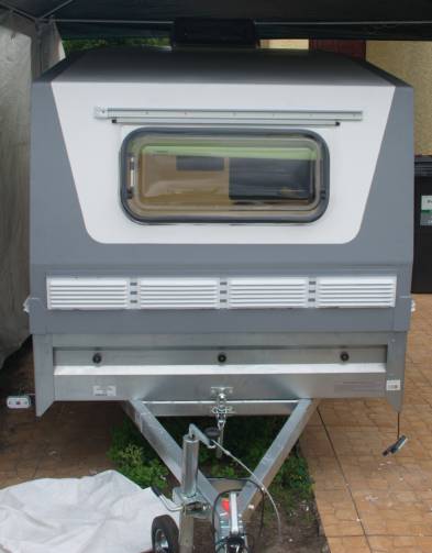

Postby ipy » Tue Jul 28, 2015 5:42 am
Looking at the exterior, I can say" we are nearly there.

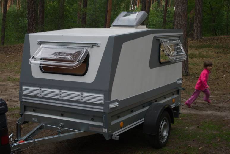

Re: Small caravan box by Tom

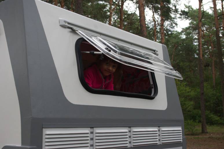

Postby noseoil » Tue Jul 28, 2015 7:30 am
Tom, the paint turned out very well & looks great!

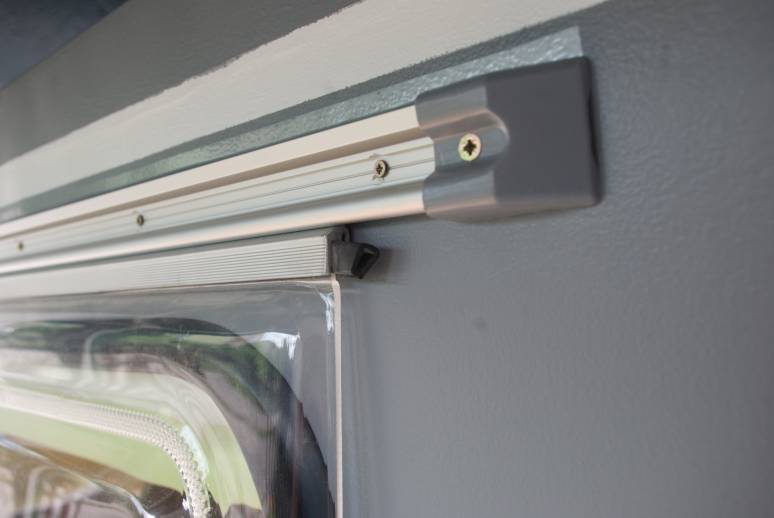

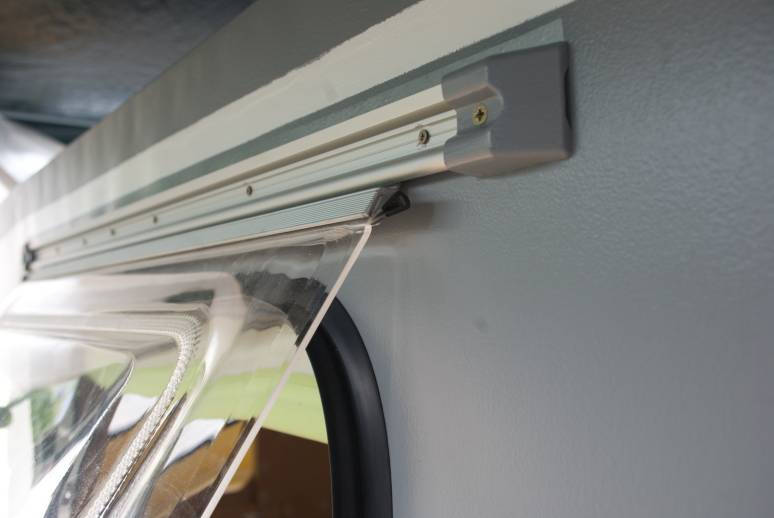

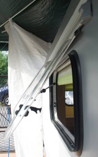

I'm curious about the aluminum trim over your windows. I can see the lip added above to redirect the rain & water, but what is the extra piece above used for?
137905
noseoil
Posts: 1822
Images: 670
Postby ipy » Tue Jul 28, 2015 2:17 pm
I do not know the names of window elements even in Polish. Simply speaking, there are 2 aluminium elements: one, longer, is fixed to the trailer wall. It still needs a plastic trim to cover screws, by the way. Into the bottom part of this element goes another one made from aluminium- this one is connected with a window itself. I can open the window and lock it in various positions, but both aluminium parts are still connected, like hinges.
I wonder if I should add some colour to the trailer. I am thinking about a yellow shapes on sides. Will think about it later, because now I am going to finish interior and start enjoying the trailer, at last!

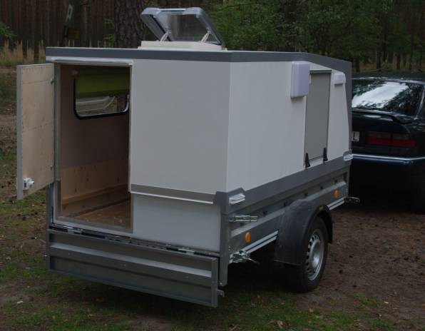

Postby ipy » Thu Jul 30, 2015 2:23 pm
Second set of pictures. Since tomorrow I concentrate on building a kitchen unit and a big bed (child bedroom is ready). If everything goes good, on weekend we travel by the Baltic Sea.
