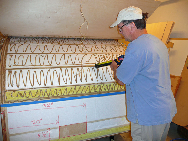

:applause: :lol: :applause: I managed to break my cycle of working on the teardrop once every three weeks and finished quite a bit of work this weekend. (This was the second week in a row for TD construction time.)

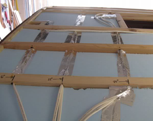

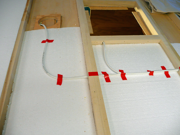

I roughed in the electrical in the ceiling.
Then I finished the installing the insulation board. In the channel for the wiring, I used some "can-type" insulation foam. After it cured, I trimmed and sanded it flush.

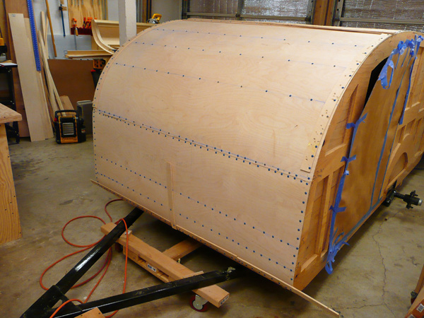

Now it was time to skin the front and the roof with 1/8" plywood. This process seemed to inhale the PL Premium.
By late Sunday afternoon, I had the front and roof skinned.
For me, this seems like a major milestone. I can now see the end of the build in sight...or is that another freight train?

Tom - I don't know how your are planning to finish you tear for the exterior, but after that PL sets, I bet you can remove at least half of the them screws and still have a satisfactory bond :thinking:

All of the 200-300+ screws will be removed; the PL Premium will be the only thing adhering the plywood skin to the framing. I used this method on the hatch and it seems to have worked well even with the wicked radius at the bottom of the hatch.

aggie79 wrote:Image
Nice job Tom! :thumbsup:
I like this picture of yours. It's a good tip for builders, marking the distances in marker and taking a picture of it. I did the same thing and it came in VERY handy. You might write the numbers down somewhere but they can get lost. All you have to do is look at the pictures.

Postby aggie79 » Mon Feb 08, 2010 10:54 am
planovet wrote:I like this picture of yours. It's a good tip for builders, marking the distances in marker and taking a picture of it. I did the same thing and it came in VERY handy. You might write the numbers down somewhere but they can get lost. All you have to do is look at the pictures.
Mark,
This is one of the many tidbits of experience I borrowed from your build. I have trouble finding my car keys in the morning, so I knew that writing the dimensions on a scrap piece of paper wasn't going to work. I figured the pictures would at least give me a chance of recalling what I did.
Postby planovet » Mon Feb 08, 2010 1:37 pm
aggie79 wrote:...so I knew that writing the dimensions on a scrap piece of paper wasn't going to work.
I tried that...but ending up misplacing them. The photos worked much better. Just don't lose the photos :lol:
Keep the pictures coming! :thumbsup:

Postby starleen2 » Mon Feb 08, 2010 2:59 pm
. . .and it also helps when running screws down - would hate to have one run trough one of those wires! ;)

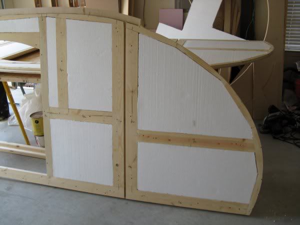

I don't know the technical term, but the insulation I will be using is the white board with the foam beads. I peeled off the vapor barrier on both sides so the adhesive would adhere. The white board is more consistent in thickness than the blue or pink insulation boards, and it compresses more easily. It also sands easily but can be more messy with all the foam beads from cutting. I used a utility knife and straight edge to cut the insulation for my roof and this produced less beads than cutting it on the table saw.
Insulating the sides will be tricky trying to fit the insulation in all of the various shapes of openings in the plywood framing. I will probably cut the insulation about 1/2" shy of the openings and use spray foam to fill the gaps. I don't remember what type of saw it is called, but I have a Japanese flush cutting saw that I used to trim the can spray foam flush. It was easy to do. I used this method to fill in the chase around the my wiring in the roof of the teardrop.

I felt the same way when I was insulating my sides. I wish I had put the framing down on the insulation and traced out the outlines BEFORE I had glued one side on. Would have made cutting the insulation much easier. But I took the sheets and pressed them against the opening that I was going to fill. Then I tapped lightly on the foam board around the edge of the opening and the imprint of the opening was left on the foam. It was faint but enough to see where to cut. It made for a nice tight fit, tight enough that I didn't need glue to hold them in.
