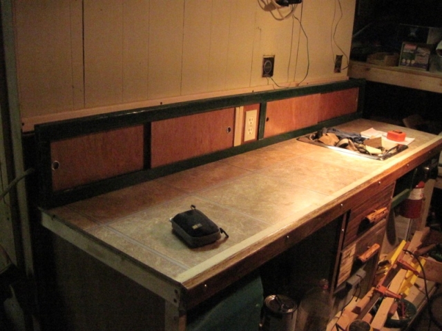

Finally, the drill arrived in the mail and it was back to work. I chose a Dewalt, very happy with it, nicest drill I've ever owned. I built a sliding door assembly for the electrical raceway and installed a galley electrical outlet. Upper cabinets will come later.

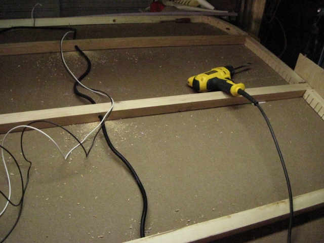

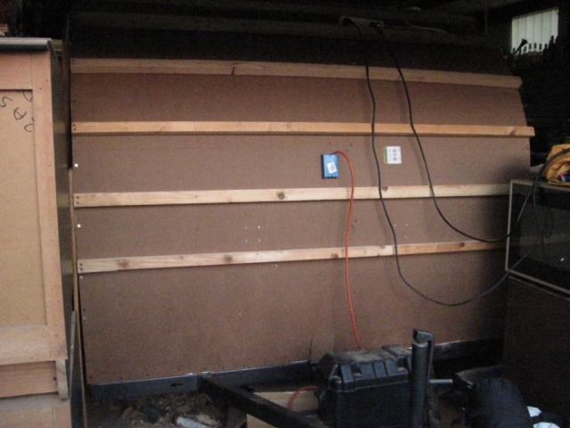

I got all but just a few of the spars installed and most of the blocking.
Pulled the wires for the reading light and dome light, then started adding insulation.

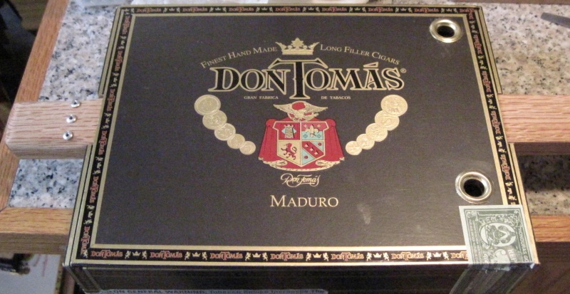

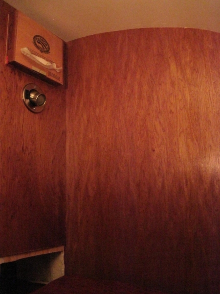

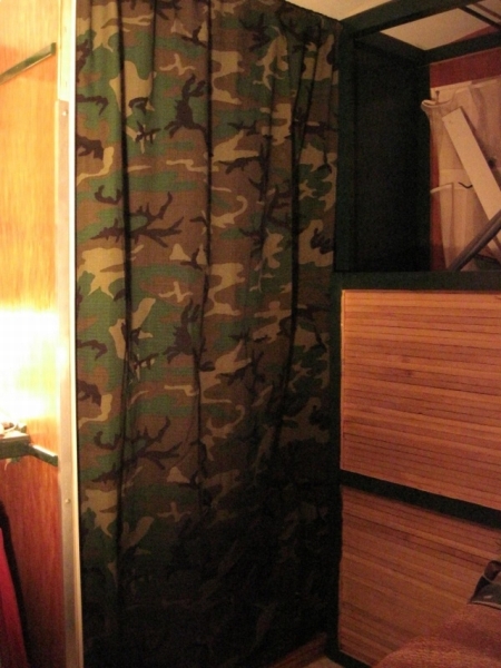

A cigar box, with cutout, will be used for a tissue holder. This is on the closet wall next to the bed. The cutout at the bottom will be a recessed storage area for eyeglasses, etc. Camo shower curtain and wooden cigar box tissue holder, can you tell this is a guy build? :lol:

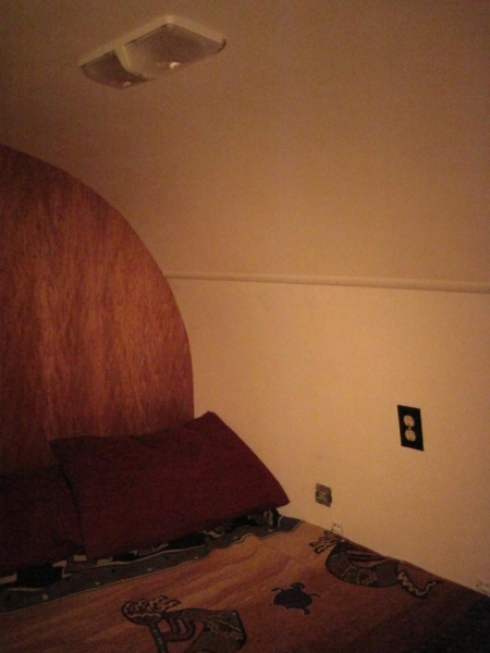

Trimmed a ceiling joint and added the dome light.

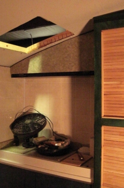

Finished some odds/ends today. I painted the upper bathroom cabinet door frame, built and mounted the door. It is made of Luan covered with a light colored piece of salvaged laminate on both sides with routed beveled edge and a magnetic catch. Will add a brass knob later. A piece of scrap white Corian with an added round-over upper edge was used for the transition area between the face panel and aluminum track slider. I also framed in the space for the vent, ran wires and cut the ceiling panel.

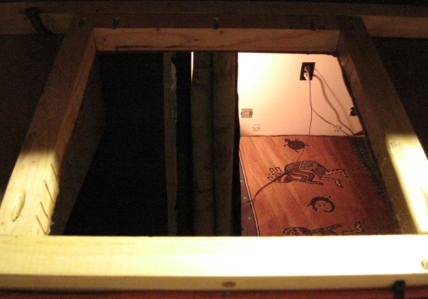

Looking down thru the vent hole.

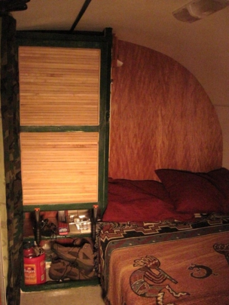

I'm undecided if I want to add a door for the upper part of the closet. I considered a full-length door that would not only serve as a closet door but also as a bathroom/shower door. But, my closet door width and bathroom door width aren't equal. Maybe all's well that ends well. I think I'd still want some type of "door" on the shower area rather than it being open to view when the closet door was shut.
Here's the mocked-up upper closet door. I think the lower area open shelving will work good for shoe storage, etc. Is it possible to have too much cedar strip planking in the interior? :lol:

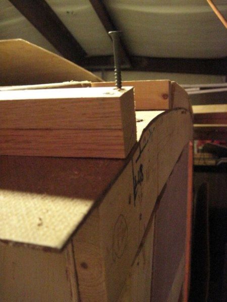

The hatch spar is now installed. Two 1 x 2 pieces of oak glued together.

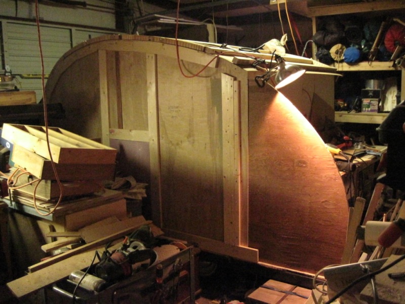

I drew the remaining section of profile on hardboard (creating a template) then used the router trim bit to cut a plywood galley liner out of the old bed support ply. Not the best surfaced plywood, but it will suffice. It will be covered on the galley side with laminate and that surface is very nice. The outside will be buried within the wall. It's only structural.
I realize this style of construction is unusual and it's not one I would recommend. So why did I approach it like this? As you can see, I had very limited build space at the galley area, a narrow walkway. Erecting full-length sidewalls at the start would have compromised my ability to walk from one side of the build to the other. Before I built the galley counter and cabinets I was using that "deck" to walk on, lot of exercise! Carrying supplies around was difficult enough as it was.
I felt like this was a major milestone in the build, one I had agonized over. Not only am I now able to (almost) visualize the entire final profile but I can now firm up the counter and raceway areas and build/install the upper galley cabinets. Closer to hatch work also.
