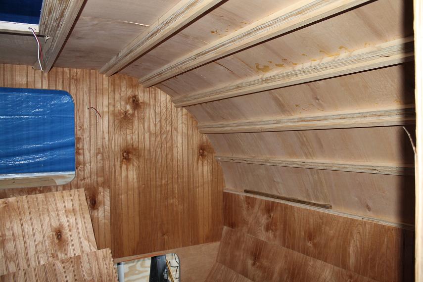

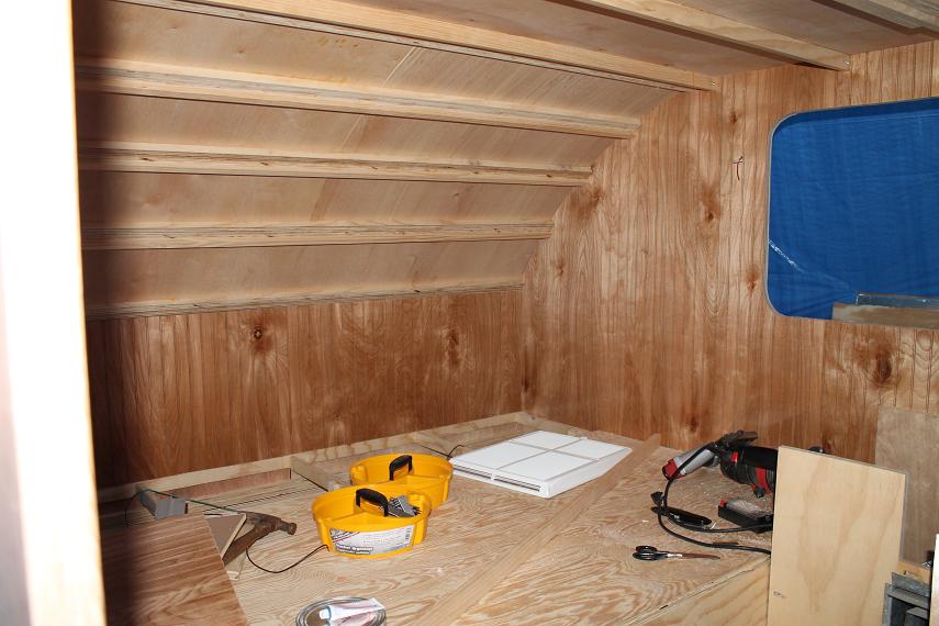

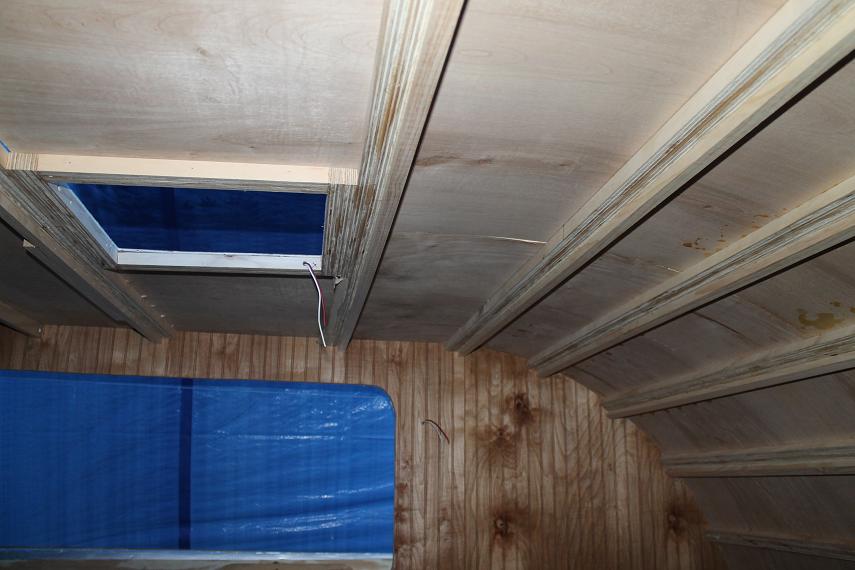

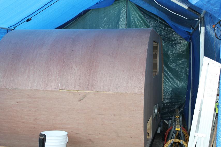

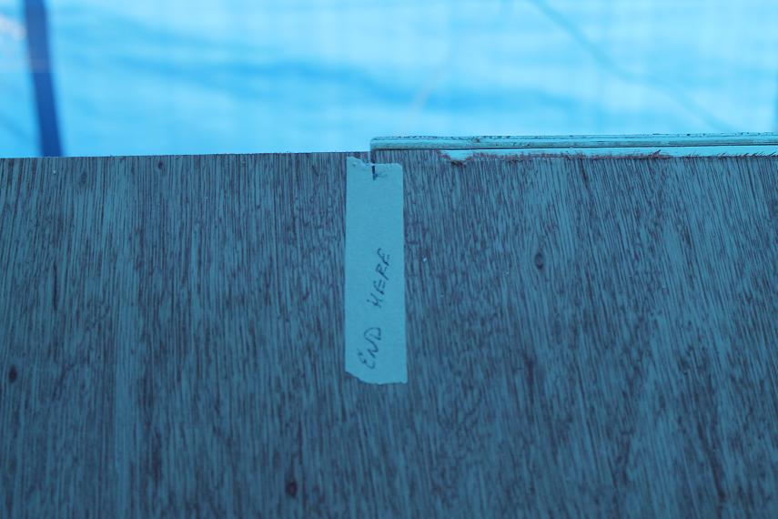

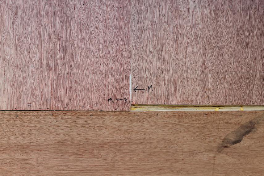

I had a productive weekend, but ran into a few problems. First, and most frustrating was that my roof spars were not adequate. Fortunately I realized this before I started attaching the roof, so a fix was fairly easy. My spars were made of 3/4 cabinet grade plywood, cut to about 1 1/4, and then two nailed and glued together. TOO FLEXIBLE!!!! I solved the problem by attaching a 1 x 2 to each one of those with nails and glue. I should have used 2 x 2's from the start. I was trying to gain every possible bit of headroom I could. I wasted hours of time making those stupid spars, and then a couple more hours fixing them. I also had a problem in that the front wall bowed slightly from the force of the luan. Because of this... well.. the pics tell the story.
Some things work out exactly as planned!
Because of the bowed front spar, when I mated the center seams up, I got this result. :cry: It's not the end of the world, it will be covered with fiberglass cloth and resin and filler, but I'll probably have to fashion some type of trim to cover the imperfection.

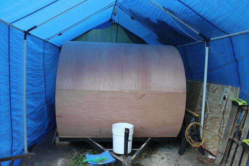

Here's a shot down the left side of the trailer. I have not trimmed the overhang on the back half of the trailer yet.
A couple inside shots.
And a front shot.. damn this thing looks big. I'm already looking into mirror extensions for my car!
