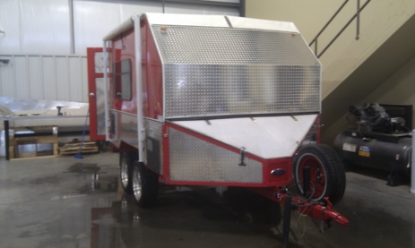

Postby aggie79 » Fri Jul 20, 2012 1:03 pm
crumbruiser wrote:The wheels and the extra bling. I like it! :thumbsup:
Frank
Me too! It looked good before, but the extra diamond plate really sets it off. :applause: :thumbsup: :applause:

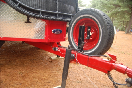

Had a new tongue made for the trailer, tied back just ahead of the axel
Used 3" x 4" tube and had a 7000lb Bulldog 2" coupler welded on
Once this was done I was able to mount the fold down tire carrier and Break away switch

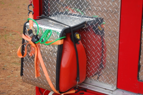

Out of need and lack of space for a gas can, I rigged up a storage pod on the back for a 5 gal jerry can, Wasn't sure if it would hold for almost 4000 miles, but it worked great.

Postby Junkboy999 » Sun Nov 18, 2012 6:54 am
Man that is one sweet looking monster.
In the post above , first picture, What is that black “ Grill looking “ thing above the ford logo?
Junkboy999
Posts: 1259
Images: 52
Location: Wichita, KS
Re: FX Sport, Has landed
Postby Martiangod » Sun Nov 18, 2012 11:51 am
Junkboy999 wrote:Man that is one sweet looking monster.
I was loaded for my move, only spot i could carry the wicker love seat: )

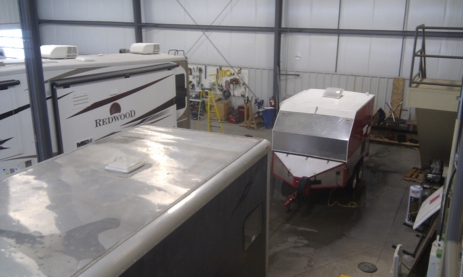

Postby Martiangod » Sat Nov 24, 2012 5:48 pm
Well got her inside and all cleaned up from the trip, also I had froze the water system on the trip, got her all thawed out and antifreeze pumped through, no busted pipes or fixtures so all good there.
Think I have the ramped platform figured out for the back, had it set up on axel stands today, should work out great, going to mount a frame mount hitch on the trailer i think, then it will just plug into the receiver as it is with no mods to it.
Latest score is a power awning we replaced this week under insurance.
Charcole like the one on it.
So its going to go on roadside of trailer.
This will allow me to have shelter on both sides for a total open width of 23 feet.
Now we can curtain in the shower area and have privacy for showering...Whoo hoo say the neigbores :shock:

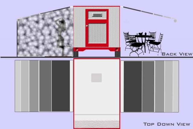

I will also be able to pull a tarp from awning to awning across the back of the roof and have 24' x 8' tarped at the back providing 8' of sheltered area on three sides :beer:
This is the plan
Looks kinda silly from the mezane lined up with the big guys
Little bit of pitting on the aluminum from road debris and salt but she fared her 4000 mile winter maiden voyage
Gonna take some polishing to try and bring the aluminum back up to a shine
