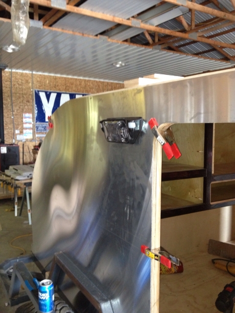

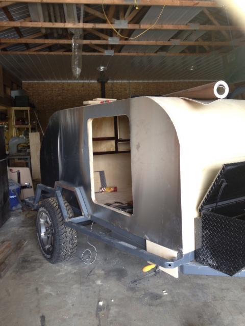

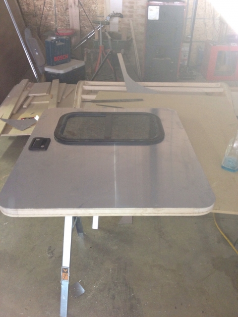

Well I had a little progress today,
And I thought I would see what my side lite would look like soooo,
My main reason to cut the side metal was so I could get a little farther on the doors sooo,
I liked what I seen so I went ahead and glued the shin to the door

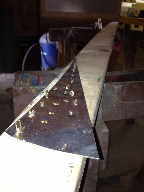

I noticed others talking about stapling the aluminum to the exterior so I tested it out,
And I came to the conclusion that I need to use shorter staples,so I dug around the shop and found some 3/8" staples so ill probably use them if I go that route. Has anyone else done it this way? The ones in that I tried was 1 1/4" most went in some didn't but I had to crank the line pressure up to 120psi to get it to drive them and like I said some still didn't go in.
I haven't tried to attach the wall metal yet I just cut it and clamped it to see how it was going to look. And on the door skin I took 80 grit sand paper to rough up the back side so it might grip better. I hope it takes good. Please chim in on a good way on attaching to side and roof metal I would just like some suggestion good bad whatever I would just like to hear some input. TIA, and as always more to come and :beer: hope everyone had a good weekend.

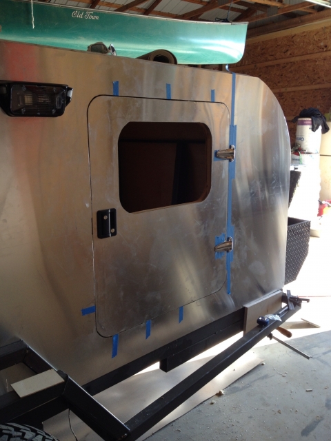

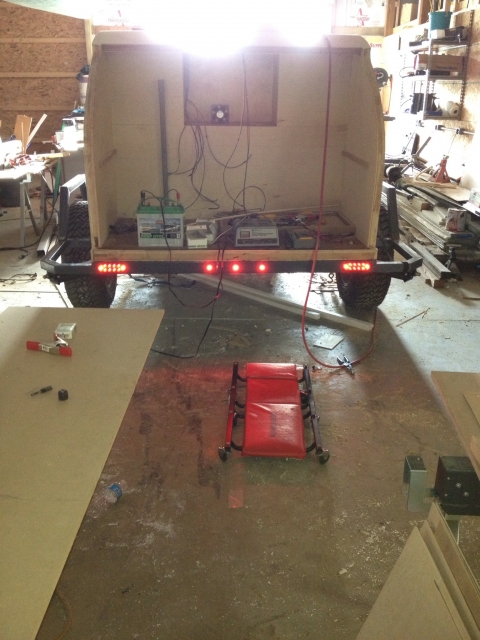

It's been a while since I have post an update so here we go

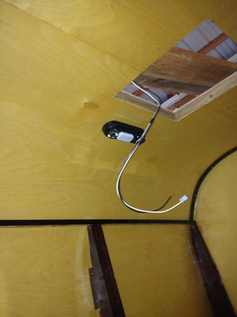

I started installing some of the lights and figure out all the wiring that was ran and identifying what wires were what and tested to make sure that when I enclosed the outer skin that I didn't put a staple through them.
Next up was I ordered my door hinges and installed the passenger side door. It took a little finesse but I think it'll be ok
The door latch was advertised as 1 1/4"-1 1/2" door thickness but their not so I had to mitigate the fitting a little and this is what it took
And on another note I have been working on my a/c system and its not going so good it might get left behind I have another go around at it and if that don't work it's getting scratched off the list!i also was able to order some trim for the door and hatch so I can work on getting that done well see how it goes. But I won't get it til Monday and I have to go to Texas Tuesday through Thursday so I won't be able to do much til the weekend. As always more to come later :beer: til the next time.

Postby Ben » Fri Jun 21, 2013 4:52 pm
Their not bad to install just use spacers all around your door to make sure your gap is even all the way around
