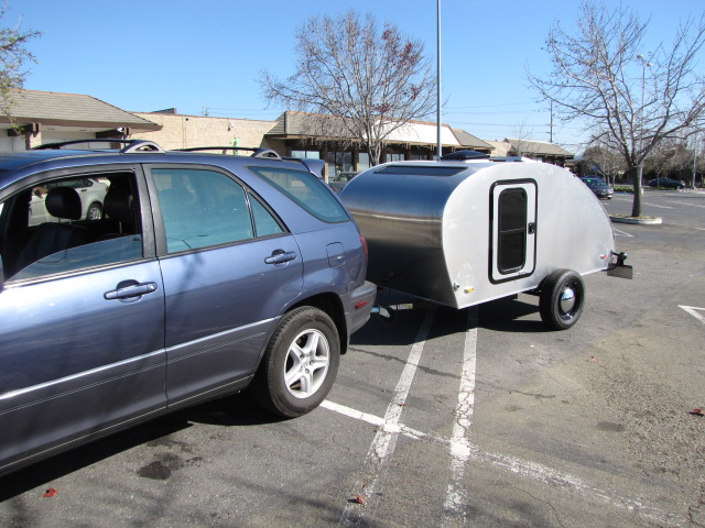

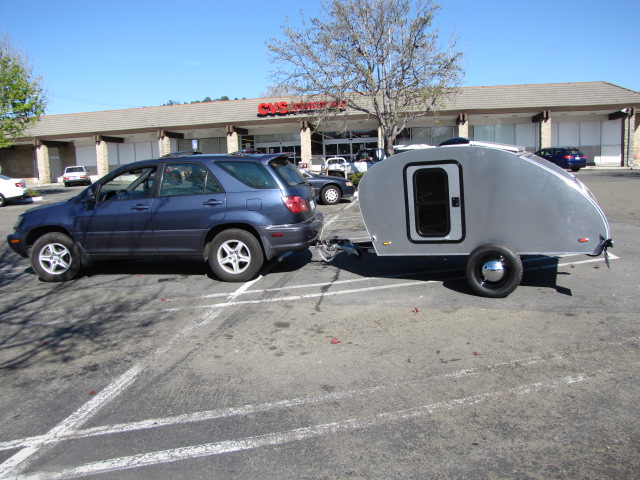

Inspired by Citylights "Cooler" project, I decided to take mine out of the garage for the first time. It tows well, don't really notice it breaking. It bangs around a bit on bumps. Do any of you have an idea how to quiet the slip in to hitch? I think that is what is making the noise.
I need to turn the hitch ball around to raise the front. I think it will be basically level then. It is really easy to back up and park, got it in the little bat cave garage, first try! This week, I'll finish the tongue box and hopefully the hatch, then I am going camping.

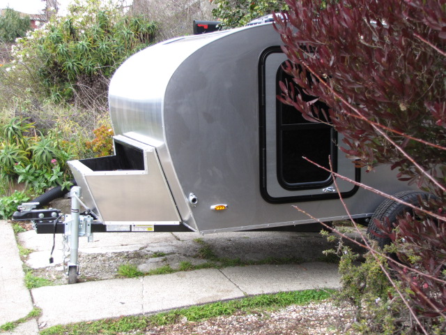

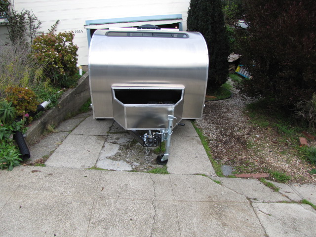

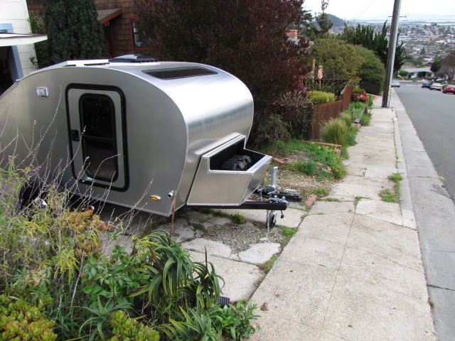

Postby drewh1 » Thu Feb 27, 2014 7:38 pm
Not much time to work, but I did make some progress on the tongue box. It is turning out nice.

Postby bc toys » Fri Feb 28, 2014 7:07 am
you can get a pin that fits tight in the holes for the hitch and the noise should go away and make sure the hitch is on the ball tight there might be a adjustment nut under the tounge on trailer tighten it tell it fits good and snug.

Re: Noise from hitch
Postby dodgedartgt » Sun Mar 02, 2014 8:32 pm
From your comment "...bangs around a bit on bumps...", I'm inclined to believe you don't have sufficient tongue weight. Be sure there is no play between the coupler and the tow ball. Also, when you flip the tow bar to raise the ball, simply raising the nose of the trailer will by itself reduce tongue weight even further. As previouslt mentioned, there are drawbar pins and locks which will elininate any play between the drawbar and the hitch. Still, my mind comes back to it banging and rattling around because it doesn't have enough weight on it.

Postby drewh1 » Sun Mar 02, 2014 8:58 pm
dodgedartgt wrote:From your comment "...bangs around a bit on bumps...", I'm inclined to believe you don't have sufficient tongue weight. Be sure there is no play between the coupler and the tow ball. Also, when you flip the tow bar to raise the ball, simply raising the nose of the trailer will by itself reduce tongue weight even further. As previouslt mentioned, there are drawbar pins and locks which will elininate any play between the drawbar and the hitch. Still, my mind comes back to it banging and rattling around because it doesn't have enough weight on it.
Mike in FL
Hi Mike,
That sounds right to me too. I took it out before adding the tongue box and battery. That is going to add about 80 lbs I suspect. (I think the battery is 60 #'s by itself). Hopefully that will create the proper ratio of tongue to wheel weight. It seems to me the NT trailer does have it's axle a bit more forward than many of the designs I have seen.

You got lots of advice on the trailer tongue. I was going to suggest the same, there should be a nut to adjust the coupler on the ball to make it tight. One thing I did not see mentioned, make sure you have the right size ball for the hitch!
