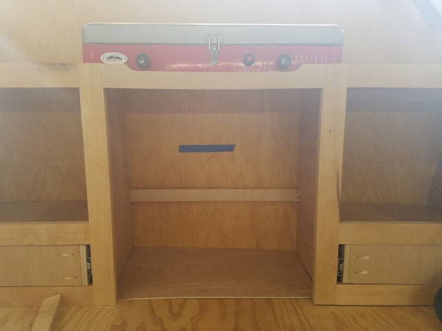

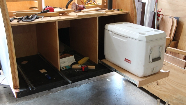

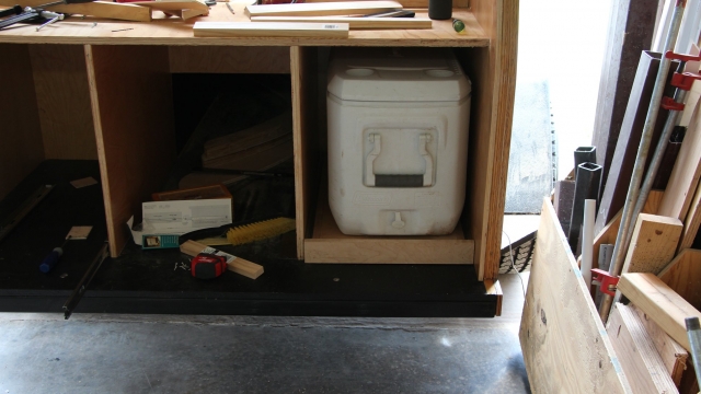

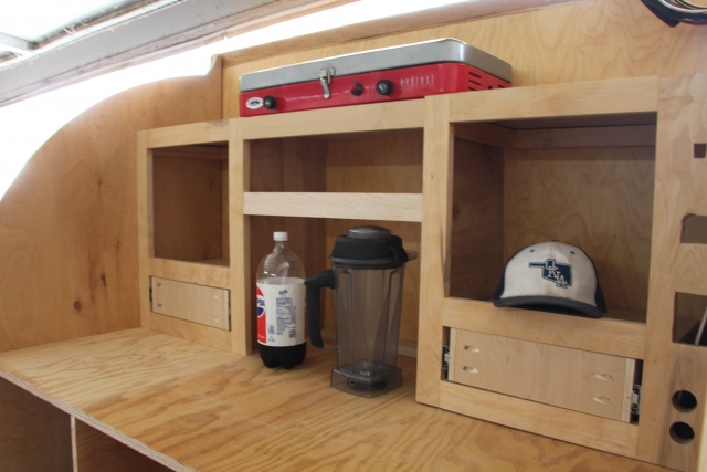

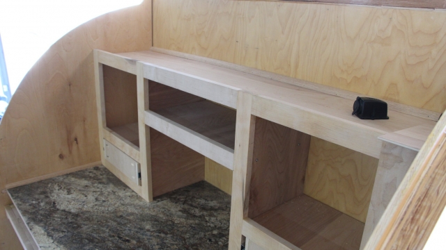

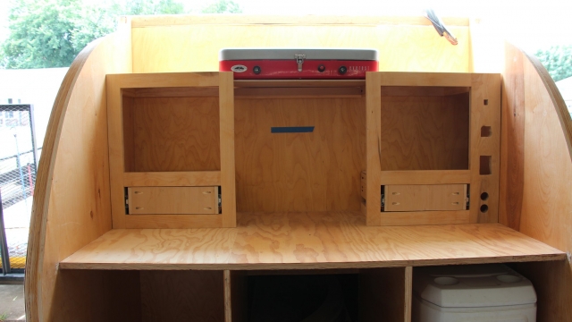

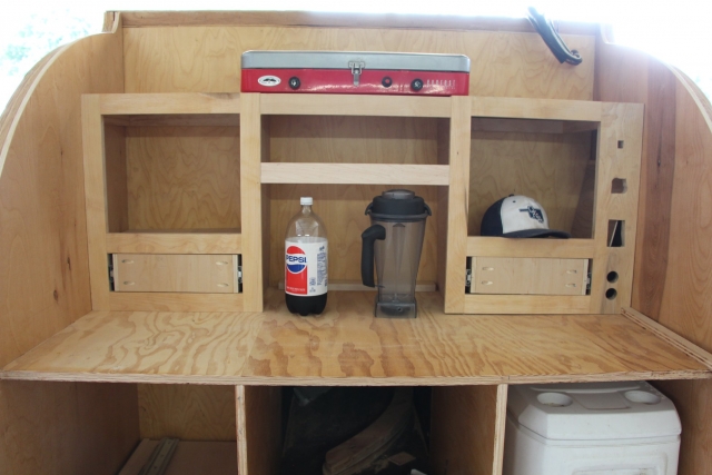

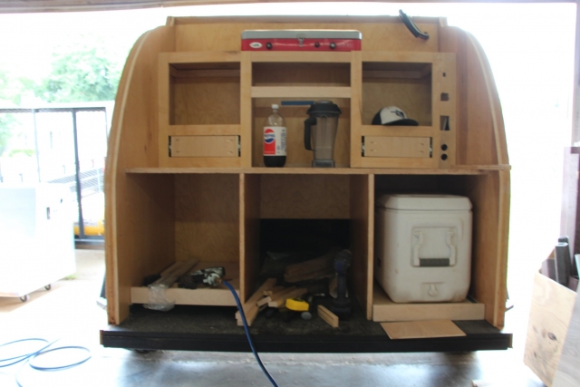

Postby DWT77 » Mon Jul 30, 2018 6:28 pm
I went back and forth on whether to go with the straight or curved piece for the stove placement.
In order to get the stove to sit above the frame line I have to put a 3/4 inch piece of plywood underneath it. This makes the knobs clear the frame without a problem.
I thought a curved piece might look good for the framing so the stove can sit on top of the cabinet without the knobs hitting the frame.
Putting the stove on top of the cabinet was an after thought. If I went with the curved piece I would still have to notch out a 1/4 on the back side of the frame so the stove would sit into the cabinet frame. The stove is too wide to sit up there without notching it out.
So I decided to go with the straight piece. All of the images are just a dry fitting. I will secure everything down once I put the Formica on the counter top

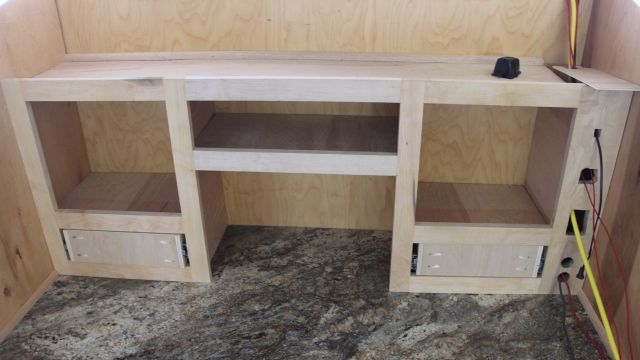

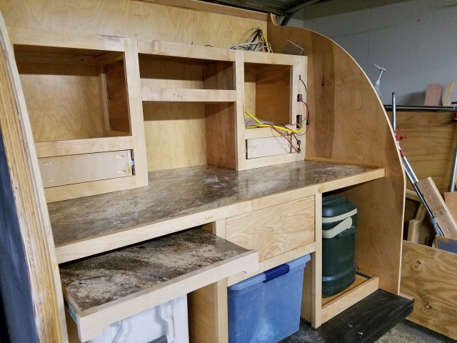

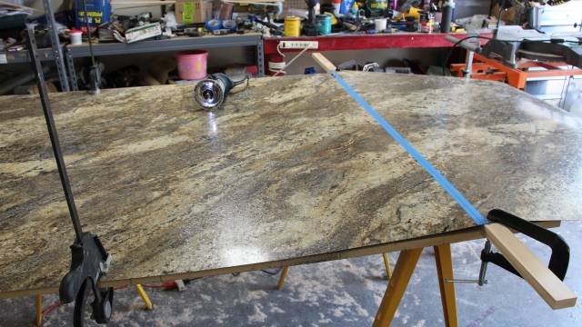

Postby DWT77 » Sun Aug 05, 2018 6:11 pm
Got the formica in and started putting in the cabinets permanently. Got in a hurry and forgot to sand them before I put them in. Will have to do it my hand and then stain them.

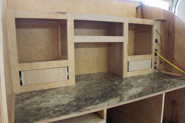

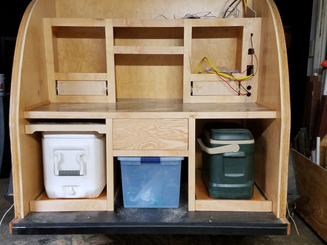

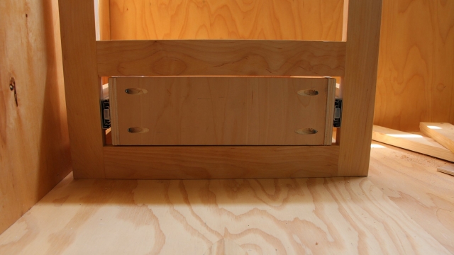

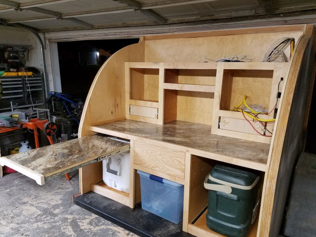

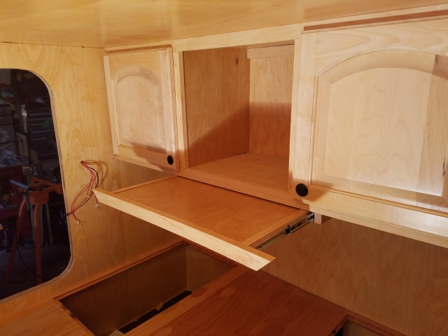

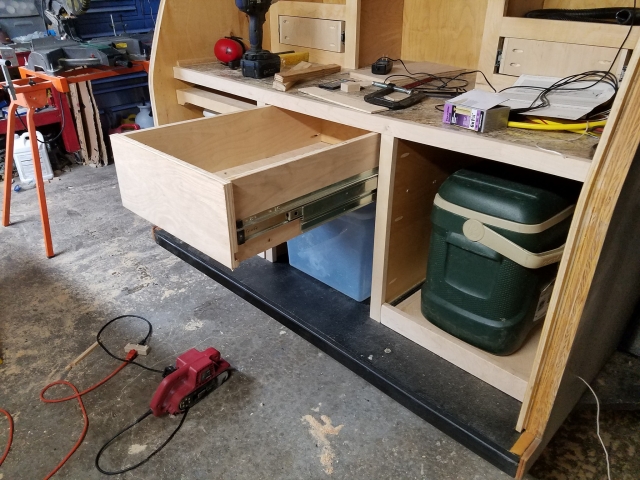

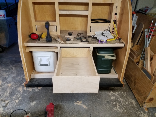

Postby DWT77 » Sat Aug 18, 2018 9:15 pm
Got the rest of the galley cabinets framed in and stained. Added a big drawer in the middle. Also added formica to the pull out slide. Still need to clear coat everything.
