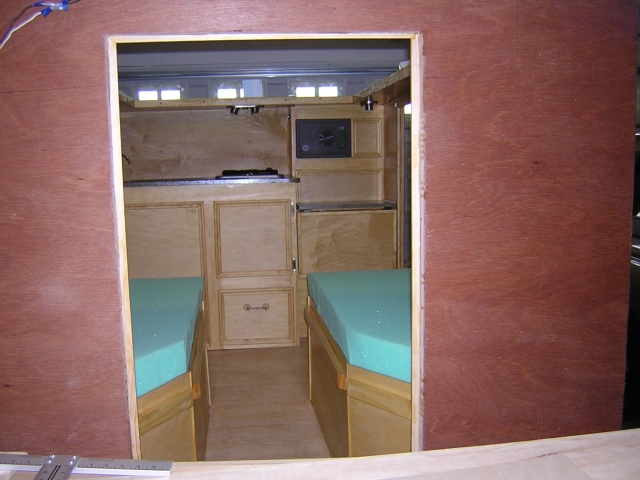

I’m a bit early on my monthly update but I was at a good picture-taking point. I’ve procrastinated on finishing up the electric; but, I came up with an idea for the bench beds so ended up working on them instead. It’s starting to look like a camping trailer!
The bench/bed middle sections are made, too:
It looks like I might need to trim the foam on that middle section just a tad more….Didn’t notice it until I took this pic. But, with an electric meat carving knife, cutting foam really is like cutting a slice of turkey...not a big deal.

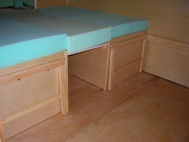

In the above picture, you will notice a couple things. The first is that I have made what look sort of like chair legs for half a chair. Right now, these are just leaning against the ends of the benches because I need to wait to attach them until after the floor covering is in. It will be easier to attach and adjust them to the right height then. These bed legs will be on hinges so that they pull out and support the foot board sections (the lower section of the beds where ones legs and feet will be). The upper portion of each set of bed legs is divided into 6 sections. The ones with bolts in them are made that way so they can be toggled to give middle as well as side bed foot boards support. The pieces that don’t have bolts will be fastened to the bench beds, to support the one end of the bed foot boards. (I hope that makes sense to you.) Those are also just sitting there now as their fit between each toggled piece may need to be adjusted once the hinged bed legs are in place.

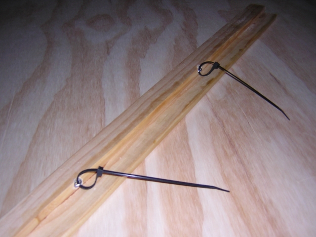

The second thing is that the bed rail that you can see in the above picture, on the one side wall, serves two purposes. Along with supporting the bed foot board, it also provides a hidden runway for the water line that runs from the water tank, inside the bench cabinet, to the sink. (It pained me to cut a hole in that cupboard!) This was pretty easy to do but I have included a picture of the rail’s back side so you can see:

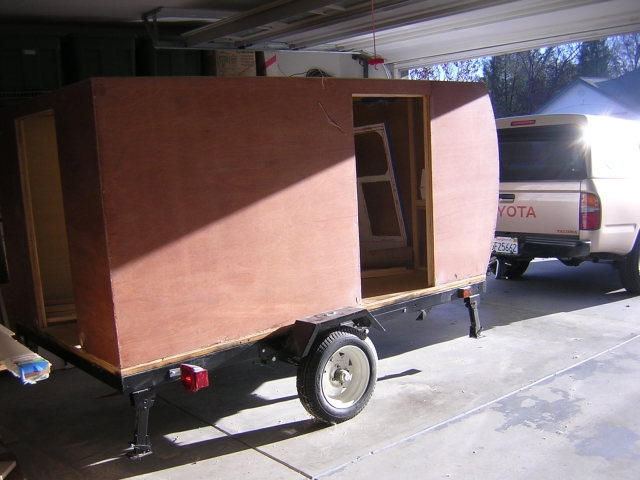

This one's for you, Steve Cox:
It was taken at Christmas, which is when I found out my hitch needs to be replaced...gotta get to that. As you can see, the trailer doesn't get moved much. (There are cobwebs on the wheel!) I didn't have any of the cabinets done then; so, I guess I'm making progress. The poor thing looks kind of ugly now but, by the end of June, it should be looking much better!

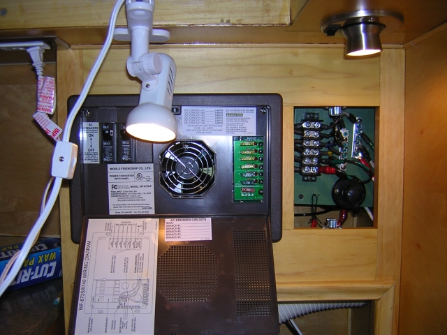

The wiring is in and tested via the WFCO converter. I will test again, after the battery is connected. Below is a picture with the AC and DC both working. Woohoo! :woohoo:
Hey, Tom (Aggie79): Take a look in my album and see if what you need is there. Check out both the picture titles and the comments. I was fairly thorough with my documentation. I will add another picture when I connect the battery.
